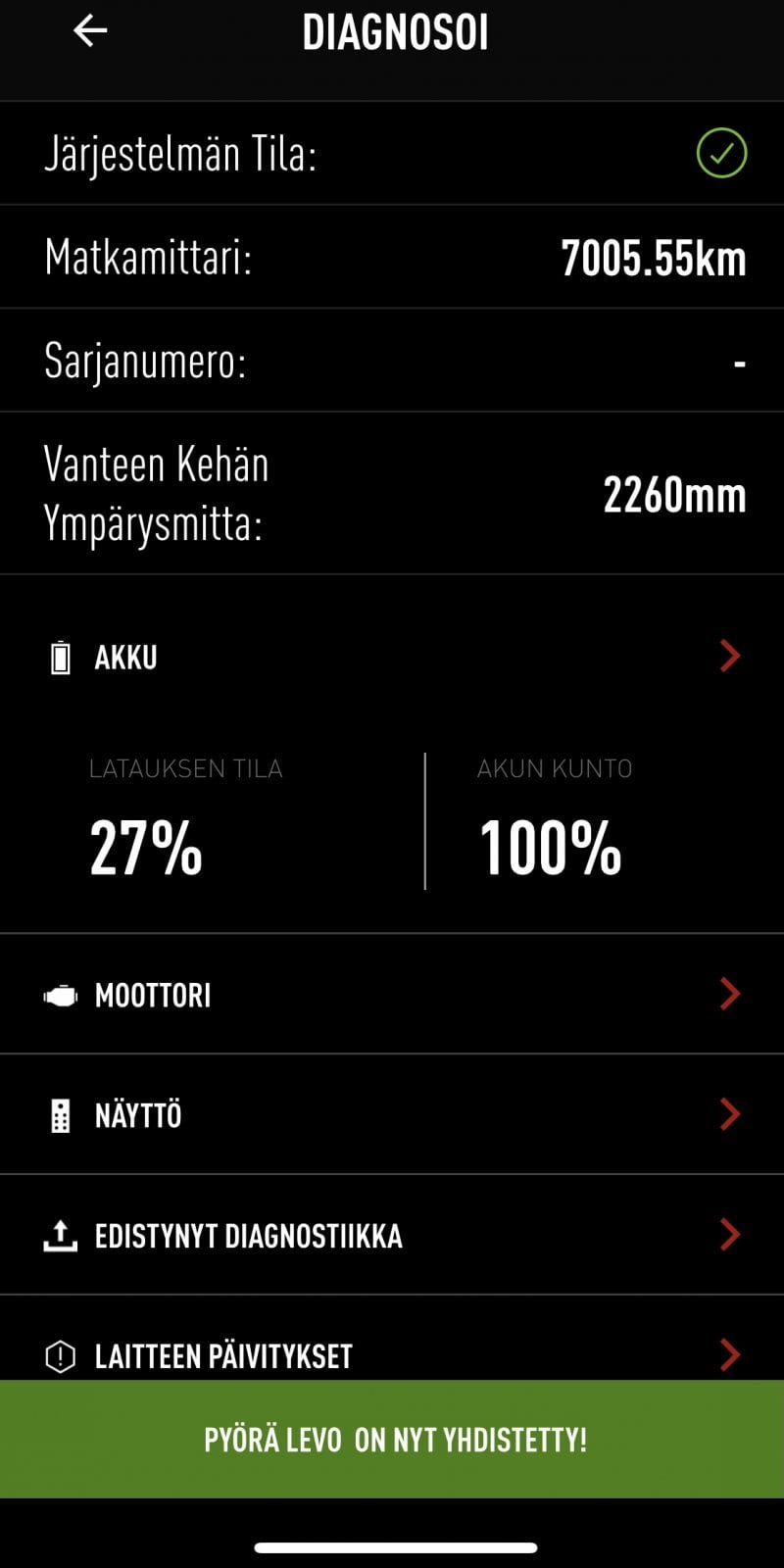

I don't understand these issues that people have with Spesh.
Original motor, nearly 7000km now. No issues.

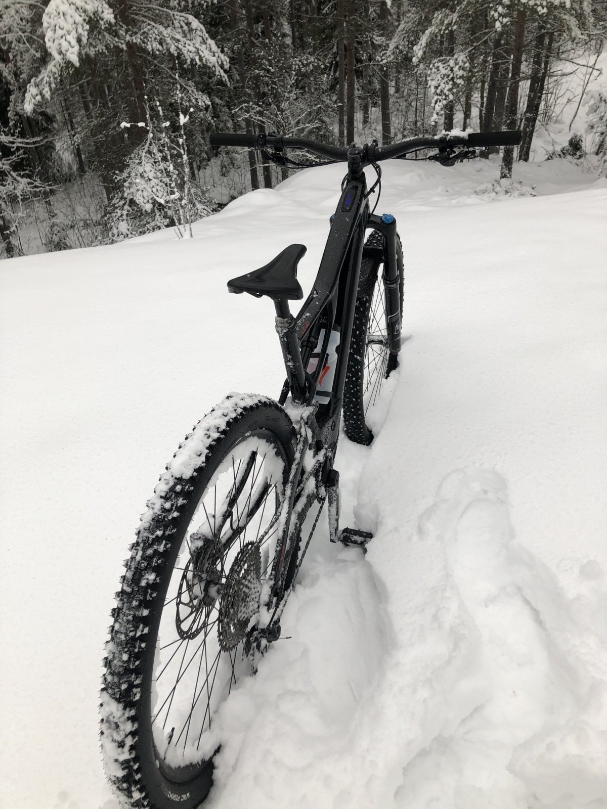

This is my Levo, picture from last January. I have had it two summers and second winter is coming, 2000km`s on it, not a single problem. Ride it hard, every time.
Just love it.
