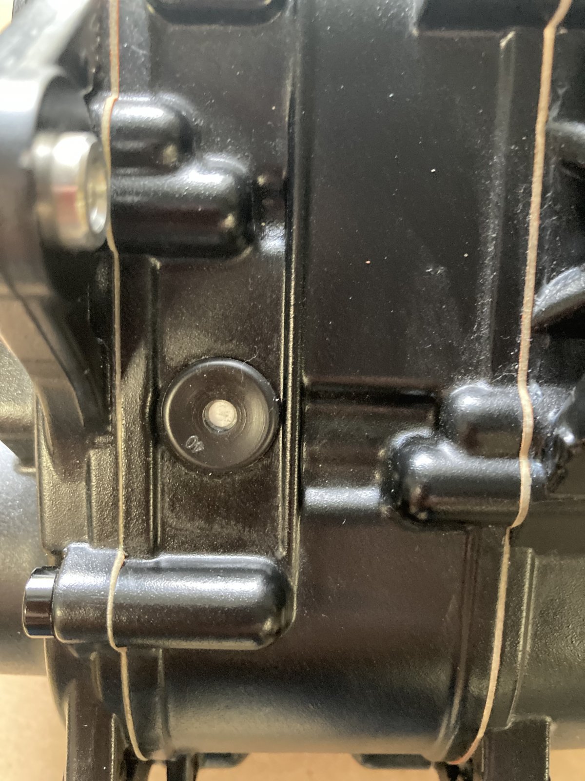

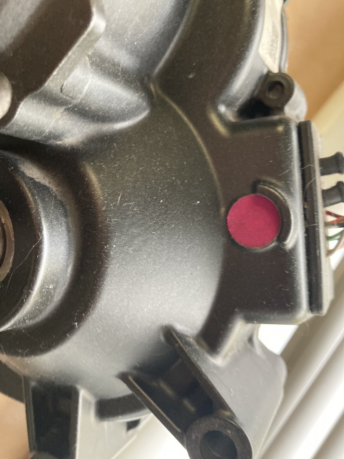

Bearing Man
Ebike Motor Centre
Sep 29, 2018
973
2,322
This is meant to be the case with the levo SL.
It does have a tiny breathable hole as seen in the pic below. The purple membrane is that of a Yamaha motor. These are the only two motors I know of with this adaptation.
