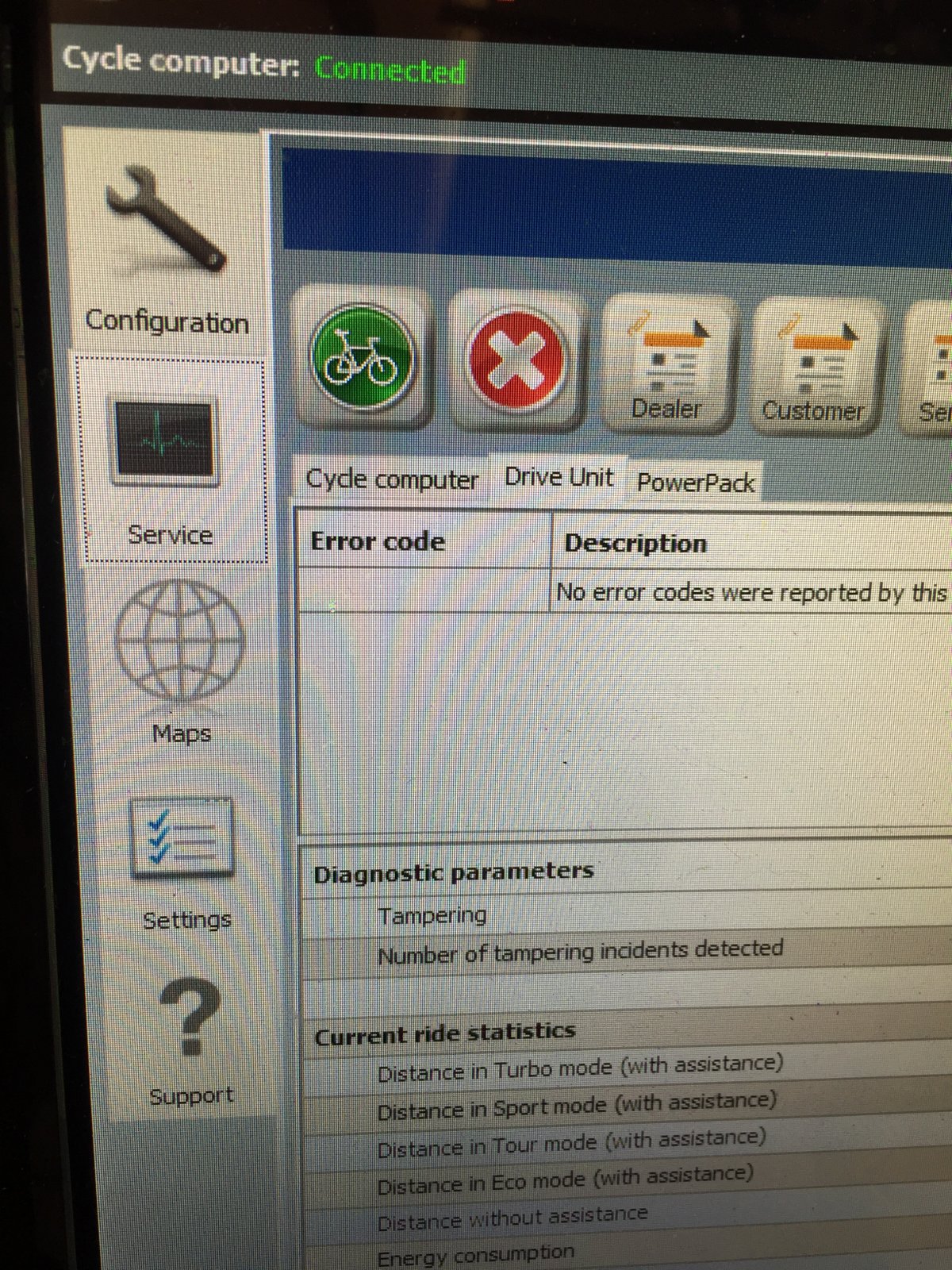

Actually, I run a bike shop that sells a lot of Emtbs and I perform all of the service. I am a Bosch certified factory technician with all of the Bosch specific tools and diagnostic software.
When I was being trained at Bosch, they told me about the EU regulations while I was being trained. I was also taught the proper protocol to follow if I encounter a motor that has been tampered with. I have never encountered one in person outside of the Bosch service facility where they used one for an example.
I will post a picture when I am back in my workshop tomorrow morning, even though I shouldn’t have to, since you are offering no evidence to the contrary.
I only used the Levo example to explain that’s not just Bosch that has tampering detection. Sorry if you took offense, but that is really no concern of mine, now is it?
But if you like, you could always hit the ignore button on my profile and continue to make irresponsible speculations you have no evidence to support.
I will never understand the mentality that feels entitled to a warranty after it’s terms have been violated and it’s somehow justified for the manufacturer and dealer to endure the costs.
Have I used a cheat app on my Ebike? Yes
Have I used a cheat device on my Ebike? Yes
But when the motor finally shit the bed, I accepted my accountability and never tried make someone else pay for a replacement.
I suspect derestriction won’t be an issue much longer. With the federal government allowing Class 1,2 and 3 Ebikes to be used on all federal land, the manufacturers will be able to update Ebikes to travel at 28mph instead of 20mph. It will be almost double what it is Europe
Cool let's see the picture - or it doesn't exist. The evidence I present is no posts of a bosch customer being denied warranty due to deristicting. Additionally - let's hope tampering means de restricting and not opening the motor case.

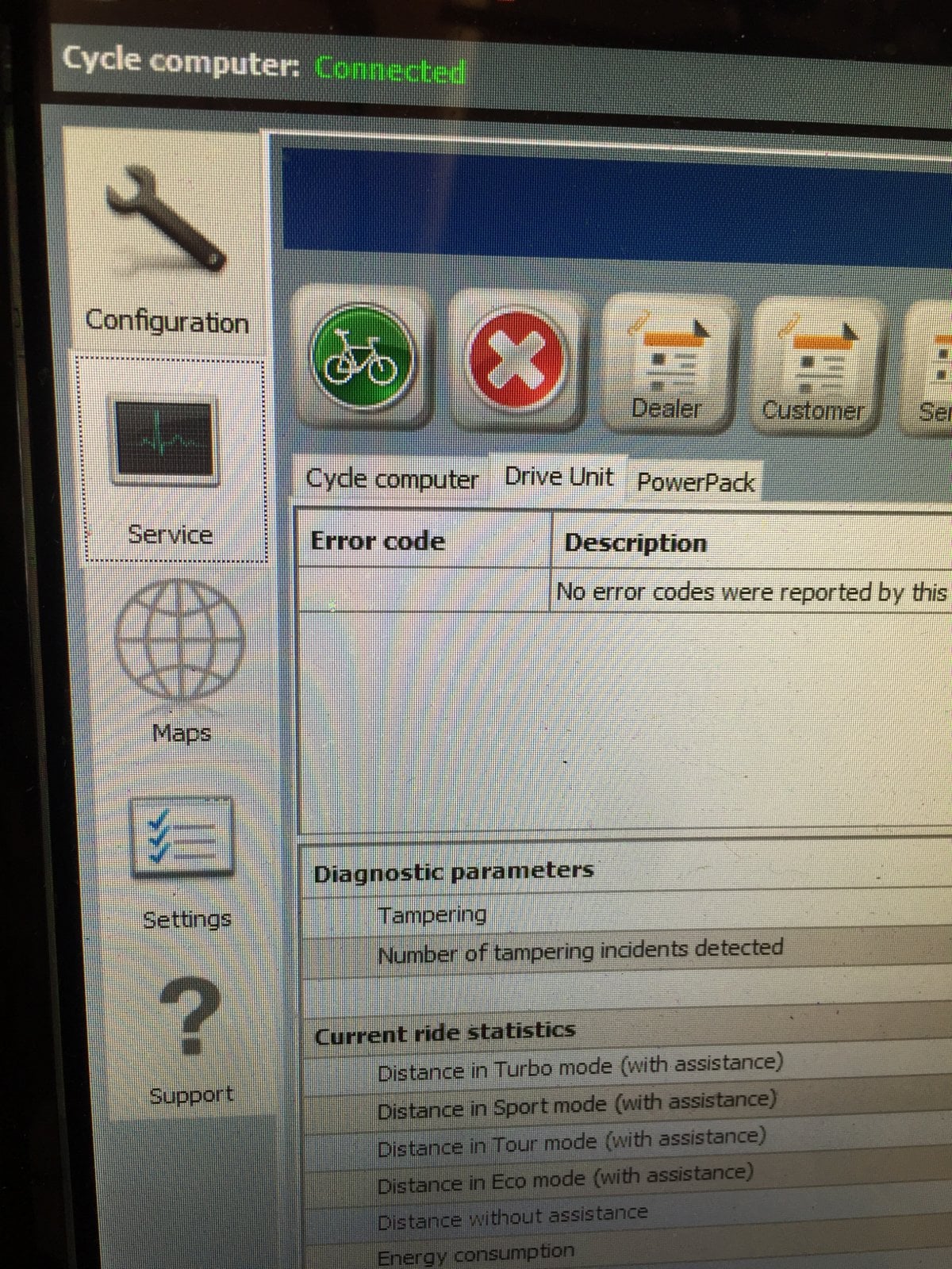

Here it is
Marke
Jun 17, 2018
115
72
West Yorkshire
Thanks very much for taking the time to do that very interesting. I appreciate it.
Next question is what is tampering and how is it detected. I know if you open the motor up it invalidates your warranty - is this tampering? Or is bosch capable of detecting chipping? The lack of actuall warranty work being denied would suggest the former - but I don't know. Thanks again.
Al Boneta
Dark Rider
Jan 18, 2018
1,351
2,603
California
You are welcome.
All I am doing by providing this information is trying to educate.
Ultimately I don’t want to see anyone lose out on getting their bikes warranty.
These bikes are super expensive.
It can detect chipping and can also detect sensor and magnet manipulation.
If you open the motor the software will not detect it, but there is a sticker that will change color when exposed to light that is inside the motor.
