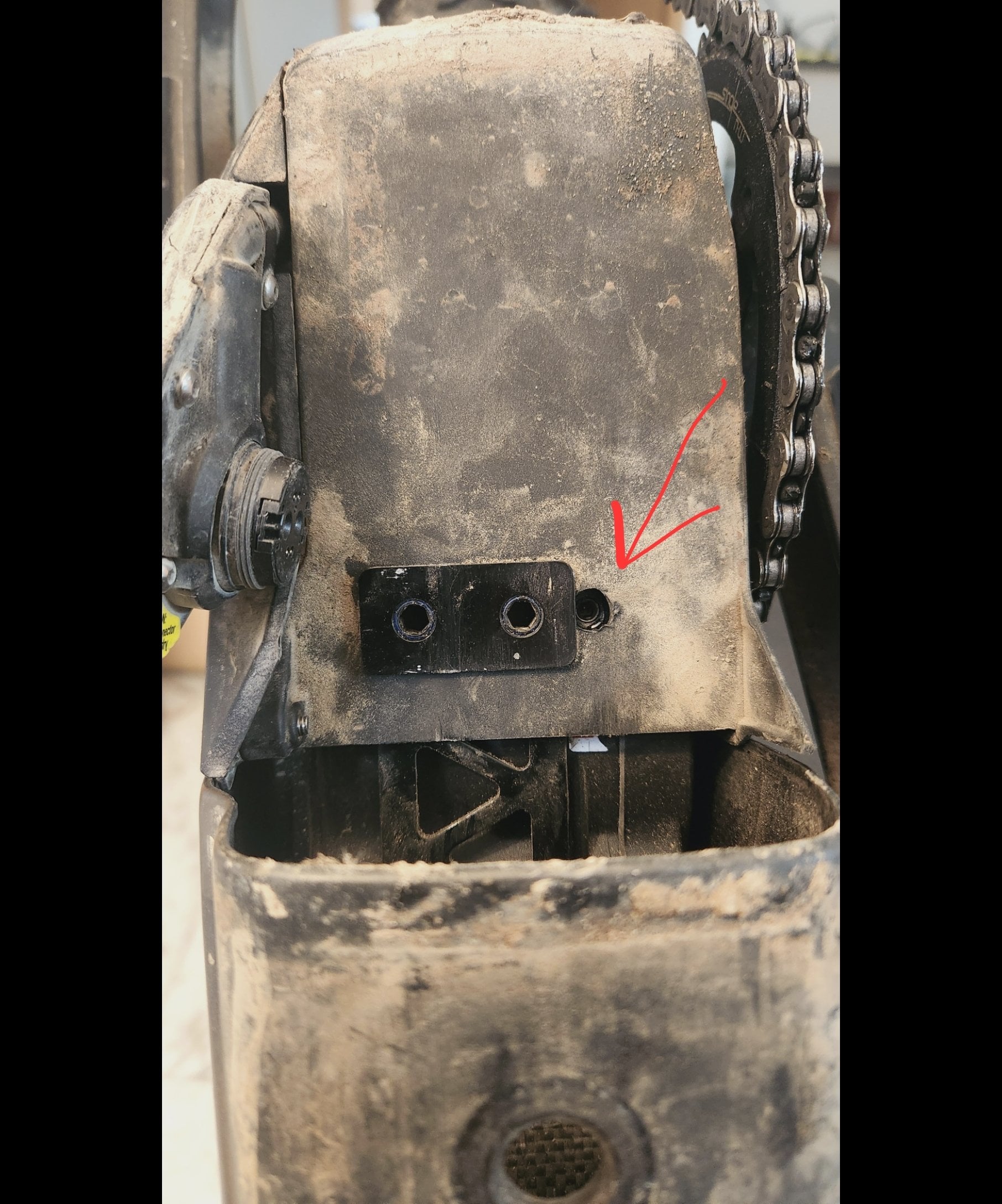

Hi,
my motor became very,very noise at higher temps.
it's a gen2, the 2nd motor, 13Tkm, belt replacement after 12Tkm.
I opened the motor and found the bigger wheel tilts (see video). so it seems there is something wrong with the bearing inside. I cannot open the inner part as it requires special tools.
it's already out of warranty, so I see no other chance or let my say after 13Tkm I don't want to invest more on the old motor, so I bought a new one 2.2 version built in April'24...let's see.
there is one more thing I figured out...the belt might become "loose", means there is a screw with 0.2Nm of torque, but after while it might be that this screw needs to be adjusted again, but it's difficult as it's secured by locktide (and covered by a label). if someone wants to try, you can find it here...see picture
