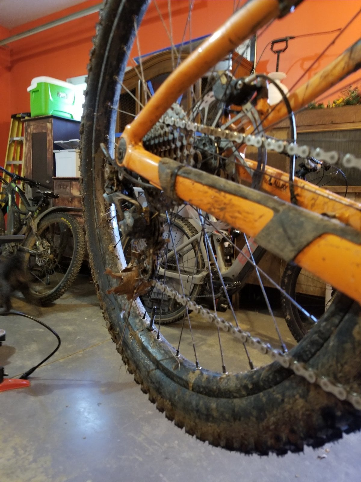

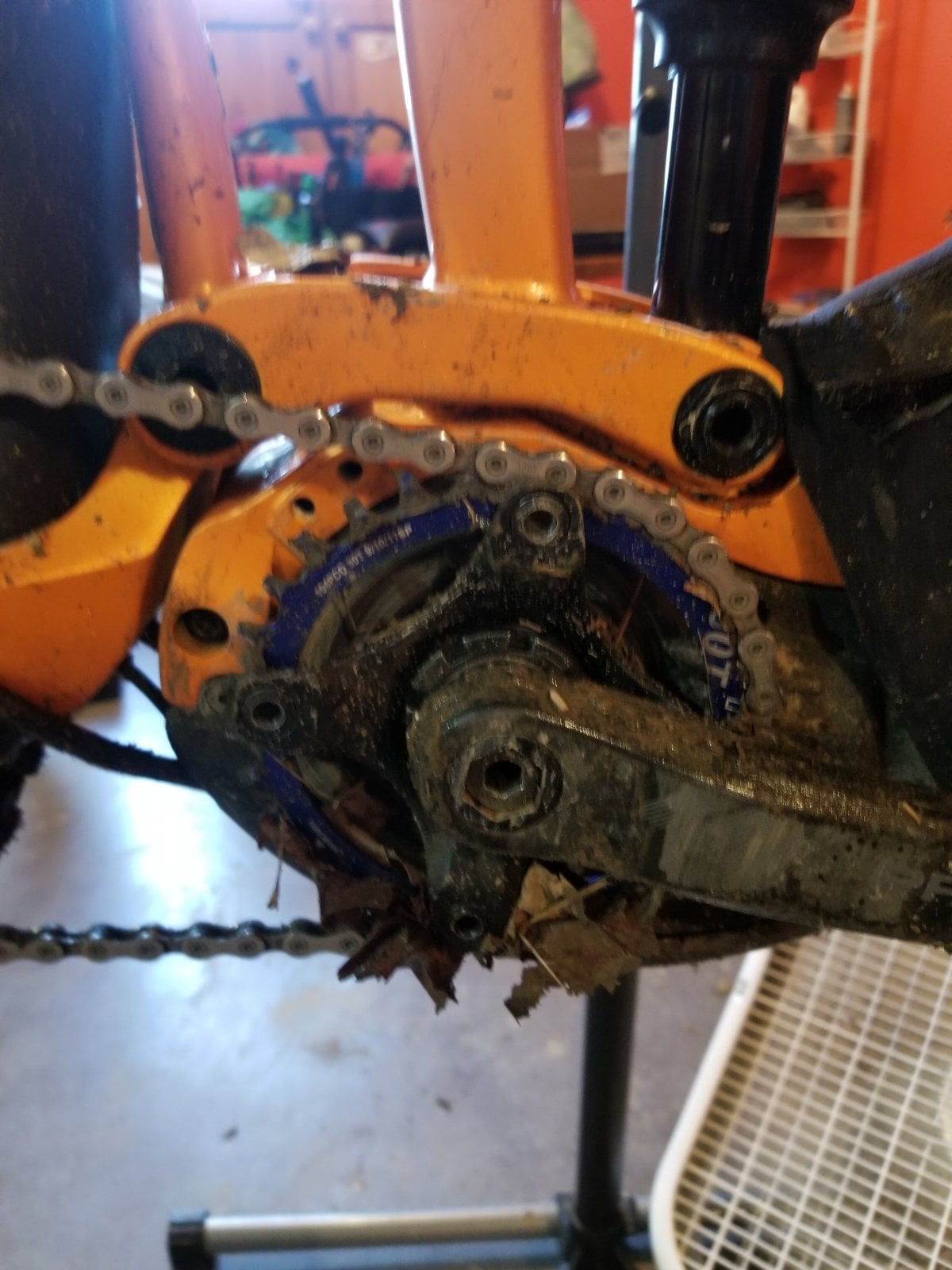

My 1x10 gets put through hell every ride lately and just keeps going with no need for adjustments. This mess was after 2 days of no rain to.... dry out things a bit.
It's been like this every ride for the last month or so.
Using the medium range cassette 11-36 means chains and cassettes are cheap, even the good ones.
The zee FR derailleur is so far the only derailleur to last more than a dozen rides without needing something.
How long before it wears out... I dont know. But I can say, In my short experience, 10 speeds like what I'm using now are less prone to break and require less TLC.

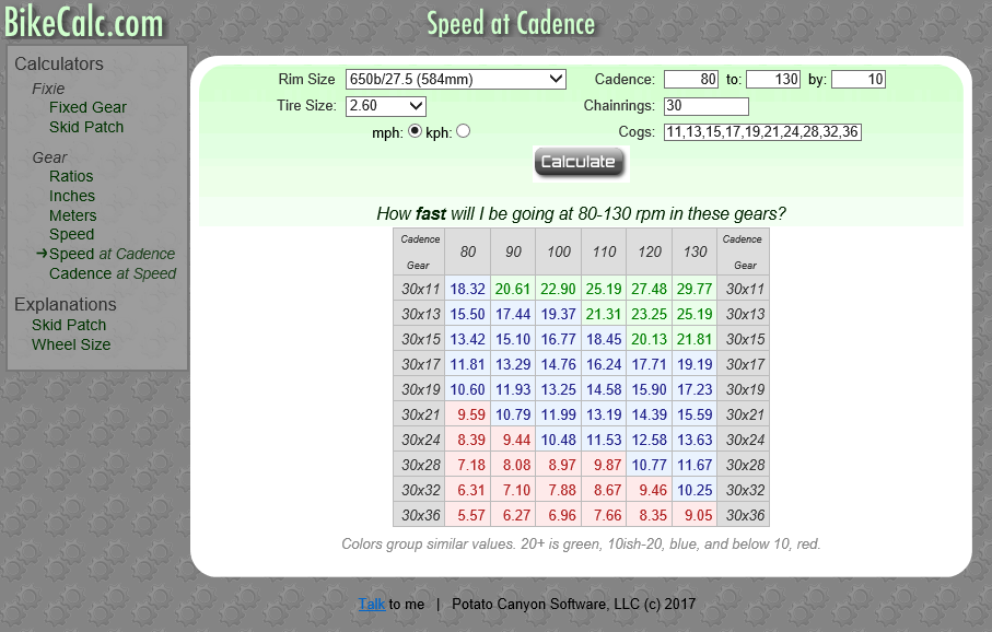

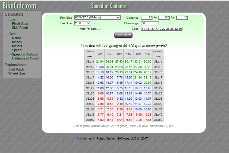

Here was the stock gearing. I found that I seldom used the largest cog even on super steep stuff.
And here it is now. My new first gear is lower than the original second gear. So yeah it climbs good, at the expense of top speed. But, in tenth gear, peddling at 100 RPM, I'm just clipping the assist.
You can use this web calculator to display the setup however you like, for me the speed at cadence is good enough.
