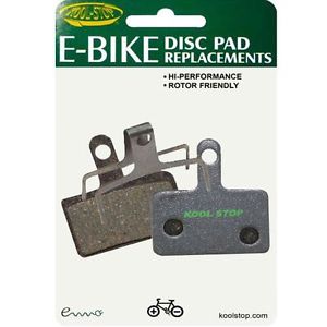

Just look for brake pads with “ebike”, in the the packaging or marketing. You will then know they are tougher for ebike use ?
I’m really sick of seeing things marketed this way when they are just the same as something that is already available.
I call BS
I call BS
That might be true but given we have a motor, shouldn't we be able to get parts truly aimed at bikes which prioritise durability over weight?
