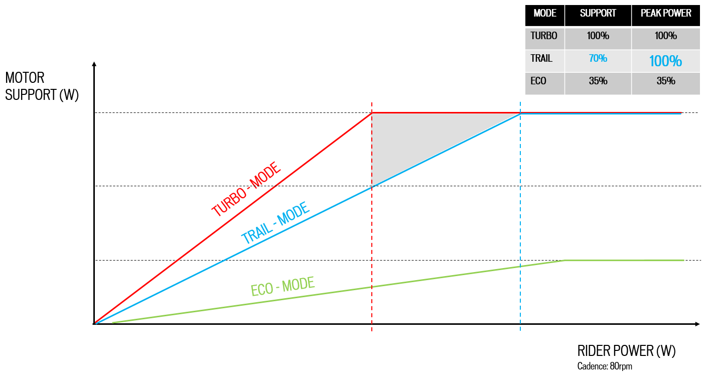

B) Infinite tune settings with battery firmware X.23.0 or higher
  • For each mode, the support and peak power can be set as desired
  • Here: Trail 70% with 100% peak performance
  • Conclusion: With more power on the pedals, the rider in Trail can achieve the same engine assistance as in the turbo

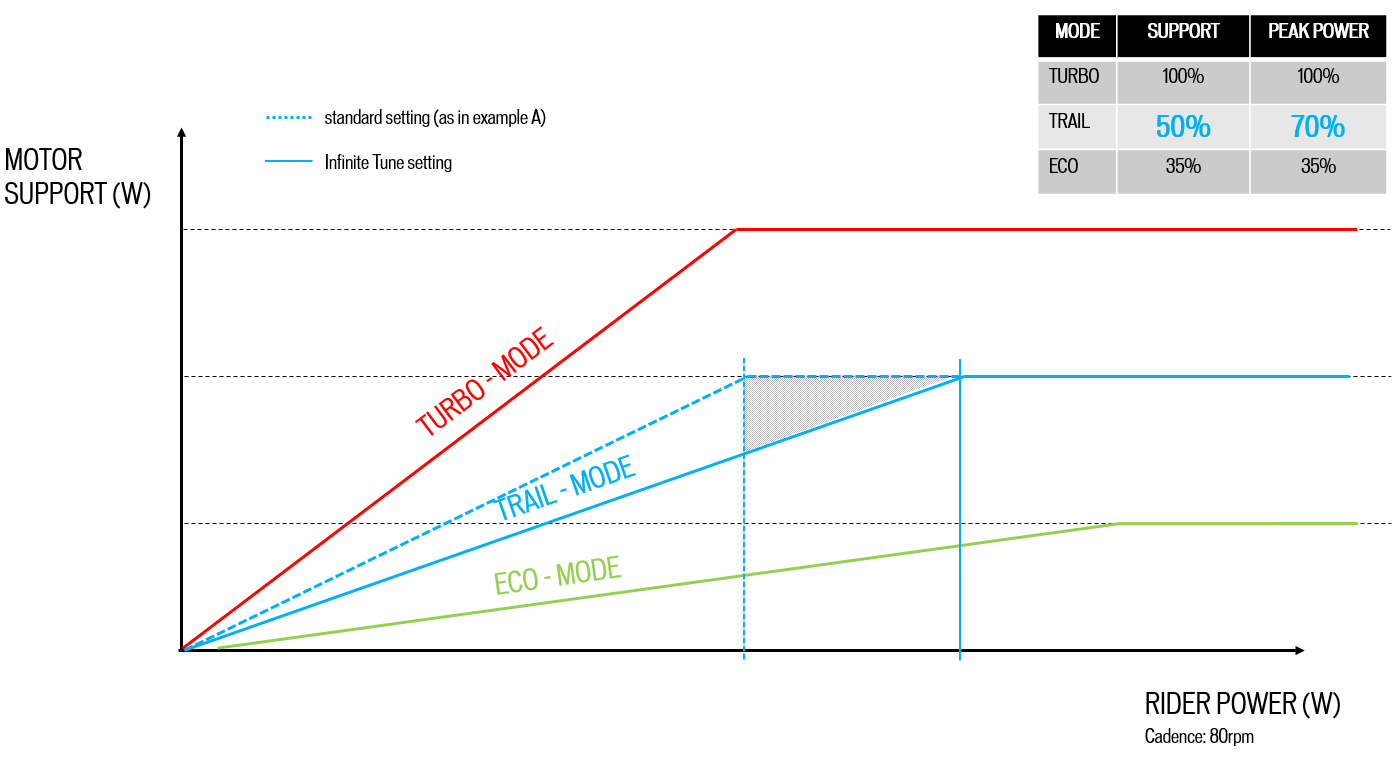

C) Infinite tune settings with battery firmware X.23.0 or higher
  • Here: Trail 50% with 70% peak performance
  • Conclusion: The rider can get the same motor power as the standard setting, but has to put more watts into the pedals
