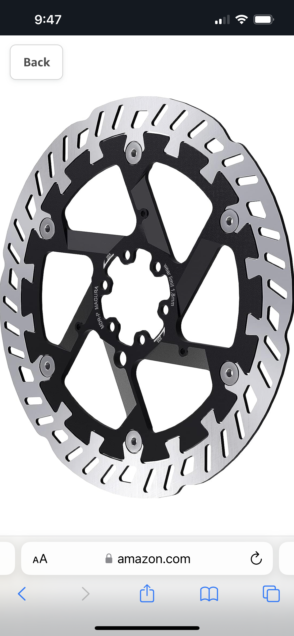

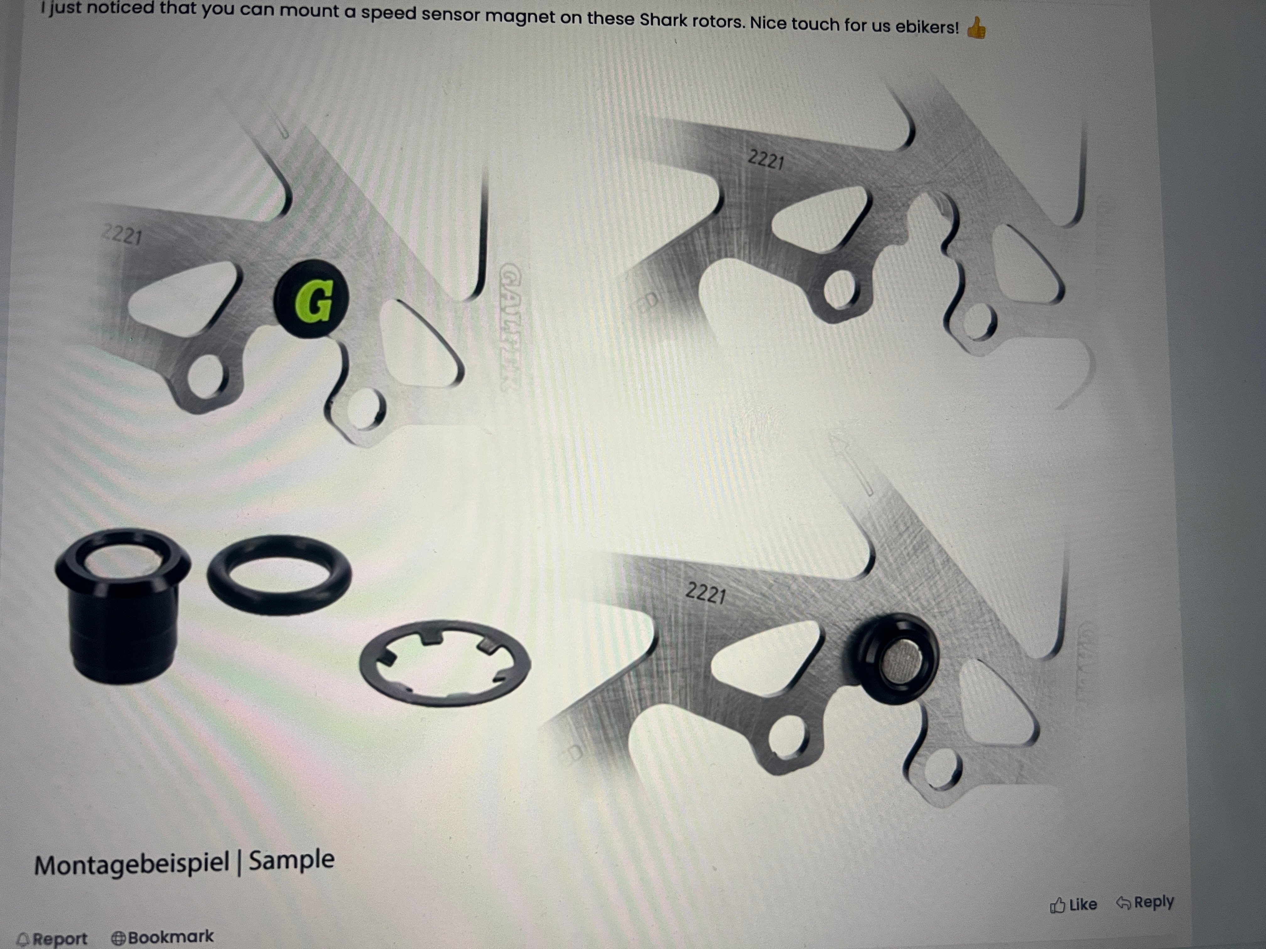

Magura rotors also have the magnet mounting hole, which I wanted to use but my swing arm didn’t allow room for a reed switch to get close enough to the rotor magnet

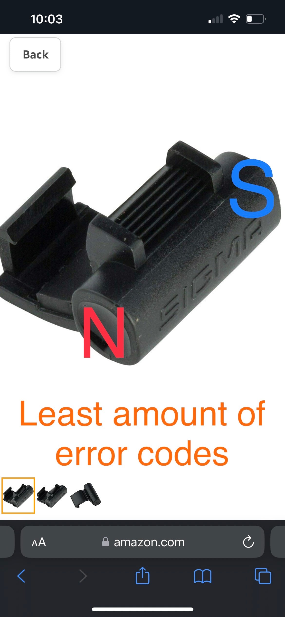

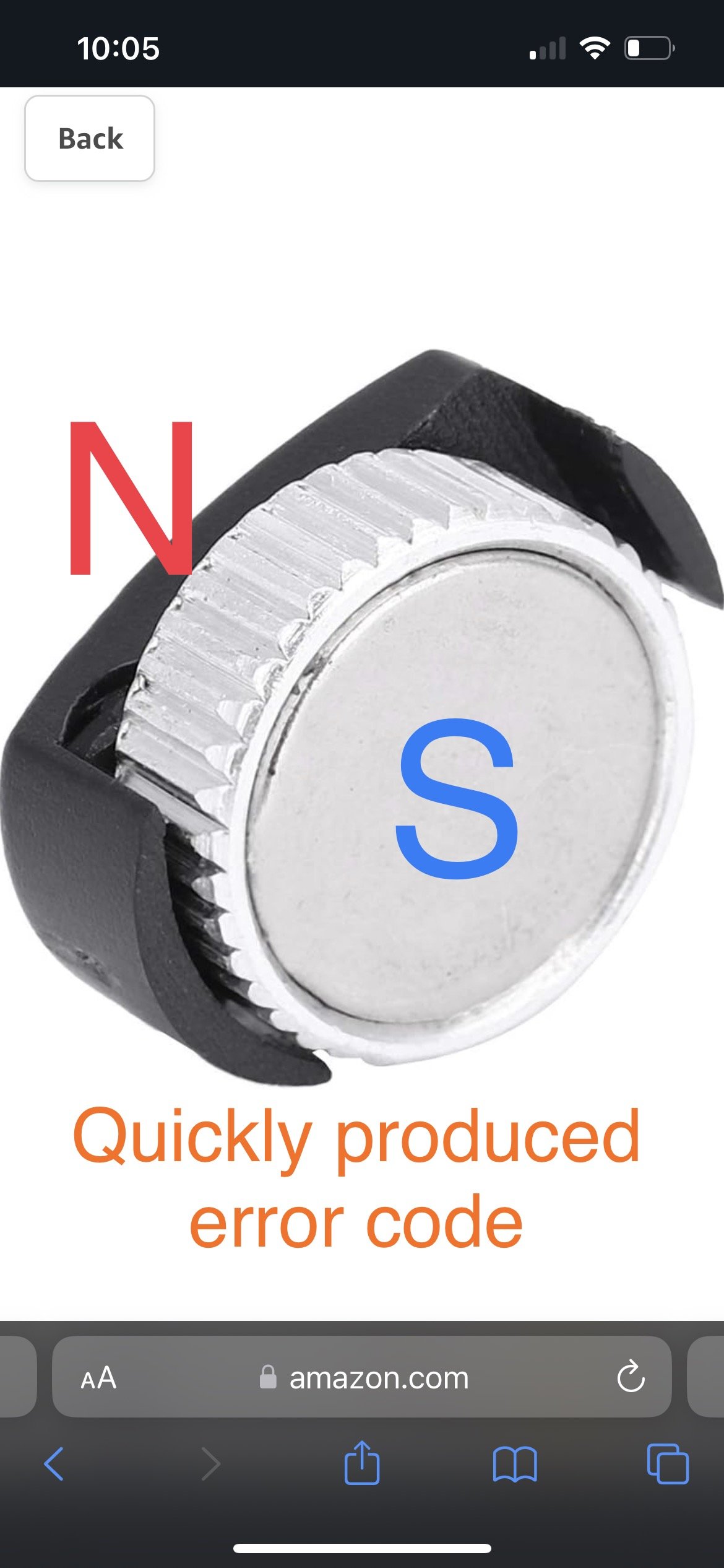

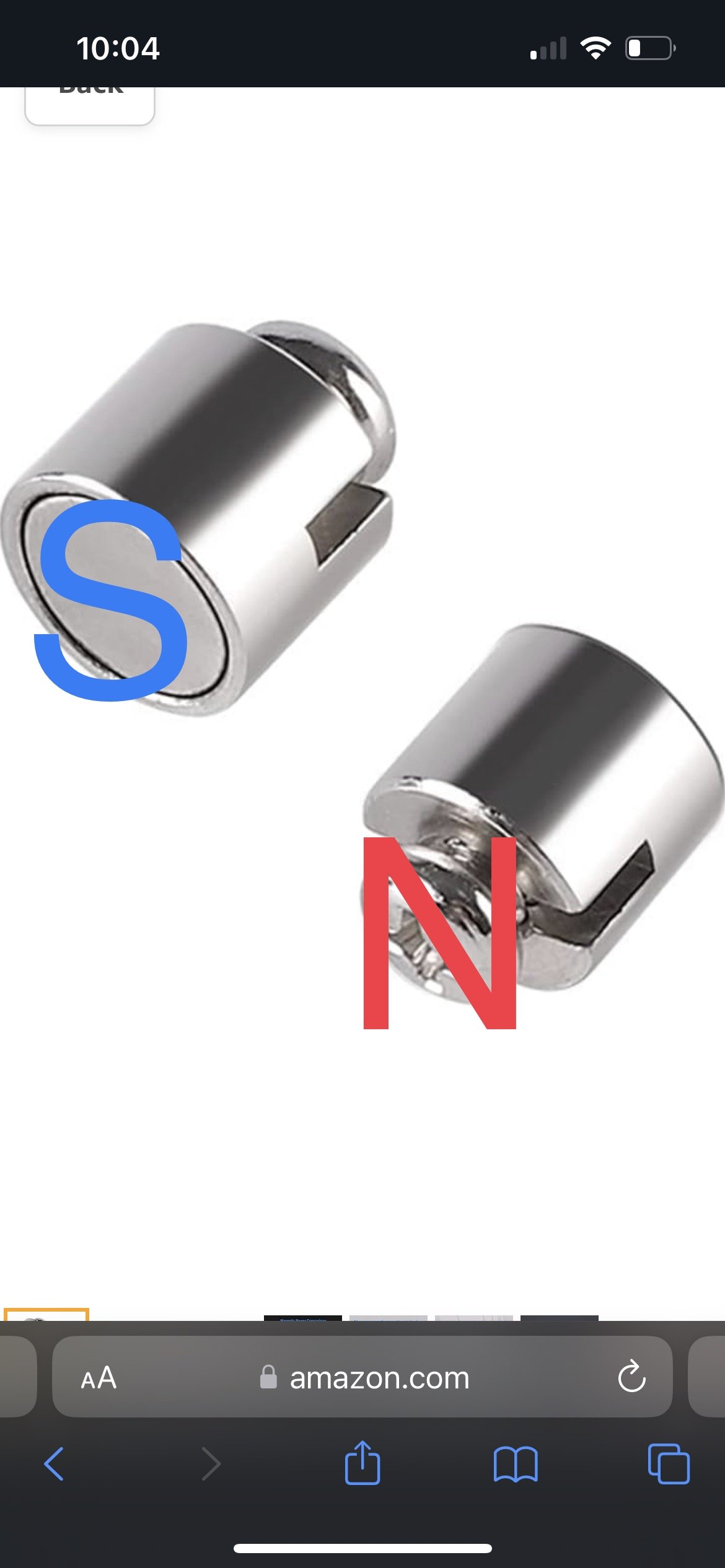

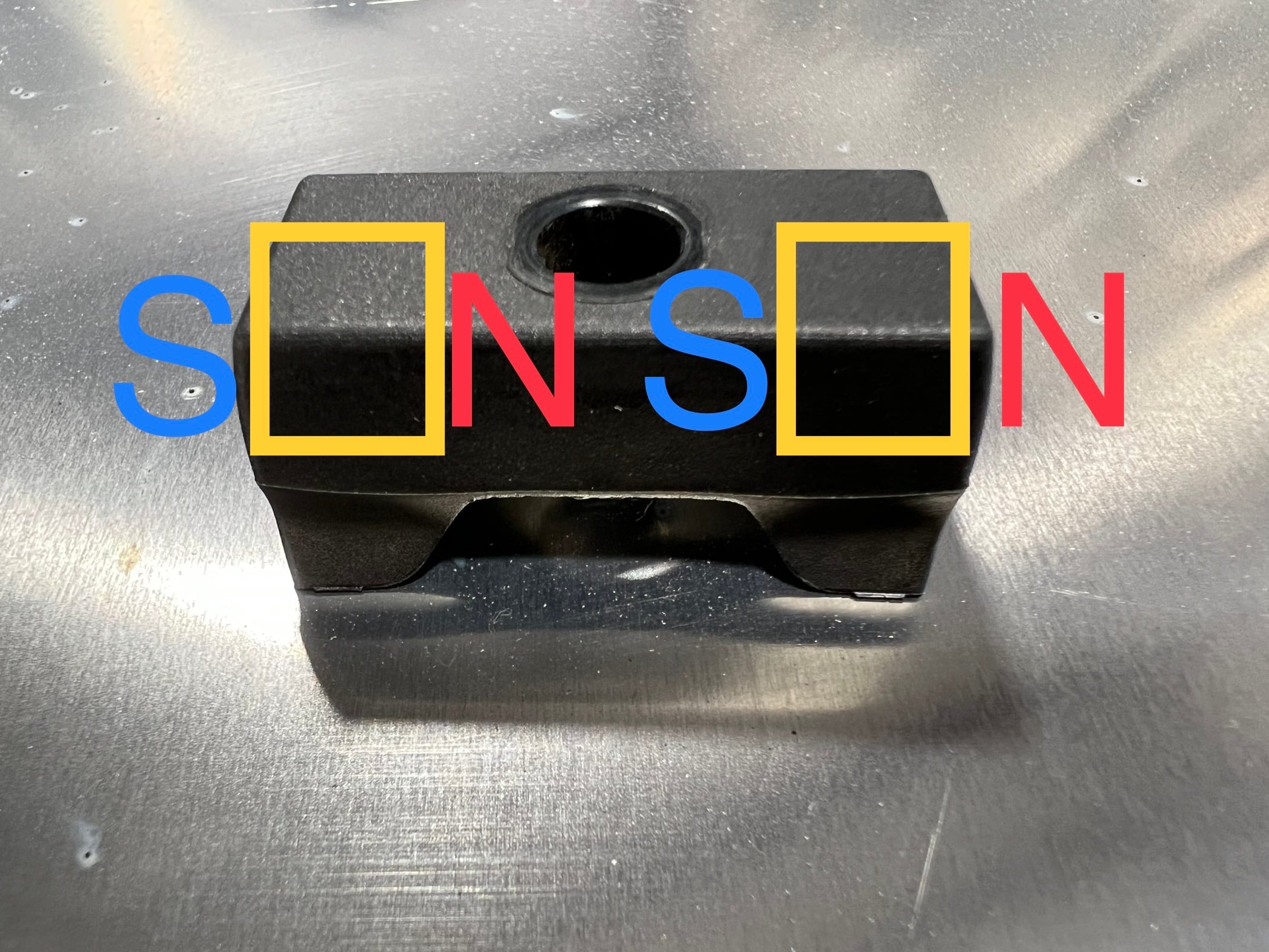

I believe the Bosch Rim/valve magnet is made up of TWO magnets, one on each side of the valve hole. I’m finding two S poles and two N poles. See my picture showing the yellow as each magnet inside the plastic shell and the location of the S and N poles.
I also attached pictures of the aftermarket spoke magnets offered.

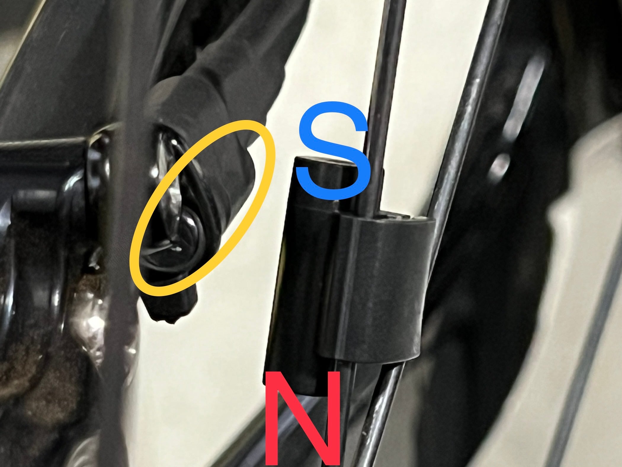

This picture shows the yellow circled reed switch position and how the spoke magnet S & N pole passes by it. The reed switch is in between the poles.
I have now spun the rear wheel by hand(not pedals) many times while watching the speed display, I’ve done this with my other style spoke magnets as well. Moving their placement and even rotating the magnet on the spoke to aim the S & N poles in different directions. Every scenario works, creating a smooth speed. I’m able to keep a consistent speed shown on the display and increase or decreasing the speed smoothly. The only time the speed has a drastic jump is when I spin the wheel really fast; it’ll jump up to 14-16mph then drop drastically to 8-10mph(I’m told this is the Megabobra engaging, reducing the visible speed). It will also do this when the speed is gradually slowing down to around 4mph, it will then drop drastically to around 2mph then instantly spike back up to around 5mph then gradually come down to zero as the wheel slowly comes to a stop. (I’m told this is also normal as the Megabobra is “shutting off” to allow the visible speed to catch up to the actual speed)
Keep in mind this current testing is being done with the bike held off the ground in a stand with me rotating the wheel by hand(not pedals)

Went on another 22mile ride. I tried the small round spoke magnet with no luck, it triggered the same error code within a few minutes of the ride. I moved its position a bit and it triggered the same error code again right away. I reinstalled the black plastic covered cylindrical magnet that I used on my first ride with the Megabobra installed and it seems to work the best, but I still eventually get the same 523003 error code, sometimes followed by a 523001 error code. At times I am able ride 10, 15, even close to 20miles with this magnet, error free.
I’m curious if anyone has had success with the Megabobra with the programmed 1.6 / 32mph limit?? At this point I’m wondering if the Megabobra engagement and disengagement with the programmed 32mph limit setting is to much speed fluctuation and causing these sporadic error codes when using the cylindrical black plastic covered magnet?
On this ride my max speed was 32.6mph but if lowering the Megabobra max speed to 30 or even 28mph would eleminate the error codes I’d be ok with it!

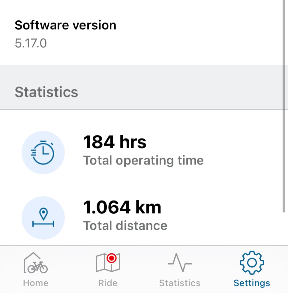

On a side note, I finally passed 1000km on my megabobra over the weekend. FYI my multiplier is set to 1.4. I'm the first to admit that it's tricky to get it setup and working reliably; it's certainly not as straight forward as those without the rim magnet setup.
View attachment 128042 View attachment 128043
If that is the case, the magnet could not be strong enough when passing very fast against the reedswitch, not able to close…
Try to stack another coin magnet on top of one other…

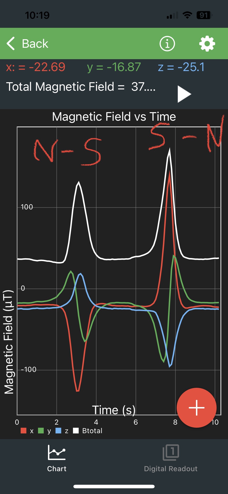

Here the “signature” of a perpendicular vs // passing by magnet.
So the ring magnet is just a strong long N-S magnet, consisting of 2 separate n-s
N-S||•||N-S
I am quite sure that the hall sensor in the Bosch motor is only picking up the total (xyz) magnetic field, just because of not knowing if the rim magnet n-s or s-n placing!
In green the different signature by passing the magnet n-s or s-n (see the symmetry)
So, generating just the white (positive) pulse will be enough.

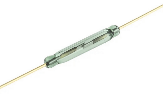

The magnet that works the best so far, I’ve moved in different positions while on a ride. The only thing I haven’t done is rotating the reed switch to a different position facing the magnet.
megabobra
Jul 24, 2022
271
272
Definitely give this a try. If the contacts in the reed switch are not facing the magnet they'll be pulled in the wrong direction as the magnet passes, ie not towards each other.
If you're 90deg out of alignment (worst case) the switch can behave erratically.
