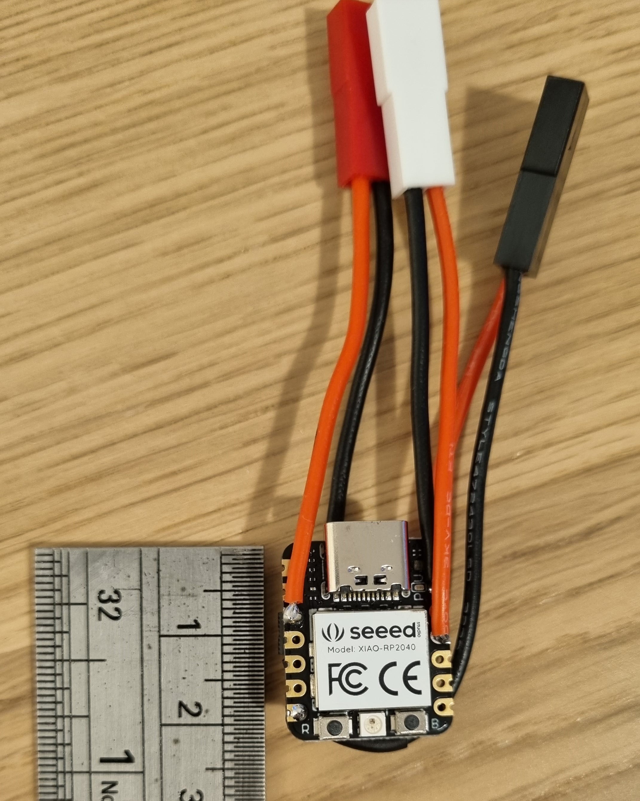

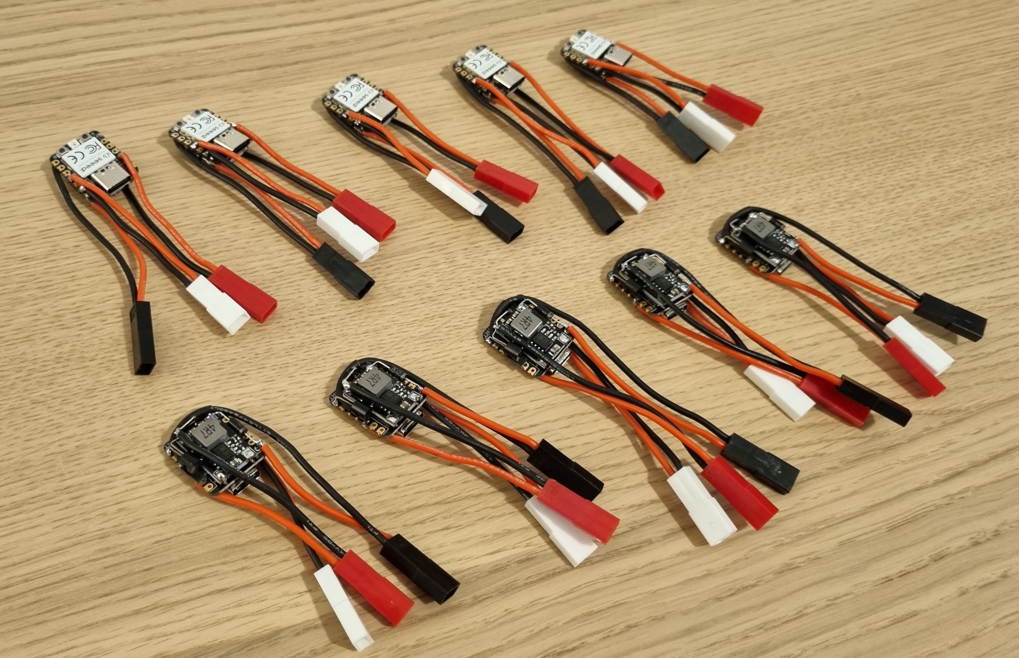

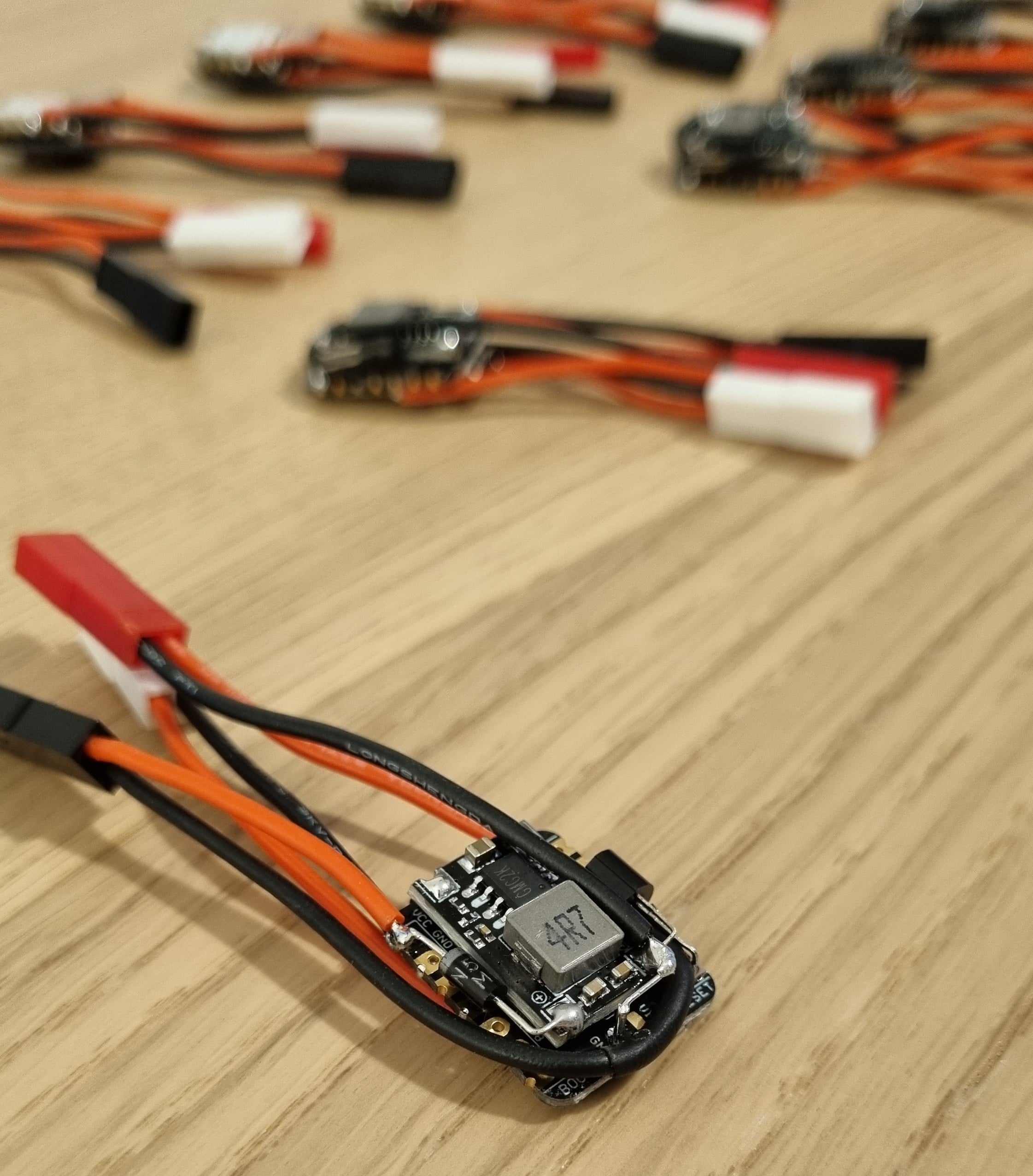

Finally, most of the components turned up for the first batch of Megabobras. Still waiting on the Bosch LPP cables, but the remaining parts are assembled and are waiting to drop the cables in.
There have been a few upgrades since the original tutorial. These models all now run on the RP2040 boards; more than 10x faster clock speed and less than half the size than the original Arduino Nanos. These devices now also feature the Setup mode jumper cable to assist with electromagnet placement.
Once the Bosch LPP cables are installed, these will be sealed up in heatshrink end caps. I'm finalising a manual to assist with setup and operation - this will be ready by the time the cables arrive.

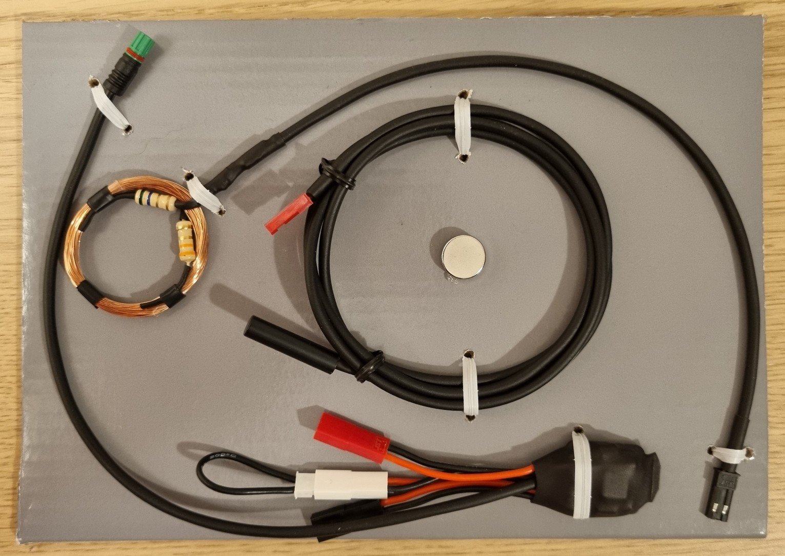

I've spent some time sourcing components that would be needed for this project and worked out some costing.
This would comprise all necessary components to install the Megabobra to replace the rim magnet, including the genuine Bosch LPP cable to plug into the motor:
  • Arduino loaded with Megabobra code and additional electronic components soldered in place
    • Covered with double-wall heat shrink for protection
  • Waterproof reed switch
  • Hand wound electromagnet coil
  • All wiring in place and secured
  • Light weight plugs between components to assist with install
  • Bosch LPP cable
  • Magnet for disc rotor
  • Some strips of double-sided tape for reed switch and coil
  • Short install guide to assist with connection/placement/troubleshooting
Total cost per device would be 99USD/80GBP/90EUR or equivalent in your favourite currency. This include shipping worldwide. Payment by Paypal.
Now to manage expectations, this isn't a commercial product. The finish isn't going to be as nice as you might get in a product off the shelf simply because I don't have access to the customisation that large scale affords. For example, where the big companies might have a reed switch with custom-length cable for the perfect fit, I'll instead need to extend that cable myself to make it work. However, all builds would be carefully assembled and tested prior to going out, and I'd be happy to replace any that are not working.
The idea with this is that you unpack the device, feed the reed switch through the frame, position the coil, plug in the LPP and get going ASAP - probably an hour's install on the first run giving it's pretty tight around the motor on some frames?

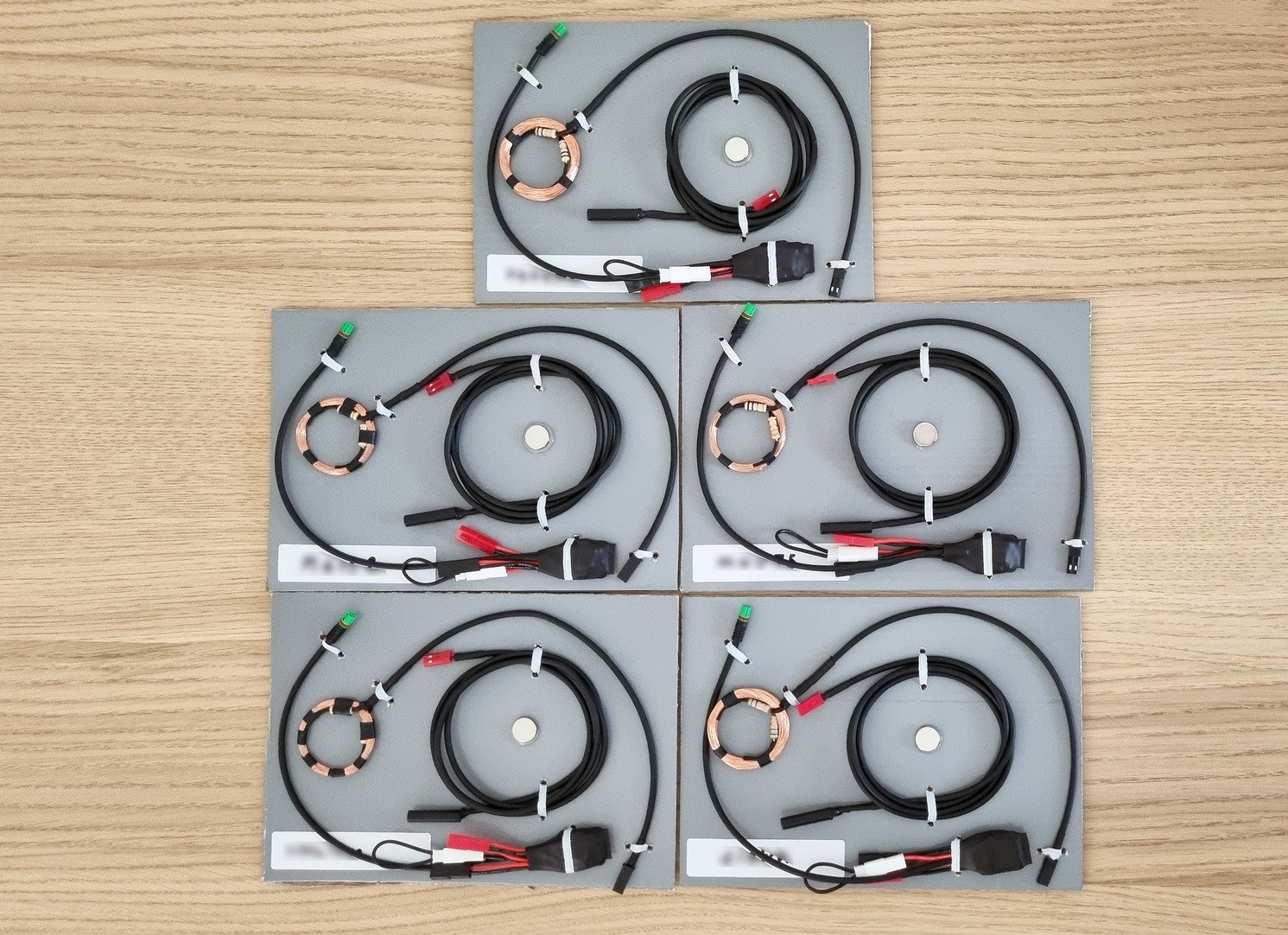

Alright guys, Bosch cables turned up - now things can get going! I'll get messages out this evening. Photo below of a completed device mounted to its shipping board, along with the front cover of the user guide.
