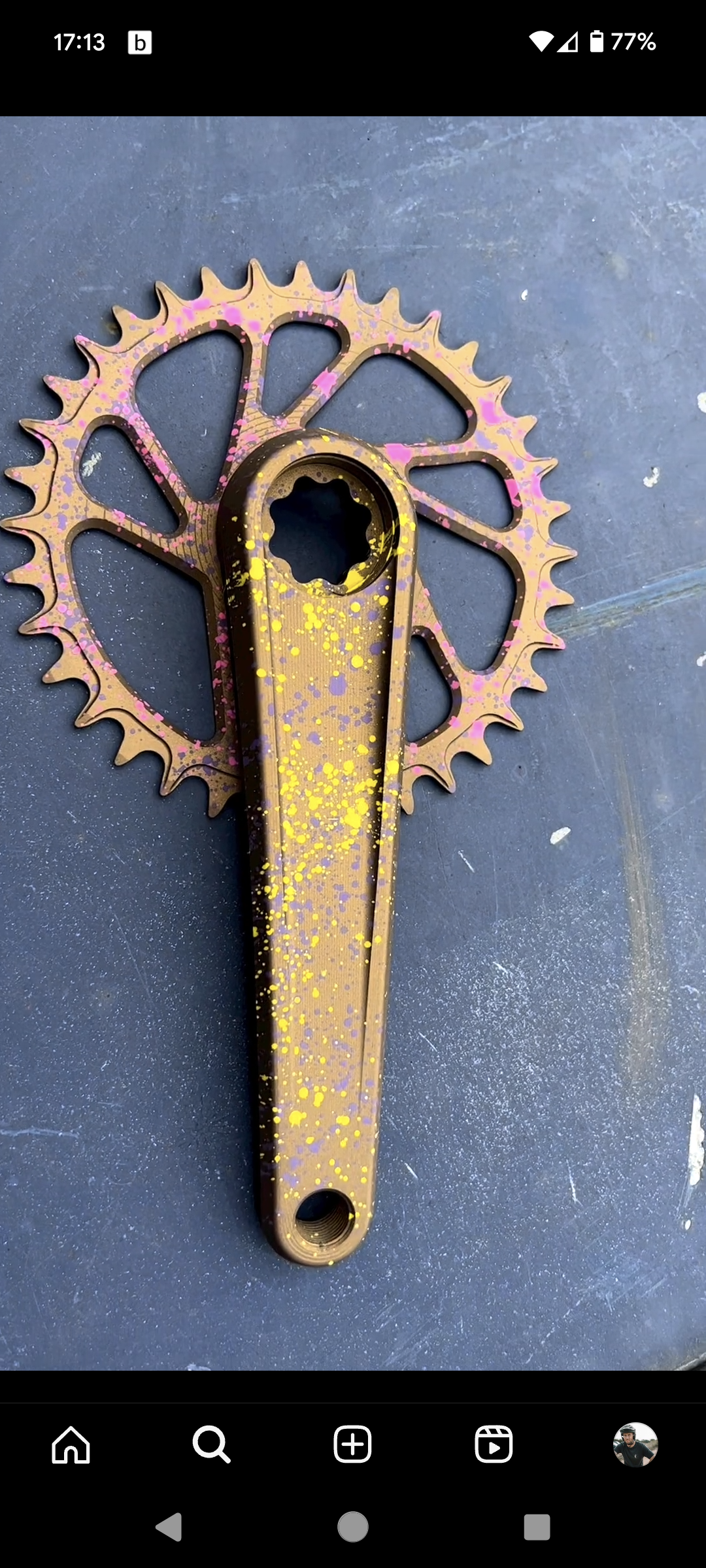

Wonder if these will fit? Unite co cranks
