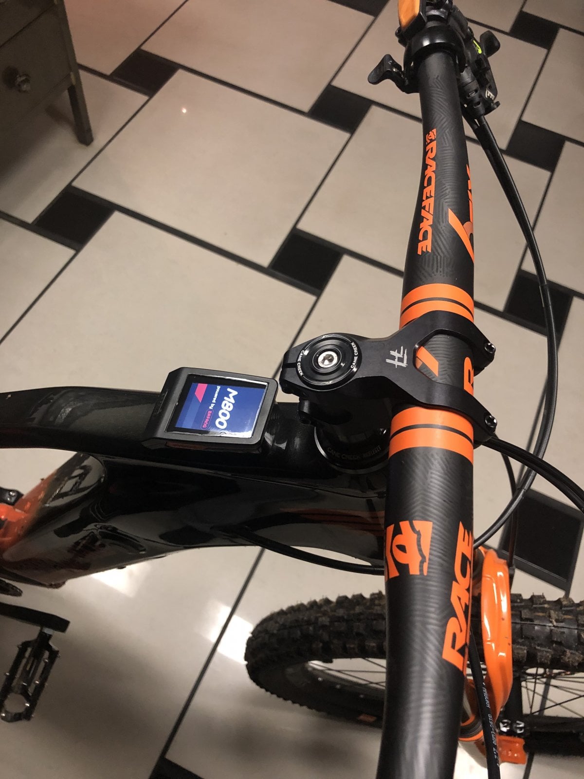

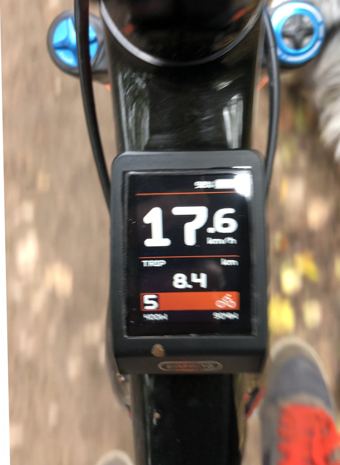

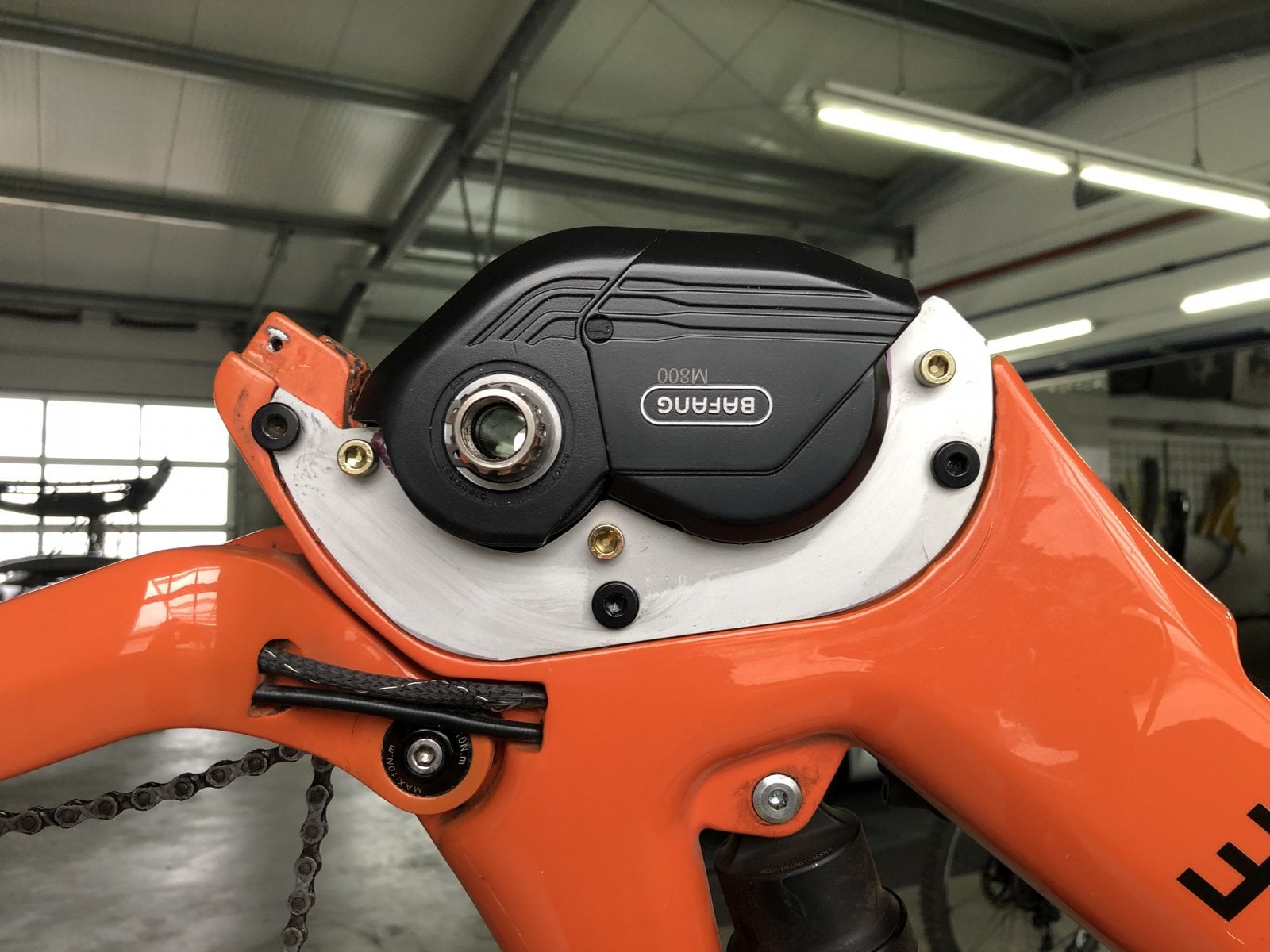

I built the bike especially so that i could go out with my buddies without an e-bike, it just makes up for my lack of fitness so that i can keep up with the boys ?The M800 is very quiet so that you do not disturb anyone in the group.The range with the small 280 Wh battery is around 60 km, and by increasing the voltage to 46.2 volts, the output increases to almost 400 watts :)

M800 with 280W battery is probably similar to the Levo SL where you need to do some pedaling. Are you able to pack more battery into the frame? Boost mode should be pretty speedy!

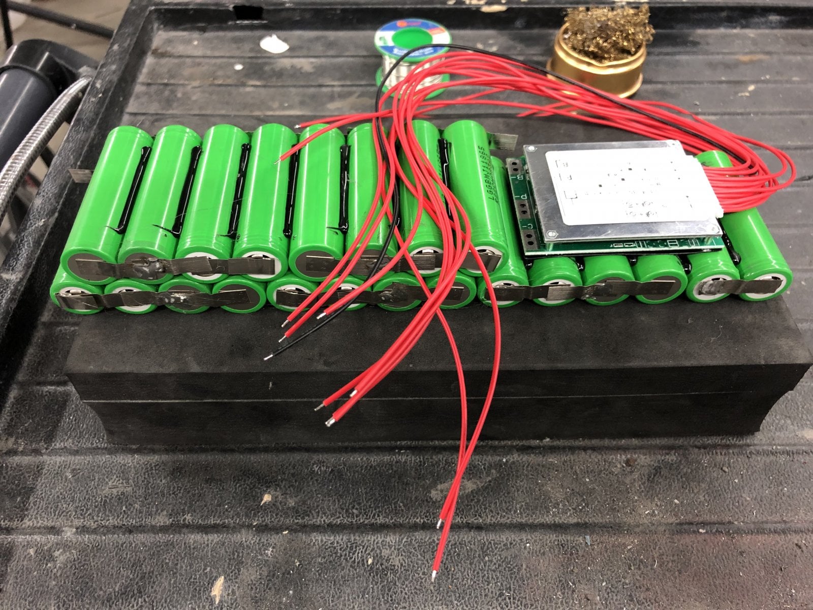

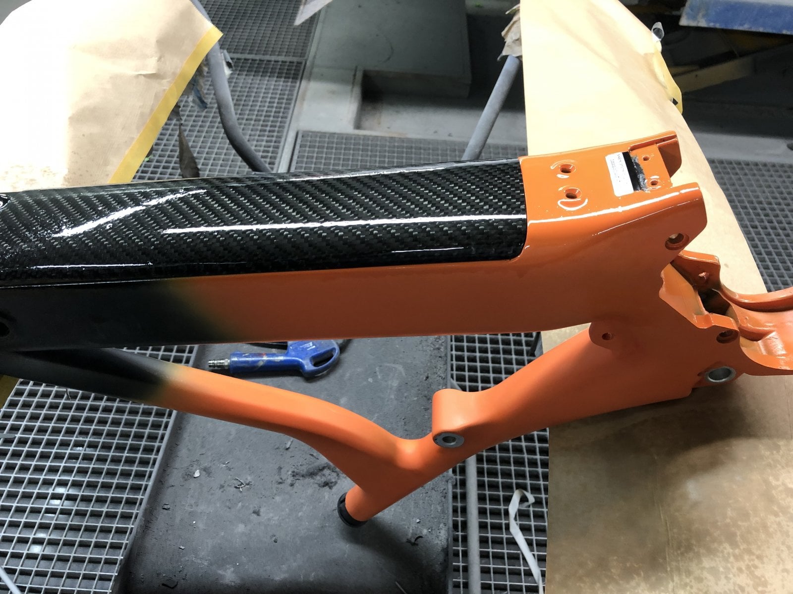

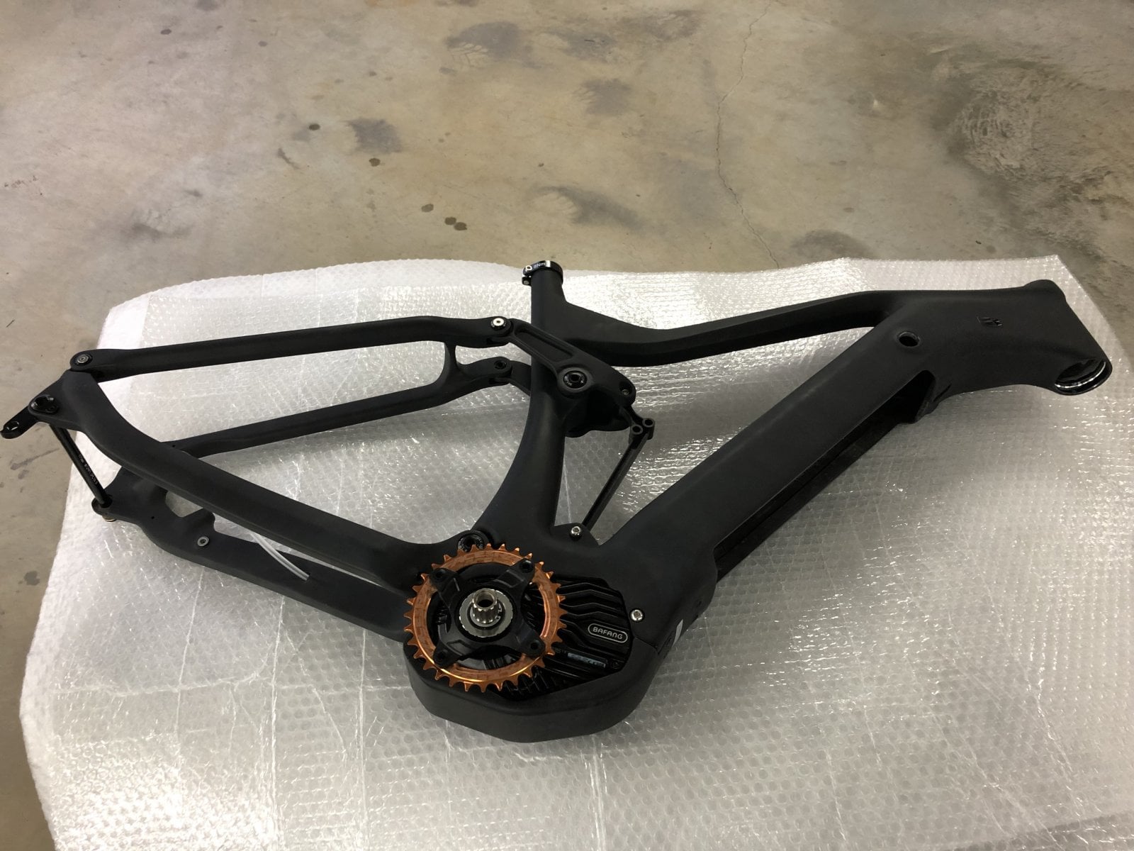

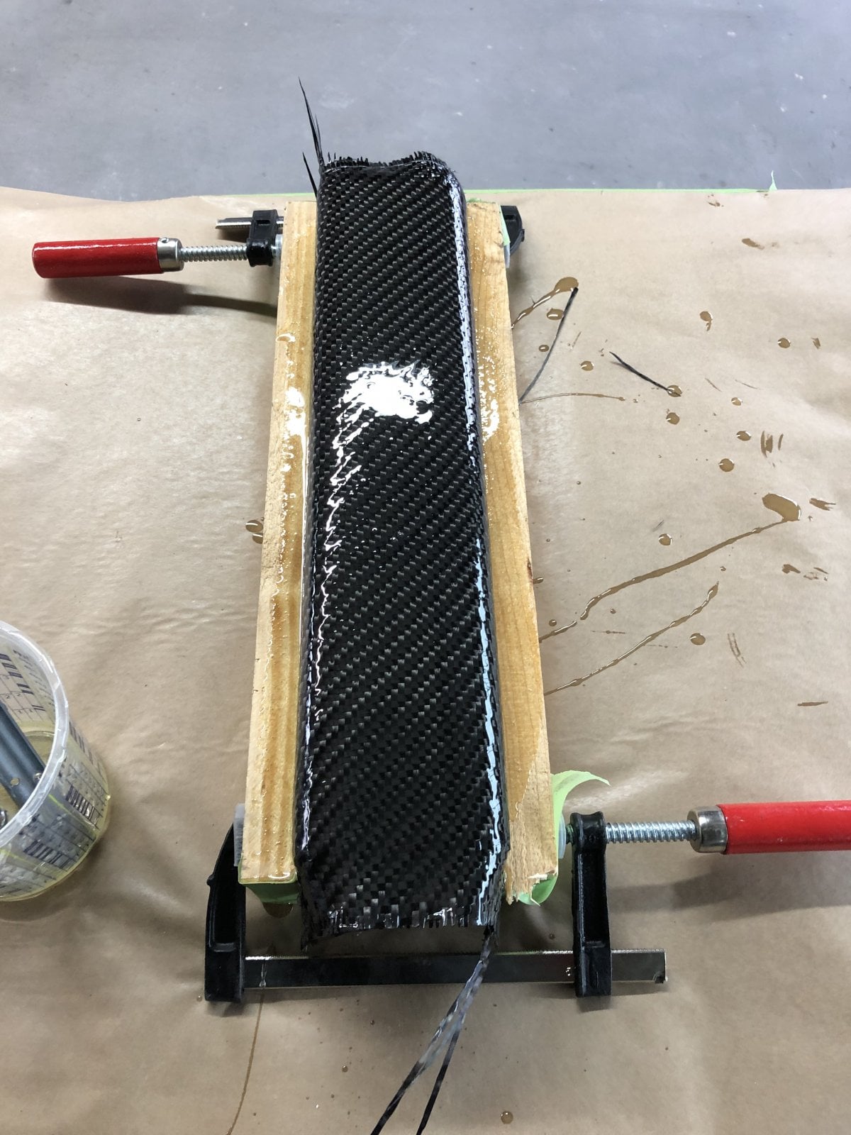

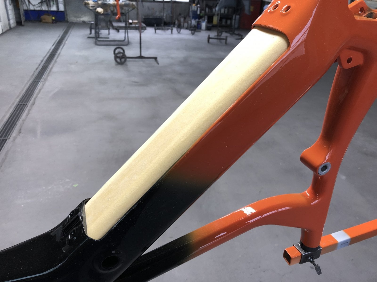

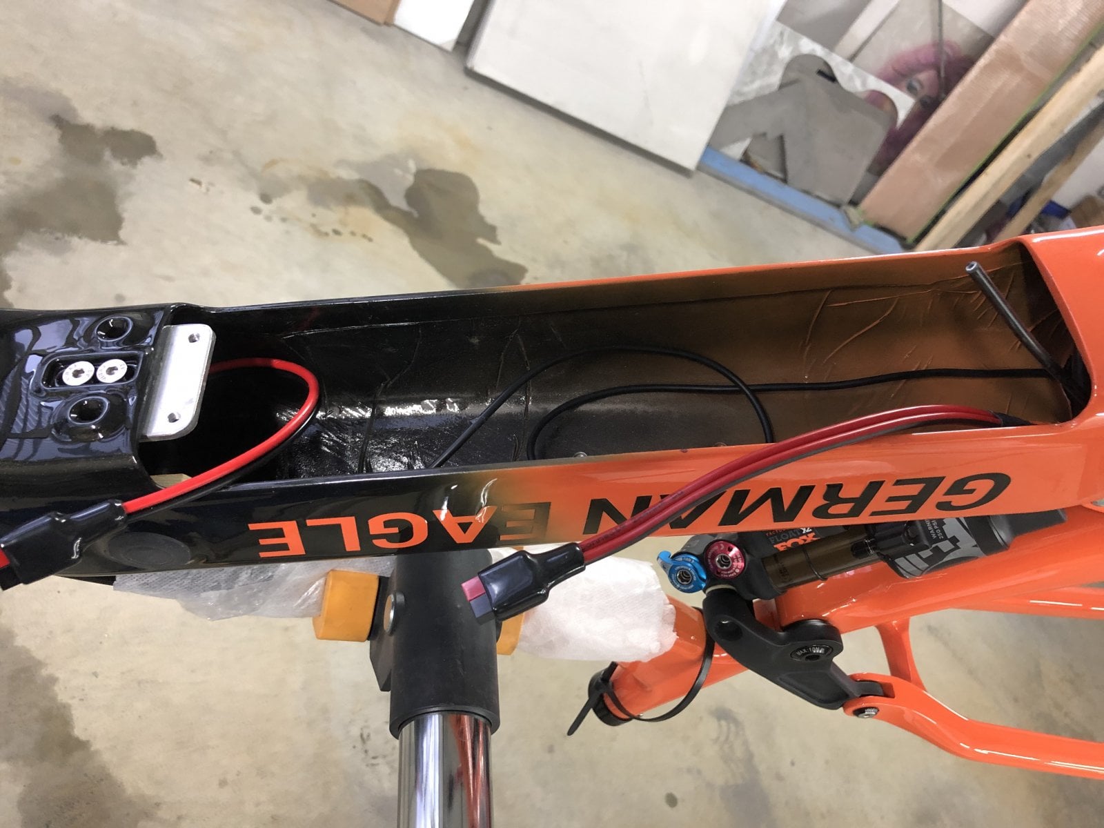

The small 280Wh battery is only to save weight, the frame is usually for the M500 / 600 motor and has space for up to 800 Wh. But you have to make the battery cover yourself :unsure:

KaroKonig,

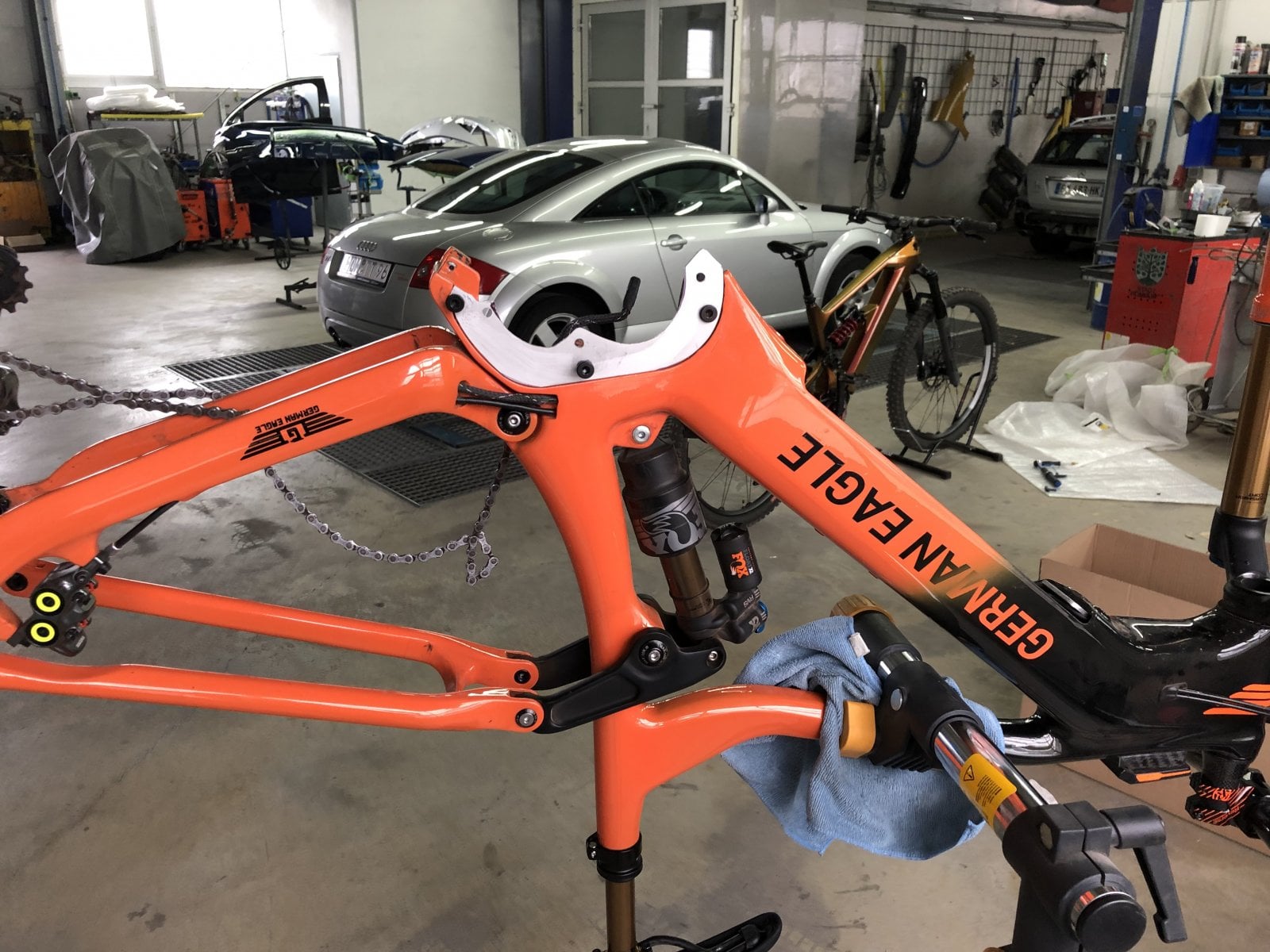

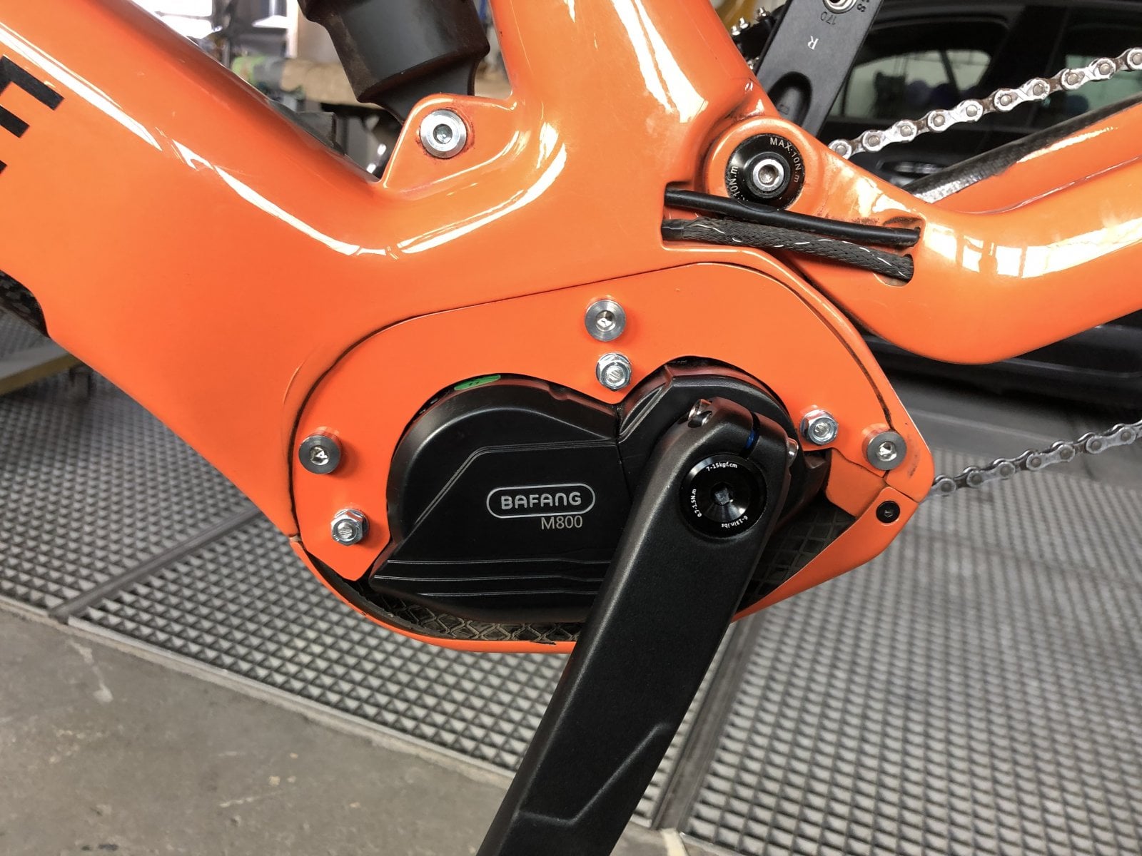

M800 is not a straight fit for this frame but only a clever machinist can do it, definitely not for us normal guys here :)
I'm wondering if you were able to run M800 in similar turbo boost mode of Levo SL?

In the highest support level, the M800 delivers just over 400 watts and 55 Nm, a little more than the Mahle in the Levo SL

KaroKonig - luv your innovation! Will you share the custom motor adapter dimension for M800 to fit on the M600 frame housing?
Savas - like your idea of swapping M800/M600 - I want to do the same if possible.
What mod is needed for M800 46v version to run on the same Bafang 48V battery for M600?

you could only charge the battery up to 46.5 volts, but that would not be optimal because of the high weight and the higher cut-off voltage of the BMS
It's no fun pedaling a 22 kg bike with a weak engine up the mountain?
So it‘s better to built a light Battery for the M 800 to save another 2,5 Kg

Do you think it would be an easy straight motor swap using KaroKonig's motor adapter plate?
