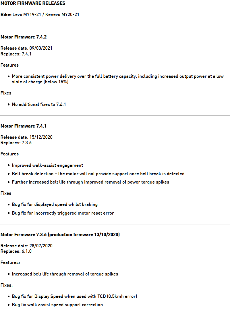

NEW 2.1 MOTOR FIRMWARE RELEASED (09/03/2021)
New Motor firmware 7.4.2 for 2.1 motors is now released to all riders via Mission Control.
In order to install via Mission Control please refer to the updated post on this thread >>HERE<<
To find out what has changed in this latest firmware release please refer to our new firmware release notes in Mission Control under "Find out whats new here." before updating.
Please feedback on your experience on this thread!
Enjoy, Specialized Team! :)

Hi, I also updated the firmware last weekend and did a test the next day expecting something good but definitively the bike lost a lot of power on turbo mode. I have acceleration set to 20% and revised that after update it was also in 20% but the punch of the bike is much more less than it was. Not sure if the power it delivers is also lower but I am quite dissapointed. If each update is made to have less problems with motors, belts or batteries under warranty but giving customers less performance, we should complain. (note, I have turbo model in 55% power / 75 peak power)
7.4.2 has voltage compensation
This means you have a little less power as on older firmware with fully charged battery.
But you will have the same power untill the battery is full discharged!
I think you can really feel it at the beginning. But the more power you have at the end of a long ride is really usefull.
I also think that the voltage drop and the loss of power with an empty battery is a lot stronger than it is on other motors, like shimano for example!
If you are really unhappy with that, you could maybe downgrade to 7.4.1!
Voltage compensation should be the only change...
[Edit]
I just checked it on my bicycle. Unfortunately it's not possible to downgrade to 7.4.1
I personaly like this feature, but I really think this is something that should be possible to turn on or off by the mission control app!
