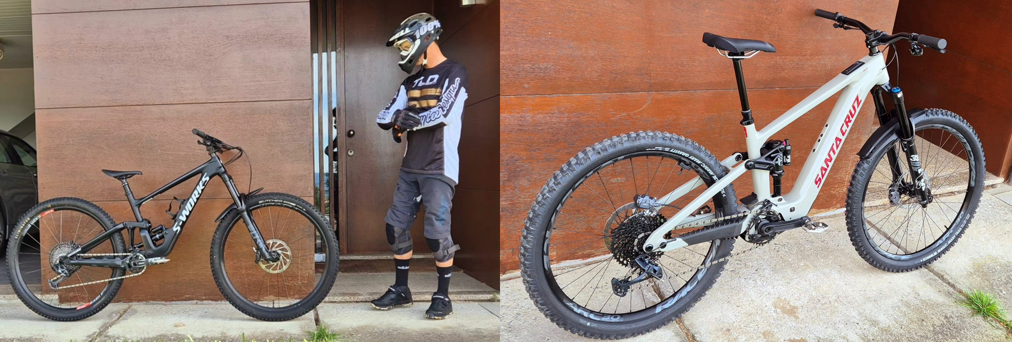

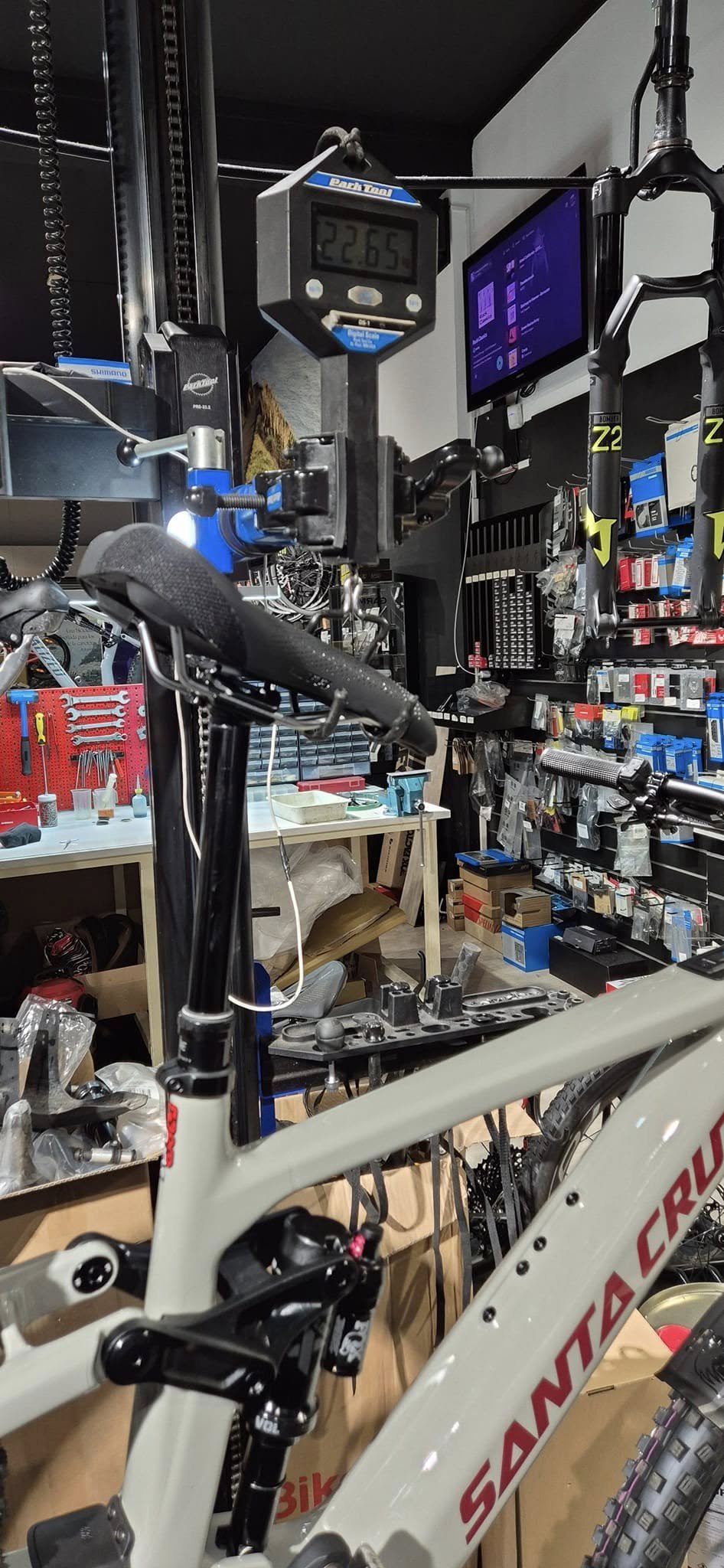

For me the wait was too long, I went from a Specialized Enduro Comp to a Santa Cruz Vala and I am completely satisfied.
This weekend I went for a 42Km ride with an elevation of 950 meters.
33Km in tour+ and 9Km in eMTB, I didn't feel the need for more power.
In the end 26% of battery was left, which means that 444Wh of the battery was consumed.
I weigh 68.5kg equipped and I'm 1.72 meters tall.
I'm in relatively good physical shape (53 years young
), considering I'm coming from a 2020 Specialized Enduro Comp and all my friends already ride ebikes
On this ride I went with a friend of mine (+- 1,85 meters) who has a 2022 Specialized Levo Comp and weighs 25kg more than me.
The Levo consumed 575Wh, that is, 29% more than the Vala. I believe that this difference is essentially due to the weight and physical shape of the rider.
The bike is a kit S, size M and weights 22,65Kg with pedals (405g), liquid in tubeless tires, mudguard and RideWrap 95%
I haven't done the jumps in the Enduro photo yet, but so far I haven't missed the 170mm of travel. The Vala is much quieter going down and more comfortable. When I land it feels like I'm landing on a mattress
