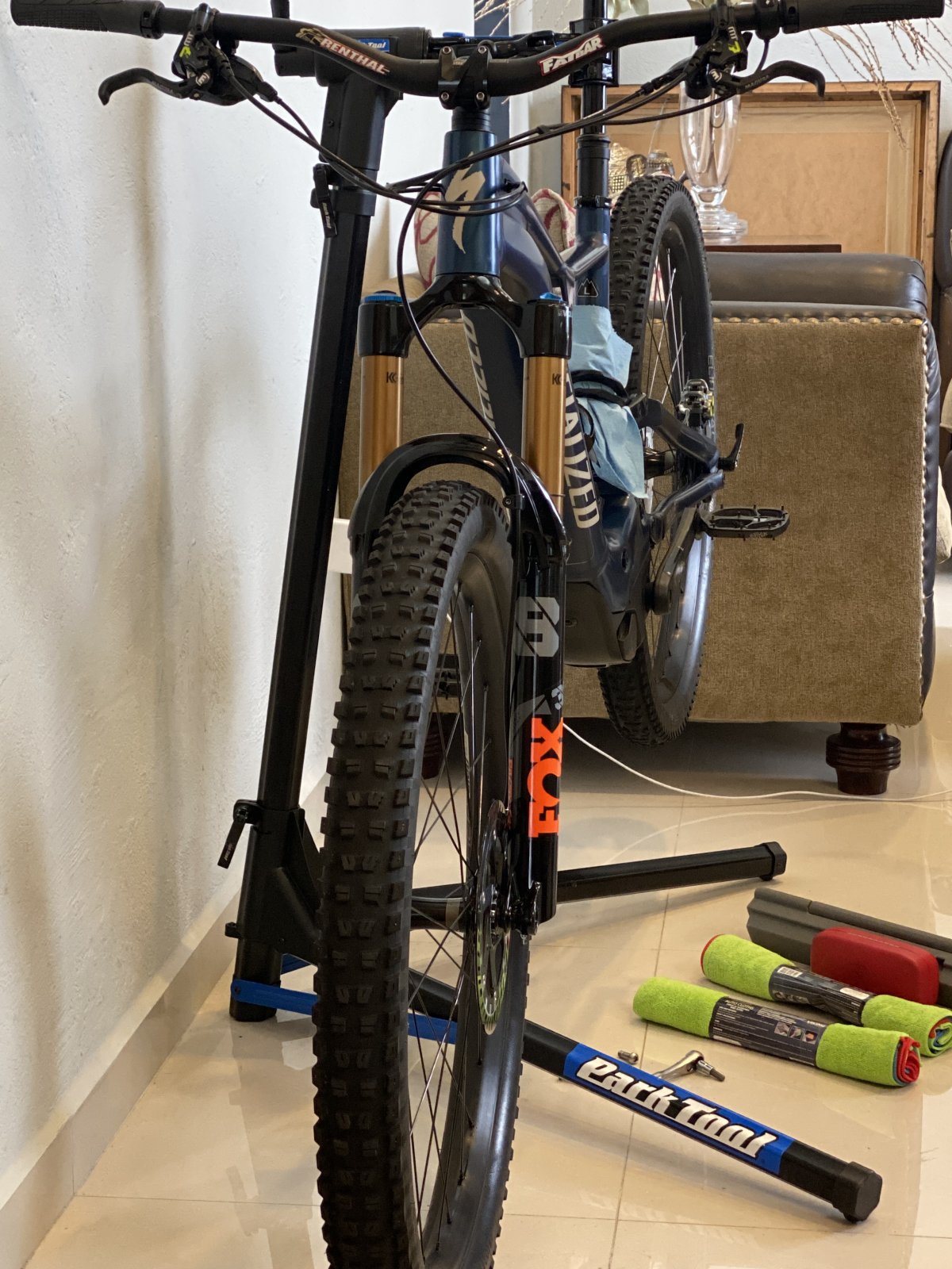

I have converted from Lyrik Ultimate to Fox 36 today and the frontwheel wouldn’t fit. The RS obviously had torque caps installed on the front hub which I removed. Now it fits, but do I have to use other/smaller caps for the Fox or can I ride without? Sorry if my question is stupid.
No other caps are needed. You can even run the Lyrik without those caps, they really only help with aligning the wheel when refitting and nothing else.
How do you remove this cap?
