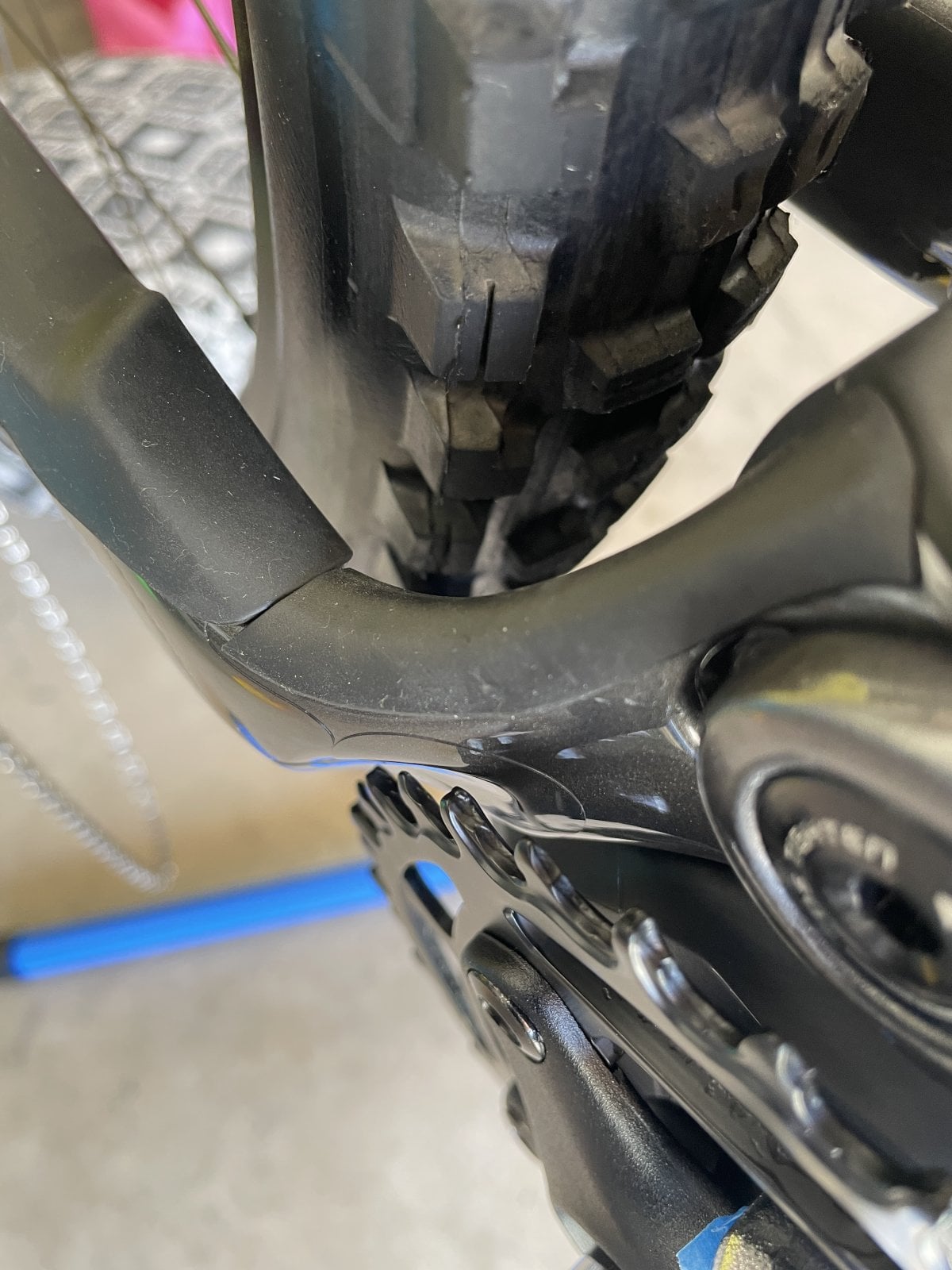

Mounted up the SRAM X-Sync2 38t Steel chain ring today. It’s so close to the frame at the chainstay that the teeth touch my invisiframe wrap. Too close for comfort.
I pulled it and going to install a SRAM X-Sync2 36t Aluminum chain ring instead.

Sorry to hear that. Mine has about 3 or 4mm clearance, close but certainly not touching anything. And the other folks here have said pretty much the same.
I did notice that once your weight is on the bike the clearance opens up to 1/2" or so. Might it have something to do with how much your shock is pumped up ?
Damn, must be disappointing after all that work to set up for changing out. Hope the 36T does what you're looking for. Keep us posted.

The chainring only touches the swing arm when the suspension is at full droop. When the bike has weight on it, I agree there is more clearance. Anytime the rear wheel comes off the ground could result in the chainring digging into my frame. So ordered the 36t.
I'm very sorry to hear that - I have done more miles with my 38t - No problems at all and clearance is still ok
I hope You will enjoy your 36t 🤘

Interesting, never thought about that. My frame is the carbon S6, the biggest they make.
That’s likely the reason the 38t worked for your frame and not mine. My frame is an carbon S4. Installed the 36t today and it’s a great fit. Also modified the stock chain guide to work by trimming the back plate with a dremel.

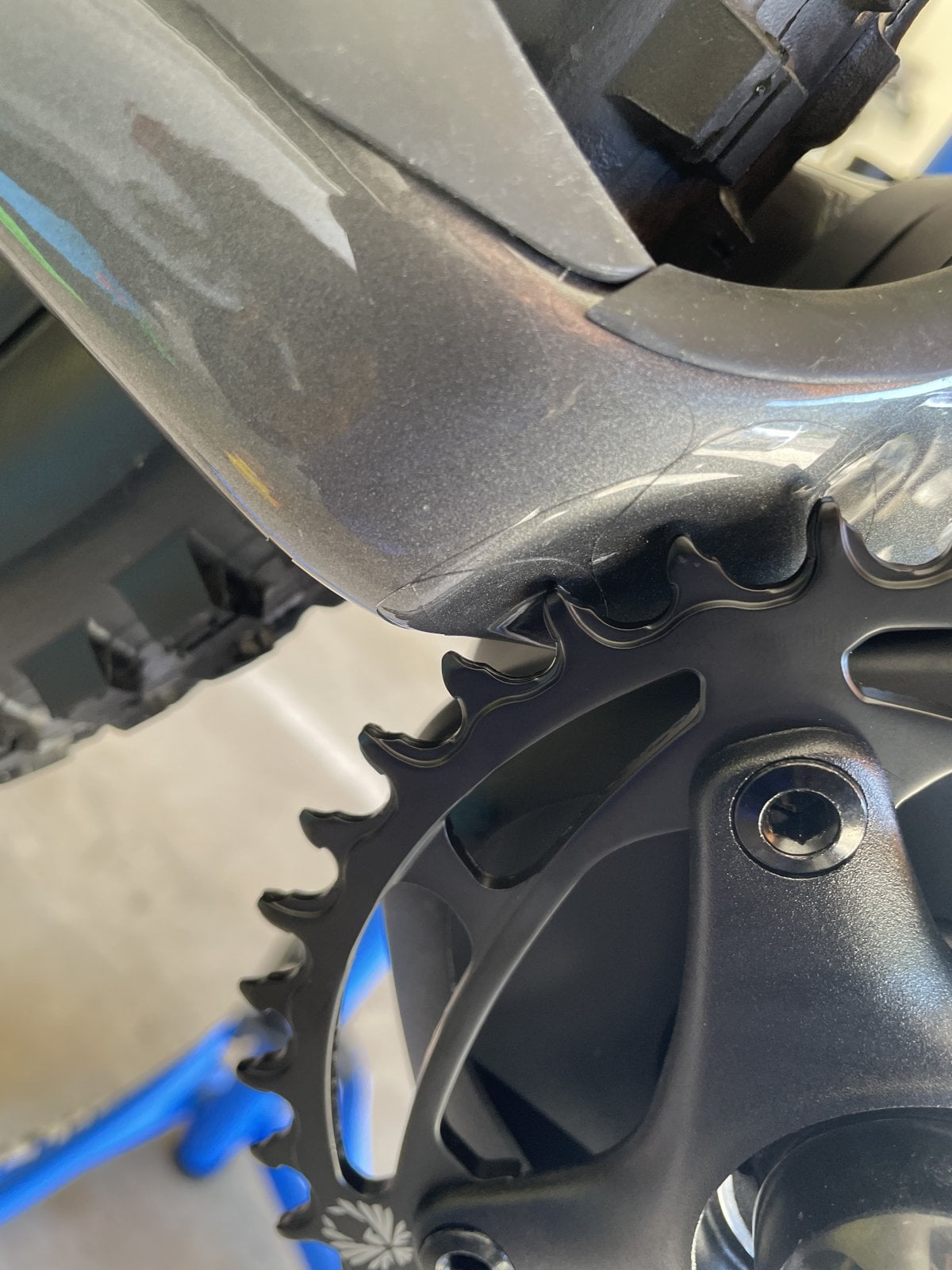

I too have this problem, fitted the Sram 38T steel to my 2022 Levo Comp Carbon S4 and with no weight on it catches with zero clearance so gone back to 36T Hope Aluminium one, fits fine has clearance was just hoping to get a bit more use of the mid range gears instead of the top 3! Never mind :)
With no weight on the suspension, it barely catches...just brushes the frame wrap. My concern is anytime you hit a jump and the rear triangle quickly extends the chainring could start digging in to the frame. I have a few rides with the 36t and saw some improvement over the stock 34t on my Expert S4.

I come bearing sad news. I tried the 38t on my 22 Levo Alloy Comp tonight and it did NOT fit at all. I guess I'm ordering a 36t. :( I can't seem to find the sram x-sync 2 36t in stock anywhere. I saw some had the raceface gear above. I'm not excited about aluminum, but it's all I can find. Is there a "best" one to get since I can't find sram?
The good news is that at least I got the 34t off without removing the spider. I totally see why some people are having problems doing that. At first I was thinking there was no way it was coming off that way, but after some tinkering it finally went. The best I can come up with for hints to help... Lets call the bolt attachments arms... you have to push the ring gear all the way as one way, I'm pretty sure I had it pushed forward. Then line up two of the "arms" at the same time with the "corners" of the gear. Best I can tell, mess with making that work, because until you get two arms through at the same time, you're not going any farther.

You are right, the clearances on the 2022 carbon frame with the 38t chainring is quite tight at around 5mm. But as soon as your seated it will expand the distance quite a bit. I haven't had any issues with it but then again I do not ride trails or do jumps, gotten too old for that! But the gear range now is much better suited for me.

If it is of any use, thought I'd add that on my 2022 S6 carbon I was able to use the 38t chainring. There is about 1/4" clearance when I am off the bike and expand to 1/2" or more when riding.
It sure makes the ratio of gears better for my type of riding.
Almost 1000 miles on it already with no problems, but it should be noted that I do not do any jumps or heavy trail riding, mostly bike paths and single tracks. I weigh 190lbs, 6'7" tall. And love the bike!
