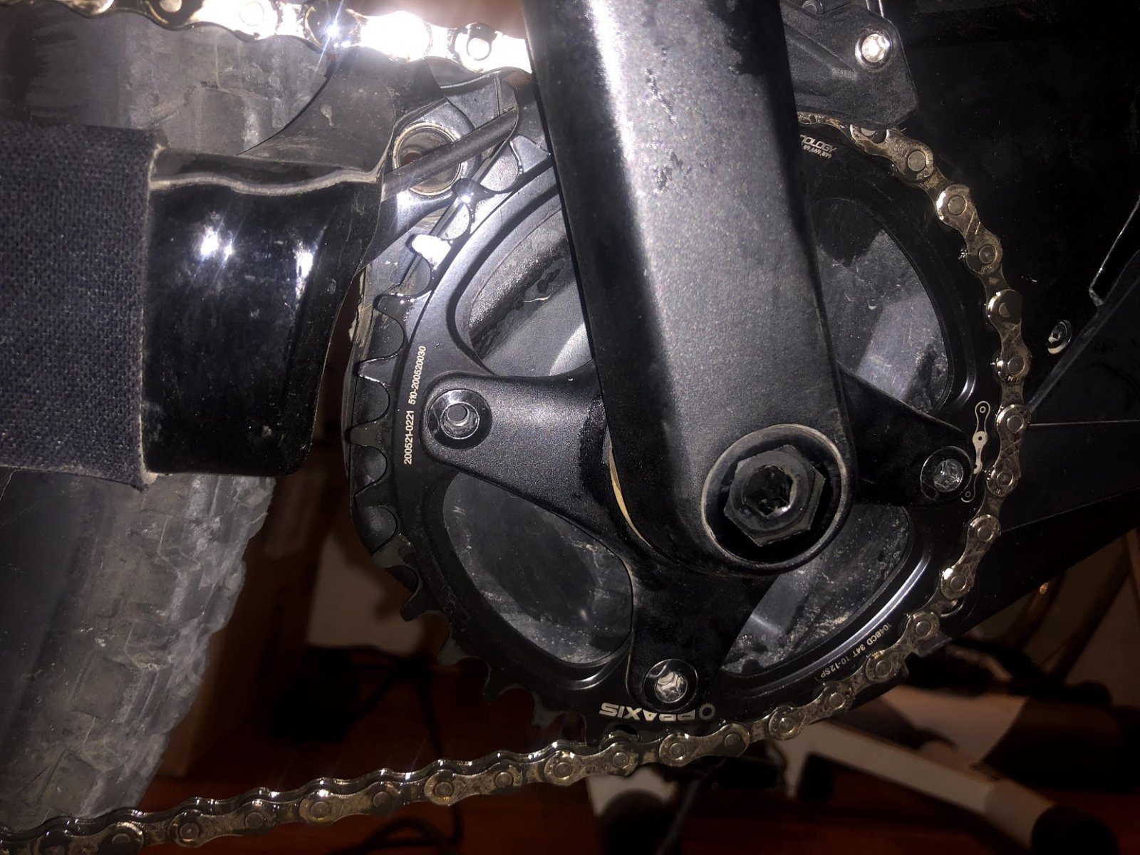

I just put these on and the fit is good. I didn't have to remove the crank arm. But, I am not sure how to make the chain guard work. I can't find a position for it that looks reasonable. Do I just skip the chain guard, or do I design and 3D print one that will fit?
Amazon B07R32WRPV
Amazon B075DGJLS2
chrisdut
Aug 21, 2019
30
17
Chester
Amazon B07R32WRPV
Amazon B075DGJLS2
I can't get it to fit either, so removed.
If you can 3D print one, you might have an order from me ;)

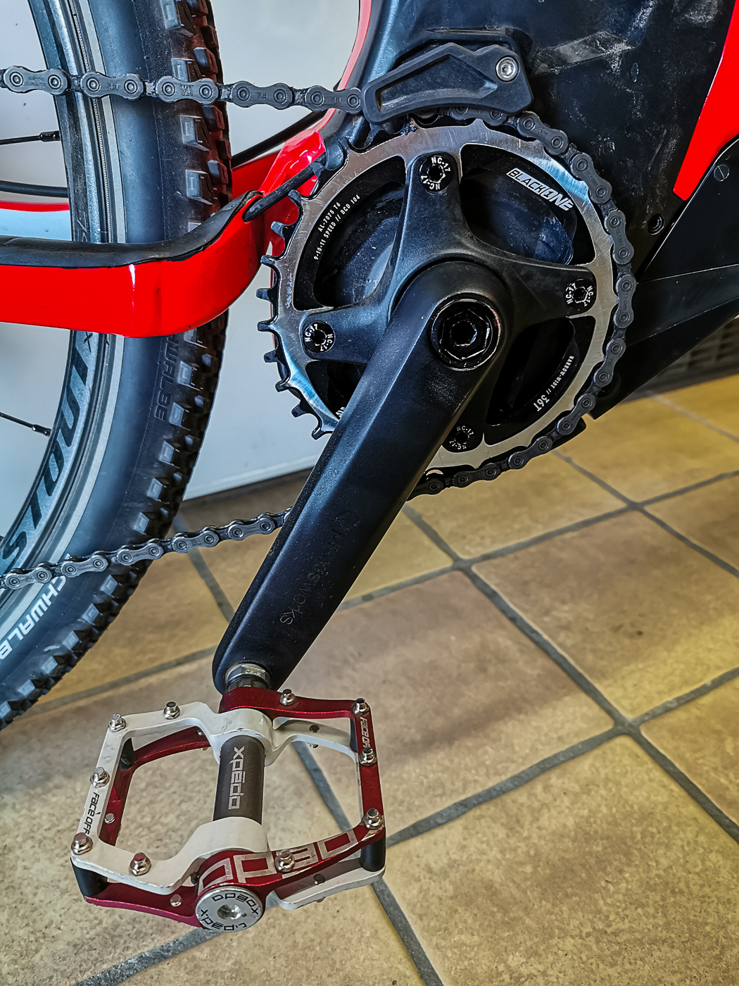

Fitted a Blackspire Snaggletooth 36t chainring today, no need to remove the crank and spider, only the drive side pedal. A bit of a fiddle fitting the bolts, a found rolled up bit of sticky tape helps to hold the ‘nut’ in position underneath the crank spider when putting in the bolts. I’ll update later after a few rides. View attachment 1894

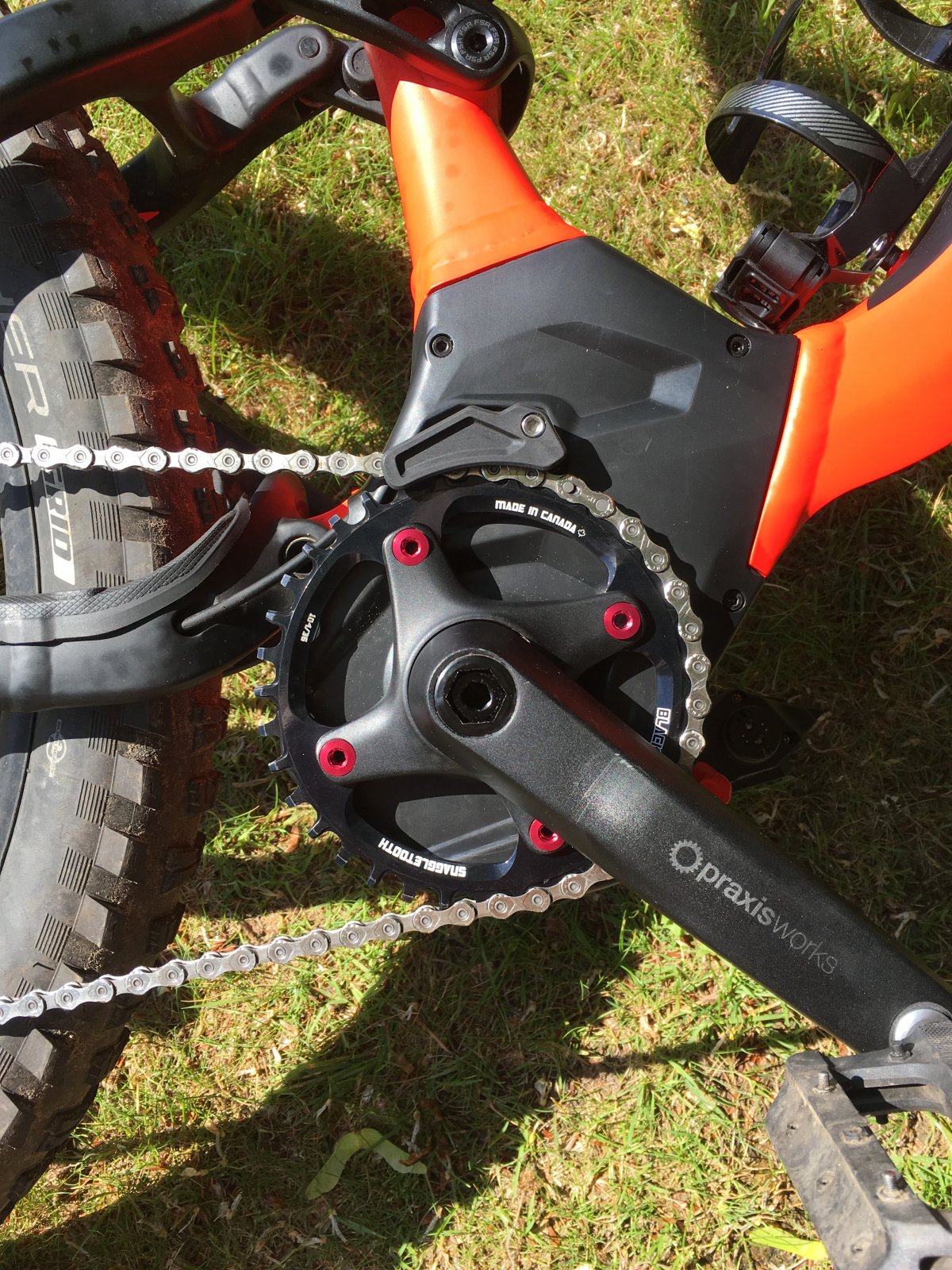

As an update, so glad I went with a bigger ring, I am spending much more time in the middle range of gears now, only using the lowest gears for transits along fire roads between trails. At the other end of the range, still not really using the highest gear for anything but the steepest climbs. I haven’t changed the chain, it’s still got the original on it, as I am not using the highest gear very often I don’t see the point and I thought it was a little slack with the 32t ring out the shop. It is going back in for its free service and a tubeless setup so will get the shops opinion.
Reference your earlier post, you don’t need a special tool to hold the bolt nut, just use a small flat screwdriver to hold the nut in place from the side whilst you tighten the bolt. It is obvious when you start working in the area, but there is a bit more room to access behind the chainring between 7-8 o’clock position, where the motor housing is recessed slightly more. In this position you can put in the bolts, stuck to a bit of tape if you have fat fingers like me, and get a screwdriver in to one of the groves on the back of the bolt to hold it in place to tighten it up.
Just not sure about those bolts now, I thought they were going to match frame colour, but they are more like purple!

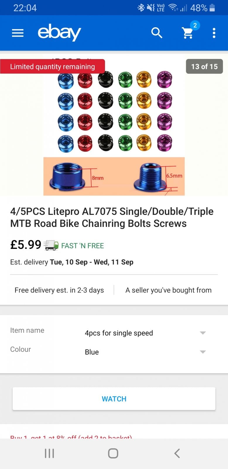

Where did you buy the bolts any link online?

I bought this one in green and used it all summer so far happy with the performance. I don't out peddle my bike as much on pavement. I did have a issue with the two bolts coming loose during a ride. So after you install these keep doing nut checks. Locktite might help.
