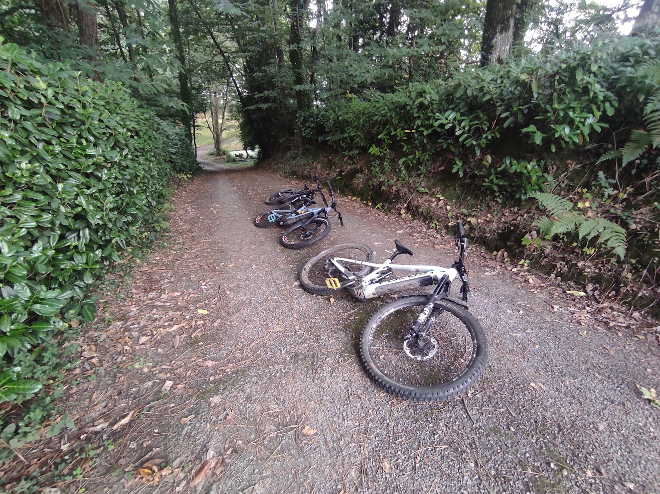

OK, so not laboratory at all, just basic curiosity and knobbing about :) ..
For me I find different tyres can make a huge difference to range, DH22's for instance will give me about 20-25% less range than the Wild Enduro's on the Kenevo.
Kenevo Expert 2019 L 27.5/27.5 - Tubeless, Wild Enduro's 1.5 bar, 500wh (new wheel bearings) - 24.5kg
Jam 2 6.9 2021 M 29/29- Tubeless, Magic Mary's 1.5 bar, 630wh - 25.7kg
E-Mythique VR 29/27.5- Tubed. Vee's 3 bar (stop snake bites and suspension testing). 630wh - 26.4kg
The test ... drop in from standing. Then take a straight line over the grass and see how far you can get going back up the drive on the other side :
Not the results I was expecting. The Kenevo always feels like it's rolling the easiest and it's the lightest. You could argue the Focus has more momentum with it's mass, but the E-Mythique has even more momentum and a higher tyre pressure - but then did that cause the tyres not to absorb undulations and therefore lose speed ?

@Zimmerframe so what were the results/findings 😂😂 ….
Apparently the results were so uninteresting that I forgot to write about them .. The pic is where the bikes stopped.
In first place .. the Mighty Magic Mary !
Second place goes to VEE Tire Co.
Last, but not least goes to the Wild Enduro's .
If we need that mathematically then μ = F/N , therefore the Mary's were 0.00137 , the Vee's were 0.00146 and the Wild's were 0.00153 or in it's simplest form Mary 1, Vee 2, Wild 3.

Wow. I expected the Magic Mary to be really slow rolling 🤯
Sure it's not a lab test, but this includes a load of real world factors, so it's actually quite relevant.
I'd always discounted them previously as I'd imagined they'd be really draggy - despite being told they were actually really good (but my head was firmly wedged up my own arse).
I was really surprised when I first rode them. They seemed to feel the complete opposite of how they looked in terms of rolling. I've managed some huge rides on that bike with those tyres whilst still keeping a high average speed.
I should try it again tonight when it's hot and see if that affects things.

OK Lab geeks ... :)
All tyres at 1.5 bar.
All suspension locked where possible or set hard.
All motors off (no chance of an accidental start boost cranking when going over the lip).
All droppers down.....
Full tuck and precisely followed the same line each time.
Each test was performed twice and each time there was no more than 30cm's difference !
The Focus was run an extra time with the suspension open and lost 50cm's from it's closed position on it's second run.
All the bikes went further than yesterday (tuck and line I guess).
Today. Mary Wins, by about 50cm more than yesterday. Then E-wild. Then Vee.
The Vee would seem to roll slightly better at 3 bar than 1.5 bar. Yesterday it had half a bike length on the Wild, today it was 30cm's back.
