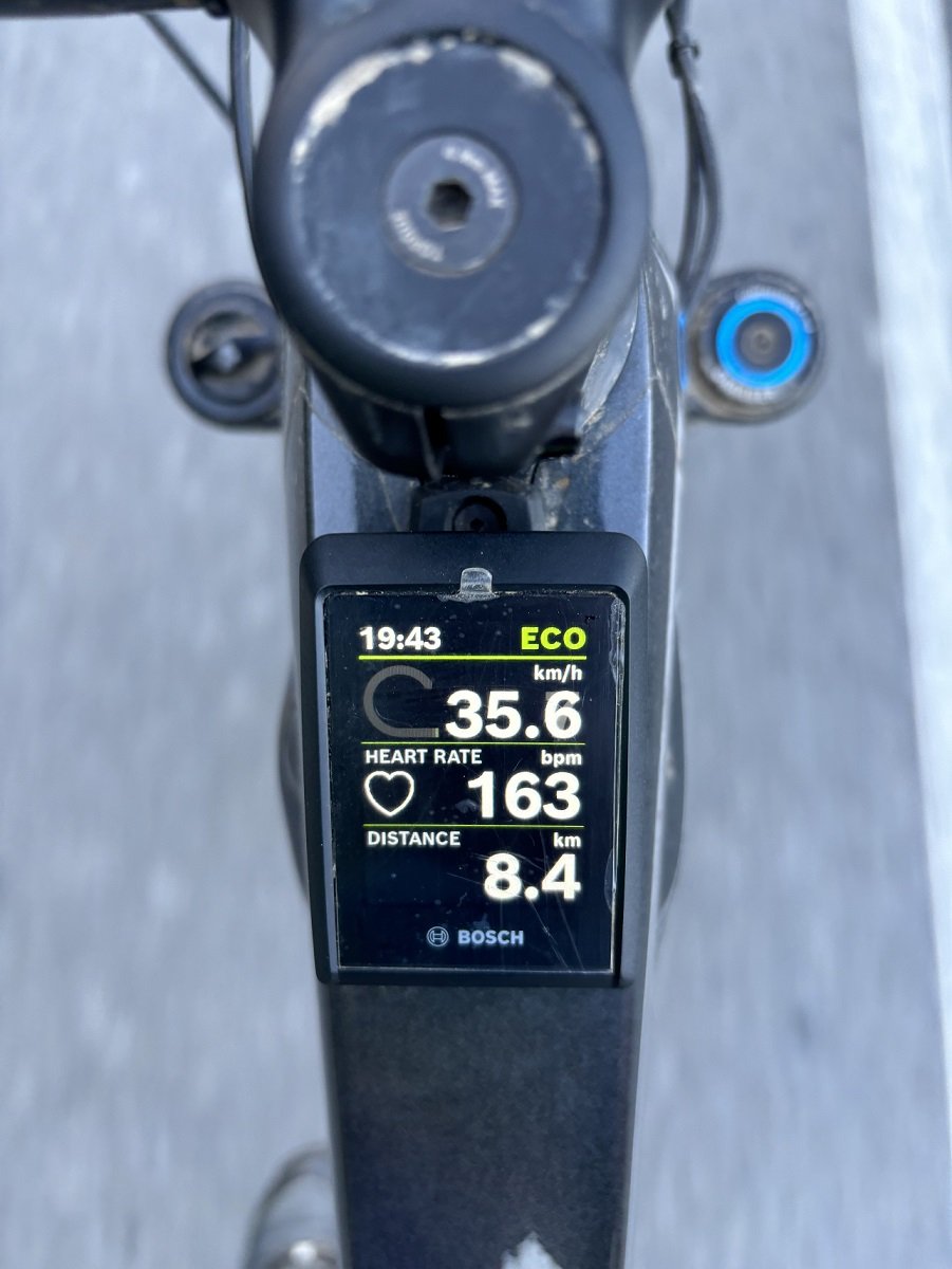

So after the latest August 23 update it seems that the Kiox 300/500 still cannot display heart rate on the display. The previous Kiox could accept HR information from a select list of HR straps etc.
I'm sure they are working on it but I'd love to see HR in real time on the Kiox from a strap or apple watch/garmin etc

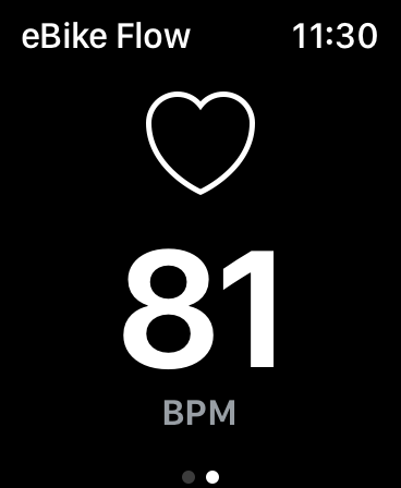

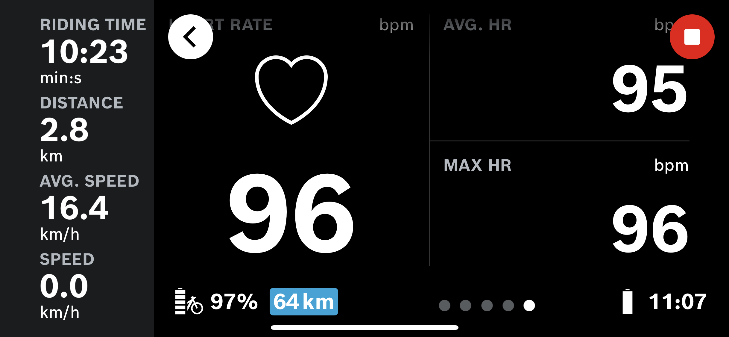

Here’s my experience. I have linked my Apple Watch to the Bosch Flow app, and my phone is mounted on the bars. With the Flow app open on my phone, my watch displays heart rate (in the Flow watch app)
and actual/average and max heart rates are available on my phone (in the Flow app)

the watch display is of very little/no value: I don’t want to be looking at my watch just to get one piece of information;
the phone display is potentially useful but I don’t use it because a) the Flow app display only works in landscape orientation, and my other bike apps are all portrait, b) the information displayed can’t be customised (I want HR, power, cadence and speed on one screen).
As others have stated, there is still no way to get this HR information displayed on Kiox 300. What is most frustrating is that we know that Flow communicates with Kiox 300 while riding, for example to display elevation information (that comes from the phone GPS).
I live in hope that HR information will be available on the Kiox 300 in the future, but the fact that it wasn’t part of the recent screen customisation update suggests that Bosch don’t understand how important/useful HR information is.
