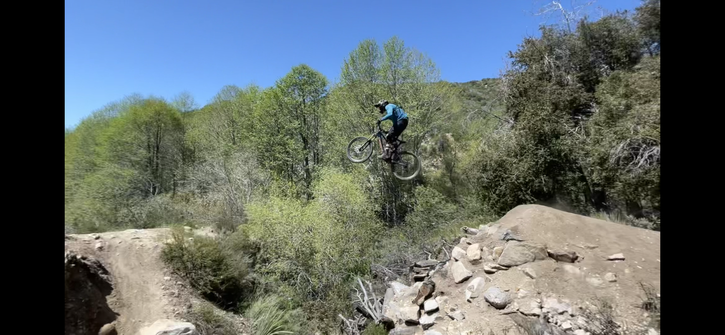

I’m 6’4 and 240lbs riding an XL Rise and have no issues with the rear end kicking out on jumps 🤷‍♂️ and I’d venture to say I’m testing it…..

I’m 6’4 and 240lbs riding an XL Rise and have no issues with the rear end kicking out on jumps 🤷‍♂️ and I’d venture to say I’m testing it….. View attachment 147321
I'm 80kg and notice the Rise having more flex than my previous Nicolai trail bikes, and my Nukeproof Mega.
You're 108kg. The OP is 120 if they're 19 stone.

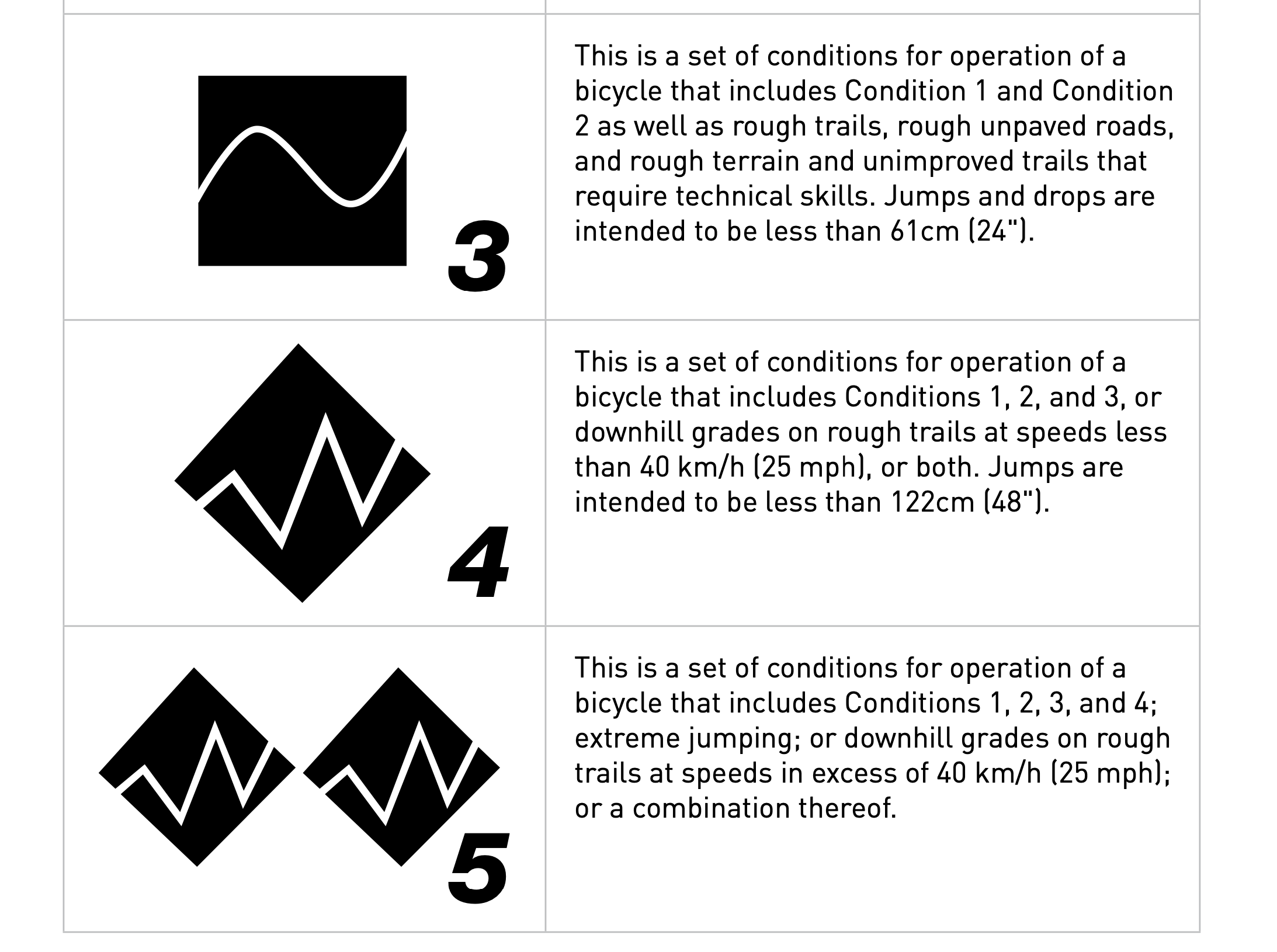

Thats a seriously big gap - no idea where your landing is. Orbea has the rise as a ASTM cat 4 bike. I'm not sure how a 1.2m drop translates into jump sizes but I'd imagine if your bike broke on the jump above you'd not have much luck with a Warranty claim.
In terms of height not distance. No?
