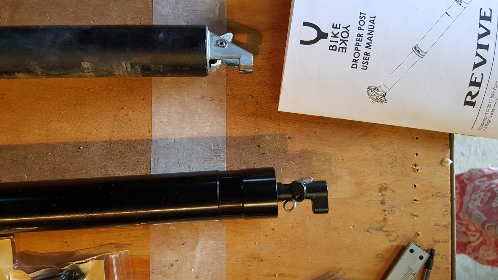

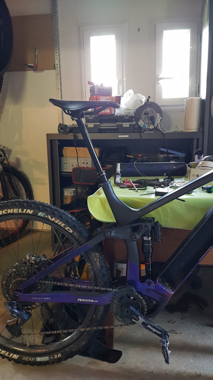

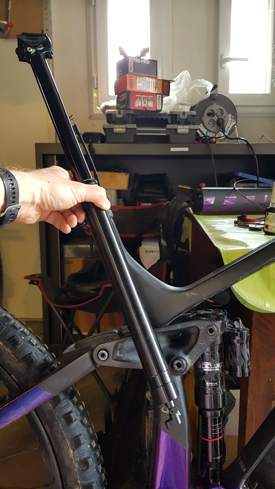

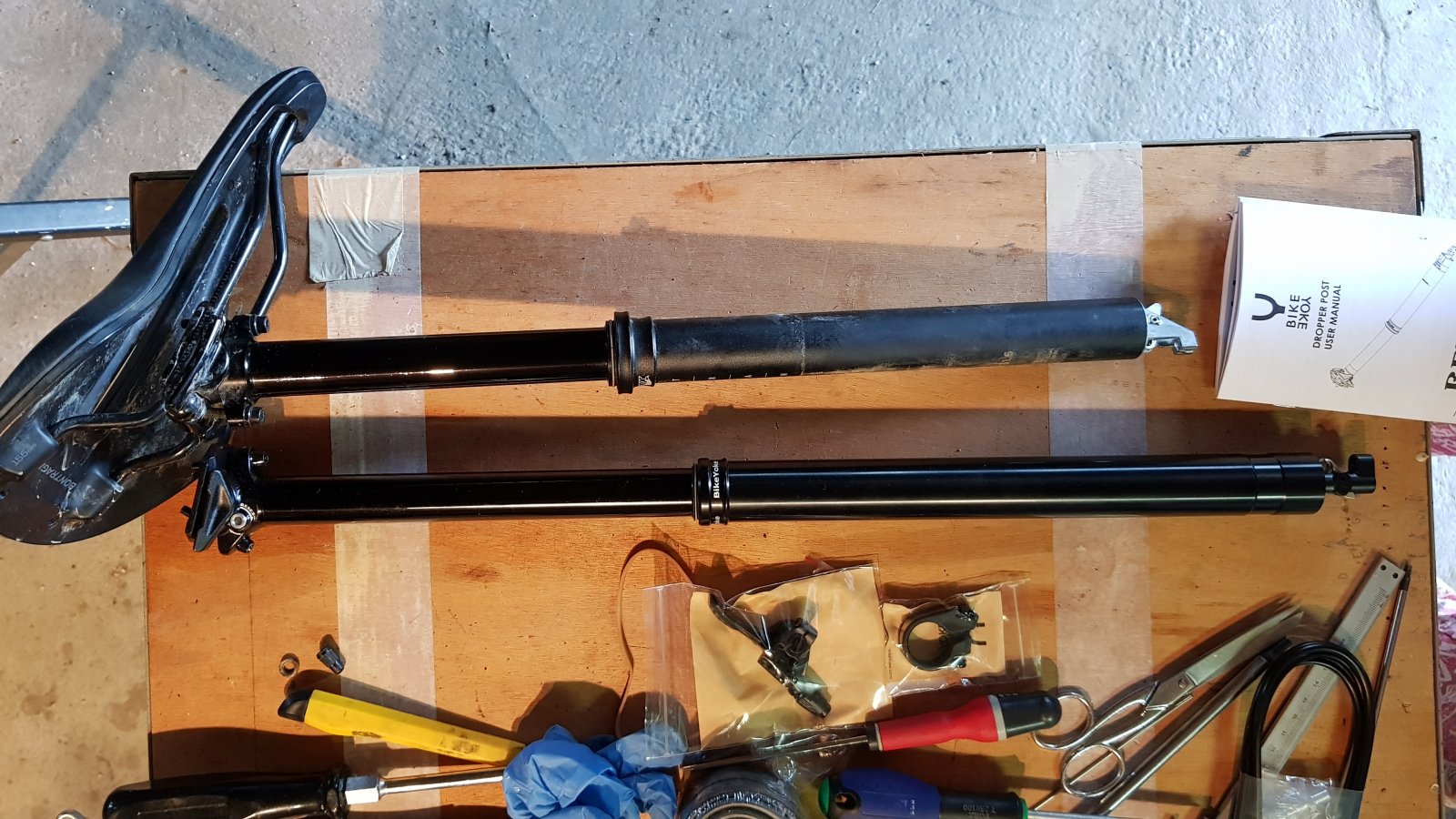

I just bought a (lightly used) 2021 Trek Rail 9.8, in XL, with some custom parts (i'm sure you guys will find out from the pic, won't you ?). Next to it is my good old Remedy 29.
The bike came with the dropper post removed, and i had some troubles pulling the cable from the frame, and tried to unscrew the bottom battery holder. This was not a good idea... I managed to install the dropper, but now i think the position of the battery is too low. I will have to follow the procedure to align it again, but i need a special T25 "secure" key.

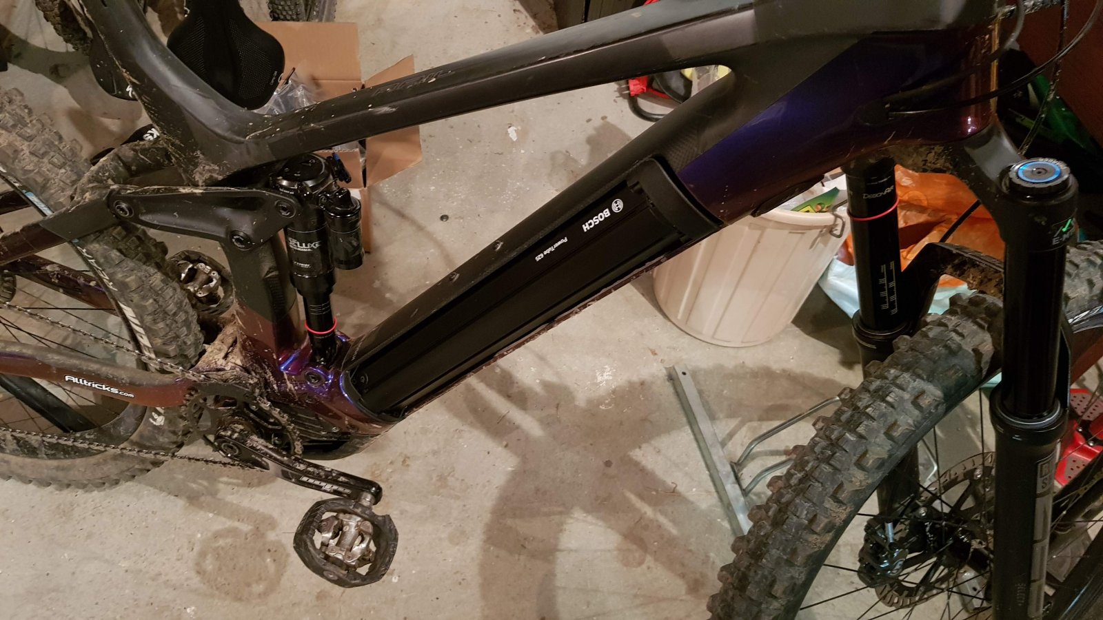

2 more rides in.
I played with the Zeb once more, going back up in pressure around 77psi, but opening the low speed compression 1 click more than Trek's recommendation, and it was much more confortable than before at the same pressure. I rode some unknown steep singletrack and it didn't dive too much. This is a step in the good direction. I will now try to continue to play with tokens.

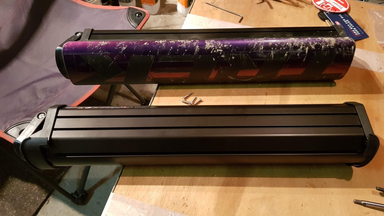

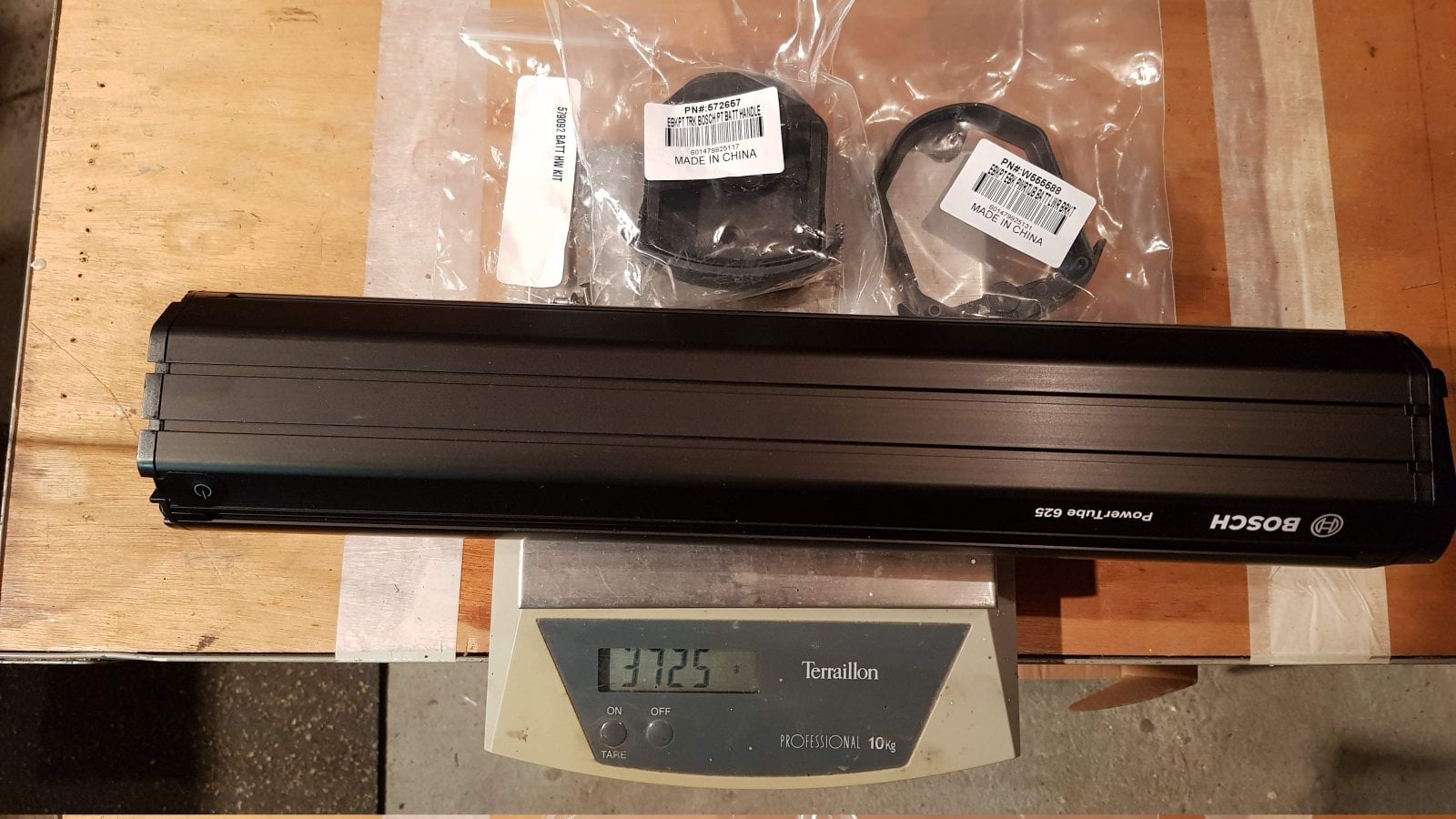

At least, i received the screws for my second battery. Here you can see the 3 references. I still miss the panel (on backorder until may)
I proceed to install it. You have to unscrew and remove the standard hatch mechanism in order to install Trek's version. Only the short screws are necessesary (2 at the bottom, 4 at the top, 2 of witch you need to screws with an allen key with a ball tip)
All in all it is 3685g without the side panel. My stock battery weights 4000g (with a little bit of dirt). Is this side panel so heavy ?
I installed in the bike. Works perfect... except the look !

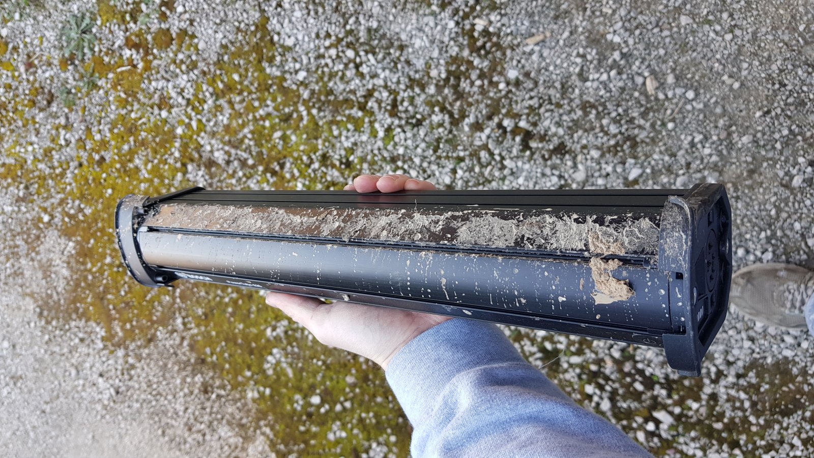

Lets hope the rain stops so that i can now go for 2400+m climbing with both..
As planned, i also worked on the battery location. I had a big gap at the top after unscrewing the bottom screws to try to move the dropper cable. And was uncomfortable with the idea of the battery popping out, and used scotch preventively.
I followed the instructions in the sticky, but found that moving the battery in place was difficult. I prefered to pull the battery out, pull the electic connector at the bottom by hand towards the top some millimeters, screw back, and try to install the battery. I now have a much smaller gap at the top, around 2mm.
But i have to use the key to fully insert the battery. Is it the same for yours ?
Yes the key is required to insert the battery , without turning the key it won’t click into place .

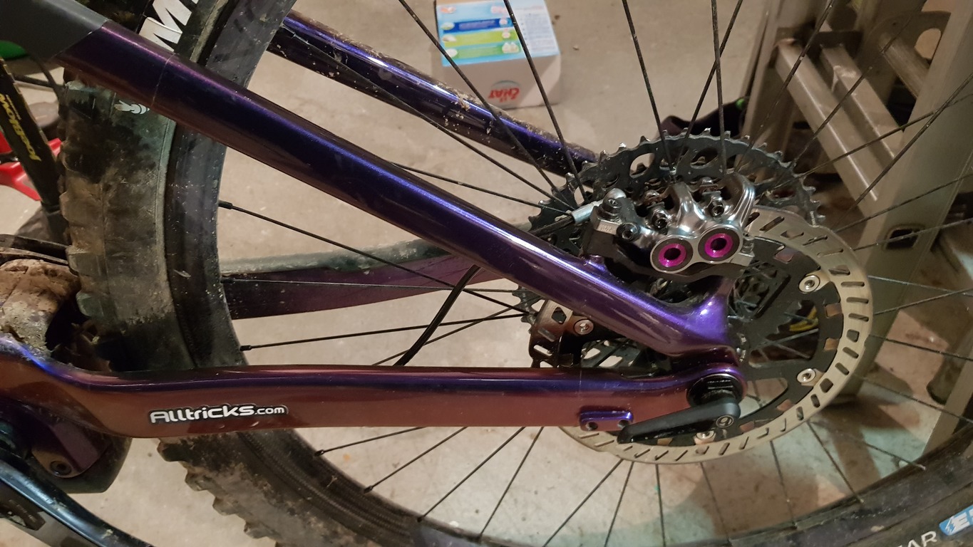

I'm not really into tunning of my bikes. The color i prefer for them is ... dirty or dusty !
But on this new bike, i couldn't stand the yellow color rings on the Magura brakes. I found out that Magura is selling other colors, but i found them really expensive for a little bit of plastic ! So i 3D printed some, and i really prefer the result...

Regarding brakes, my home made color rings are holding fine in the front, but i lost the ones in the rear. May be they get heated more (i use the rar brake a lot in the steep parts), and the fit becomes less tight ? I put two new rings in, and will let it empty if they don't stay put.

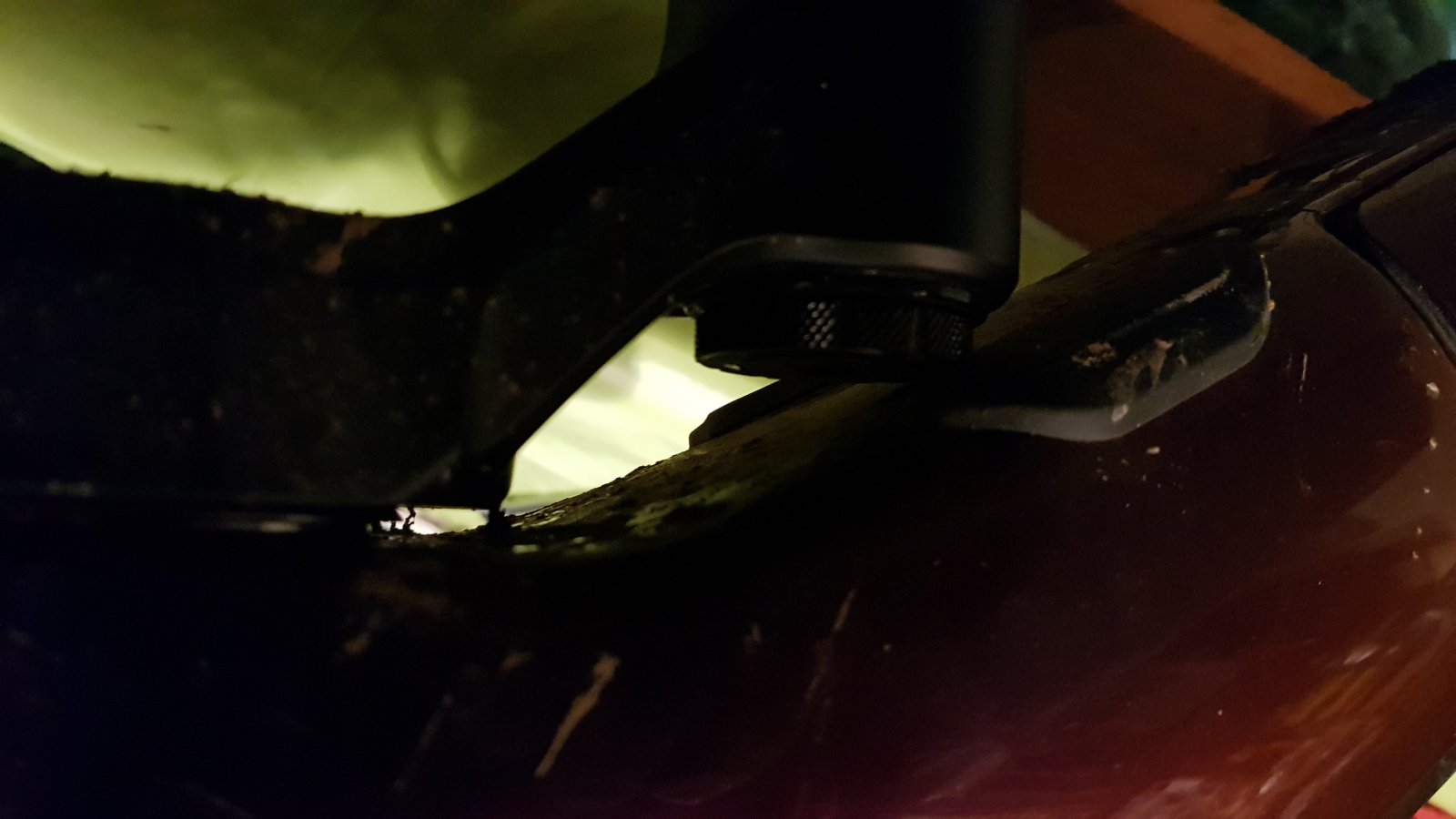

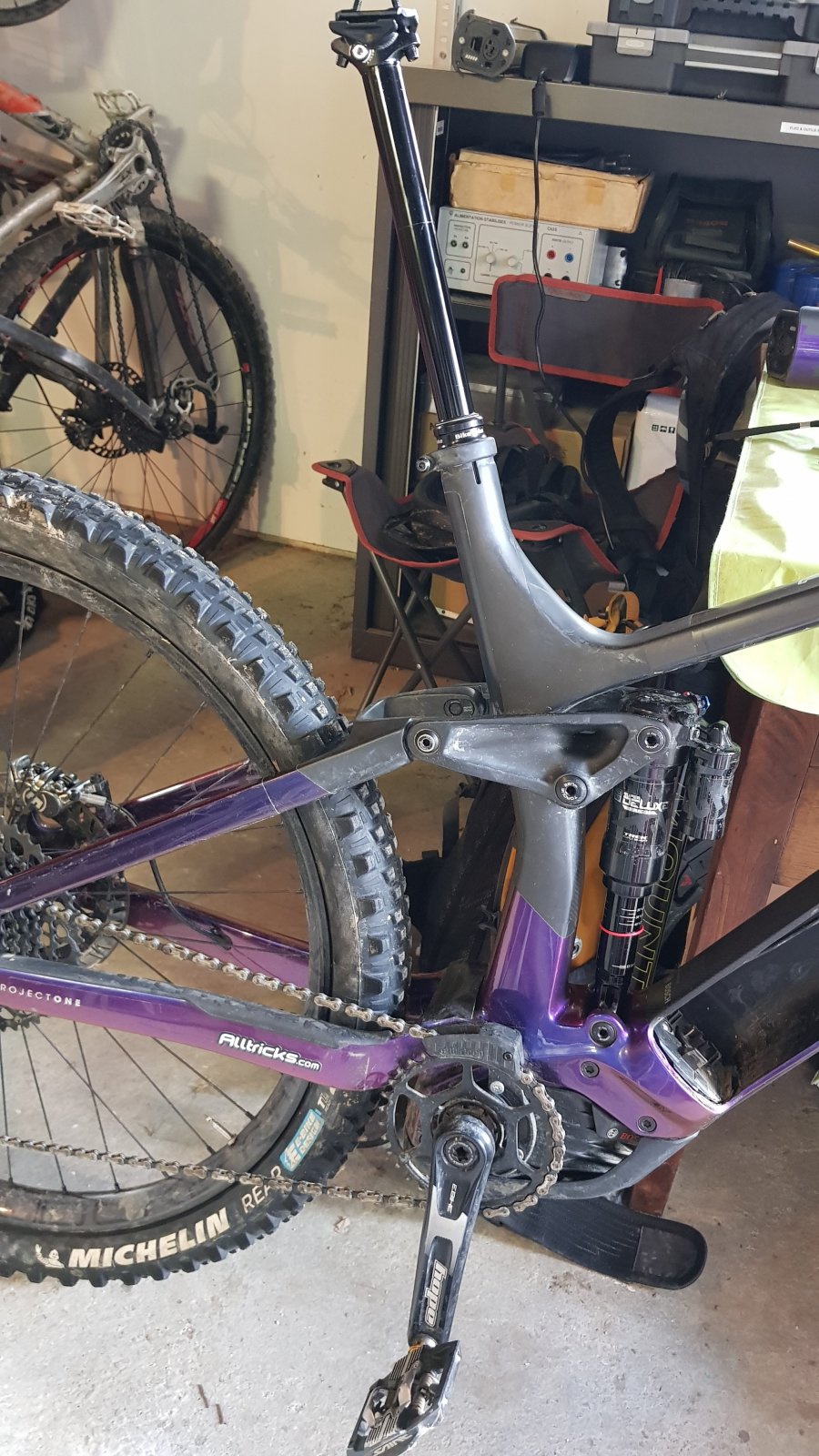

On this (upside down) pict, i removed the stem and knock block, and spun the bars to the max.
We can see that there is contact of the zeb with my xl carbon frame (look at the gap at the headset, the fork is resting on the frame rather than on the headset bearing).

So after some problems ordering, i received my Bike Yoke Revive 2.0 in 31.6mm and 213mm drop.
Here it is next to my 150mm Fox transfer that came stock with my bike:
I rotated the fixating bit, but it was not so easy, i had to hold it with plyers (turning in the direct direction to prevent unscrewing)
Here it is in the planned insertion position (28cm from collar to the rails)
I though it was pretty close, but in fact it can go all the way in !
Here it is in the final position? I just reused the existing houssing, but should have cut it a little bit.
Visualy, the bike looks smaller with this seatpost. It's a bit strange !
I did a test ride, works ok. More room to move in the steep bits.

I have received my second cover for the second battery, but not installed it yet (as you can see :) I will. I received also a new Bosh motor cover, but i'm not sure i will install it.
Still note happy with the Magura brakes. The "ceramic" pads i put in the rear do no work as i want. I ordered some Magura "Race". The calipers are touching the disks, even after a lot of fiddling. This drive me mad !
Second problem is touching the ground with the pedals. I will put on smaller pedals, then i plan on putting the mino link in high, and may be raise the fork to 170mm. This could also allow me to use longer cranks. My knees do not like the 165mm.
