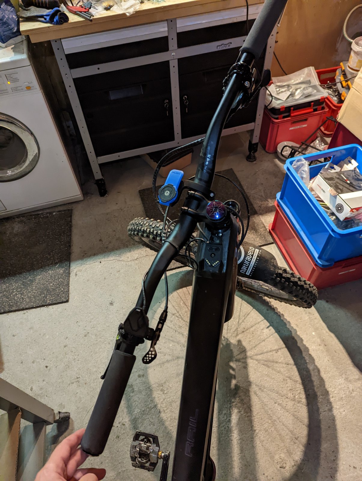

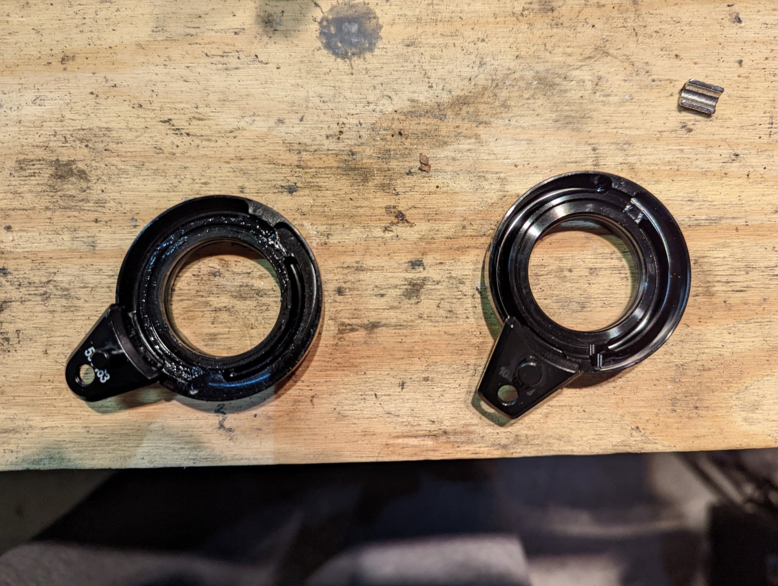

So i installed the new headset. It required some dremel work.
Stock parts on the right, new parts (Slash 72° kit) on the left.
The result : a better turning radius, and still knock block to prevent the bar from over rotating.

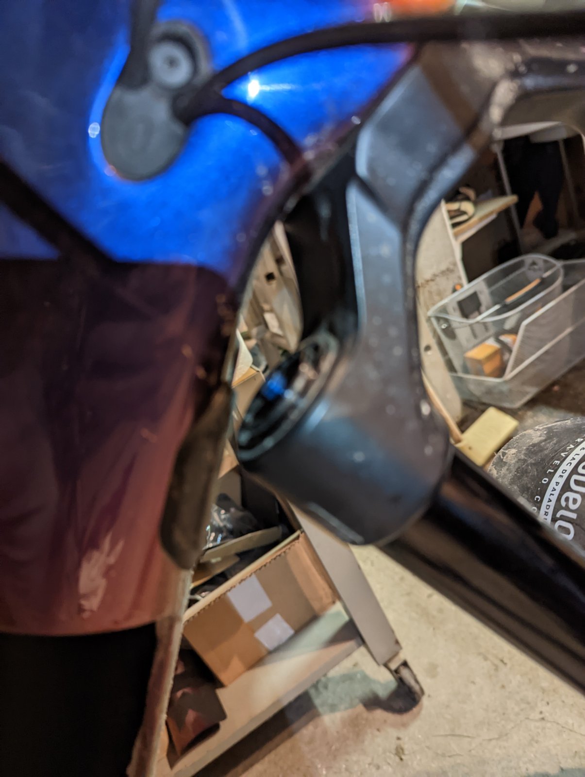

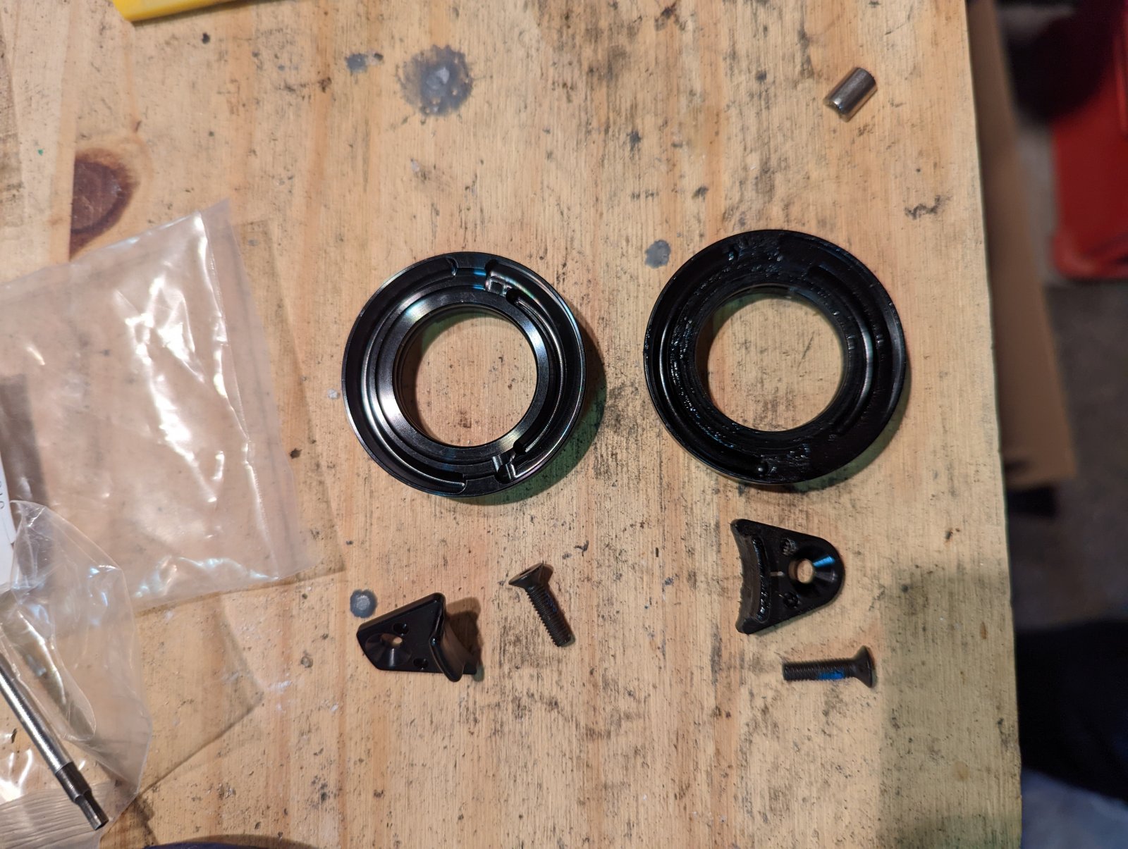

This pict was taken with the same extrem position (12 o clock), left is stock part, right is Slash 72° kit.
One can see the difference in turning radius.

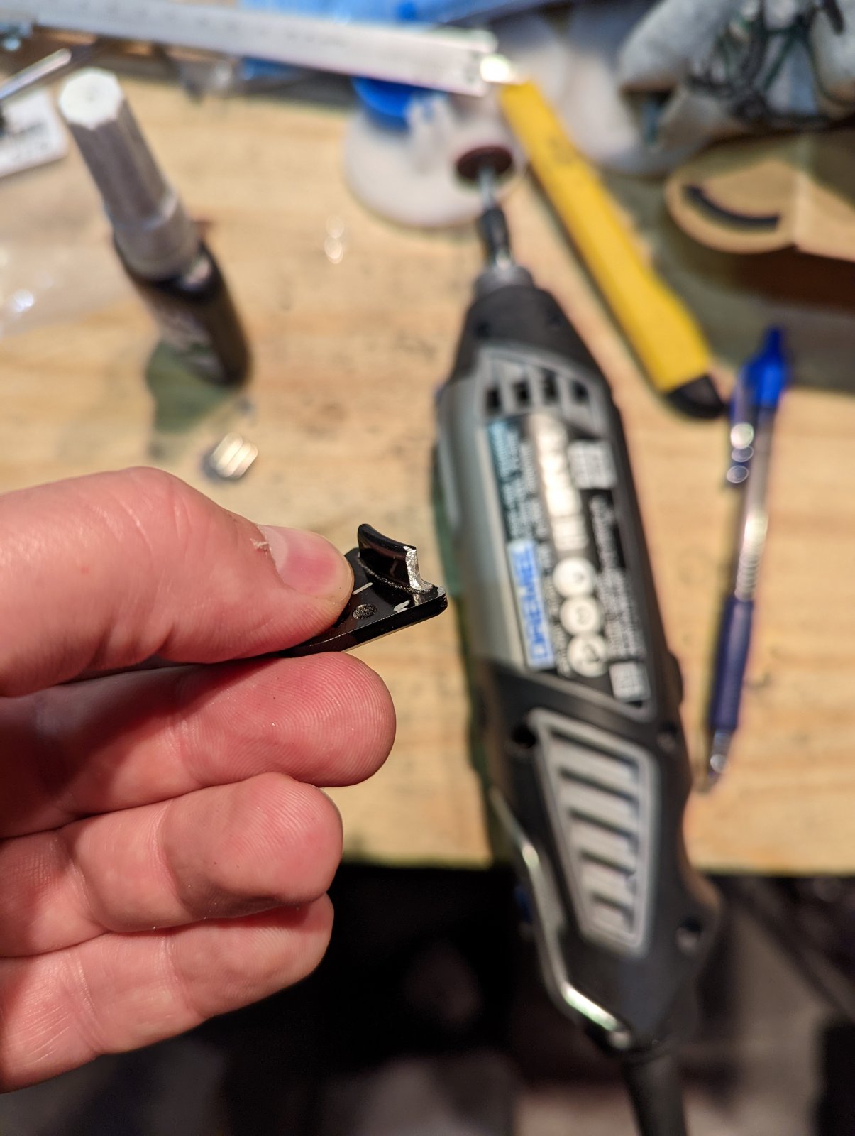

On the Slash kit i bought, both the top cap and the little part screwed on the frame are different. Top cap have an inside circular depression with a bigger angle, and the screwed part is narrower. I tried to just exchange them in my (carbon 2021) frame, but on the scewed part there is a little pin (next to the screw hole) that goes into the frame, and the new part didn't fit : on the new part the diameter is a little to big and can't penetrate.
So i used the new top cap, and dremeled the old screwed part so that it has the same width as new one.

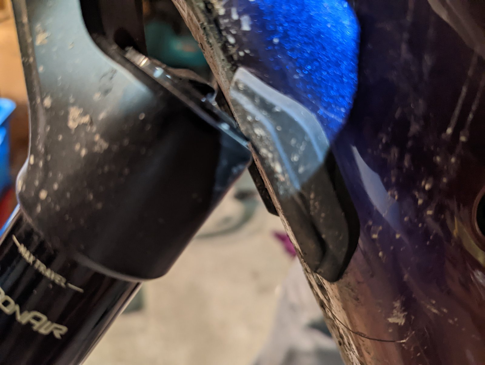

Frame clearance is ok (carbon 2021 XL frame)
