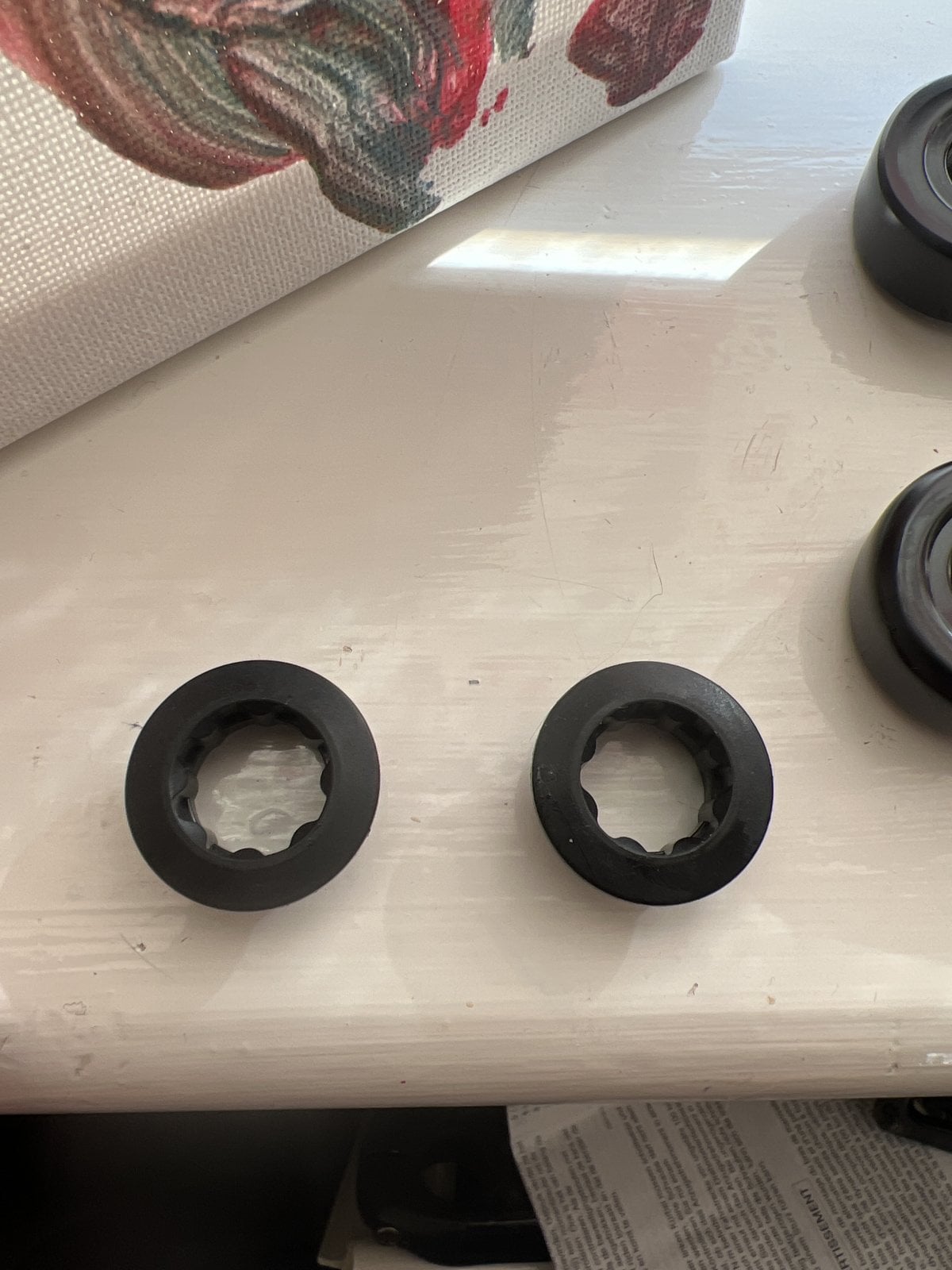

Hello all - in need of advice. So I swapped my cranks yesterday (no issues with the spindles thankfully - but I'm a little confused - there was a sort of rubber washer behind the drive side e13 crank, do I just discard that? I know the XT cranks wouldn't go fully on with it in place - and if so do I need anything to replace it with? there now seems to be just an ugly space behind the crank - any help appreciated.
See pics (apologies for the quality - it was all a bit rushed.
View attachment 104181 View attachment 104182
It was designed to be used with the E13 cranks so can leave out, I replaced mine without the rubber washer back in the summer
Thanks for putting my mind at rest - it does look odd, like something is missing which messes with my OCD a bit but as long as others have done the same with no issues.
I'm used to working on 'normal' drivetrains and BB's etc but am totally new to ebike maintenance.
At least now I have peace of mind that the spindles aren't cracked and in case of any issues I have Shimano cranks. The e13's are going in the bin.

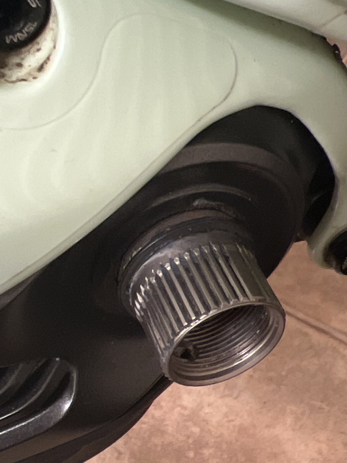

So I serviced my main pivot M10 yesterday and fitted Shimano Cranks...
My wife's M10 is the job for today. And on removing the E13 crank from the drive side theres a horrible little crack running from the hole in the axle to the end of it. (her non-drive crank is actually a shimano as she hit it on a treestump and bent the e13 on, I think, the second ever ride).
Anyway, so even correctly fitted Cranks, using a torque wrench with thread lock applied as per tech bulletin, are still resulting in cracking axles.

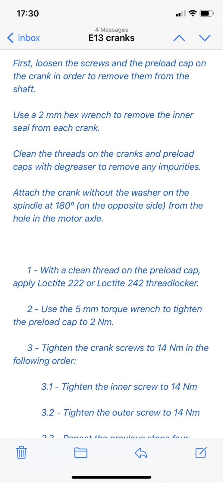

Latest advice (via my dealer) on fitment of e*thirteen cranks - note that they're upside down to how you'd fit a shimano crank (which has the safety tab/pin that drops into the hole).
