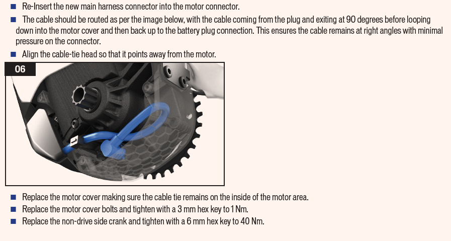

I ordered the new power cable as a precaution. My bike had had no faults with the existing cable. This is what the latest cable looks like. There is also now installation guidance in the service manual. I wonder if how the cable was installed is the difference between those who have had cable connectors that crack whilst others have had no such problem? Both the cable design and the installation advice seem to suggest that the d shaped motor connection was under too much pressure.
NULevo
Nov 7, 2019
539
341
Nottingham

the 1.2/3 motors had the power socket in a different orientation so there was no bend in the cable. According to electrical engineering standards on cable bends, the one in the 2019 levo exceeds those by quite a bit, do you think a shorter straight cable will regenerate more heat than an over bent one?
No should be within limits. The bend radius minimum is to prevent insulation/sheath damage. There is now no sheath on the bent section and the wires are unshielded so the minimum radius is 8 times the wire diameter. The biggest wires are the pos and neg wires each probably 2mm so bend radius 16mm.

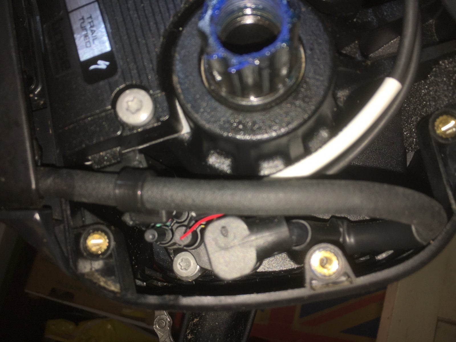

Spent some time cleaning the Levo today and took the opportunity to have a look behind the engine cover. It looked fairly clean and dry in there, its its had a couple of muddy runs, but it looks like the Muddhugger and improvised cover have done their job. The question I have is whether its possible to tell which version of power cable it is?

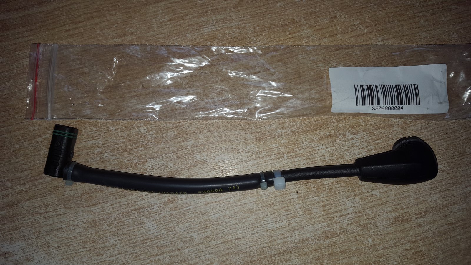

its not the latest revised cable which I think they class as Version 3.Pic of latest version is a bout 25 post up the page.
Looks nice and clean in there though, which is a good sign that the mudhugger is doing it's job.

You might want to check the picture and extract from the service manual I posted above showing how the cable should be installed. Yours is not installed correctly according to that and pressure is being applied to the d section of the motor plug......that is where some have had that d section split open.
