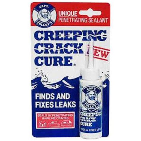

Do you have a creeping crack?
You Need:
It may provide a temporary fix.....
Worked on my Petzl torch

Why not continue to ride your bike? Just charge it outside away from other flammables and maybe store outside as well.
If it is cracked this could lead to dangerous situation, like self ignite regardless it is charging or not.
People can definitely gamble, up to them, I wouldn't.
