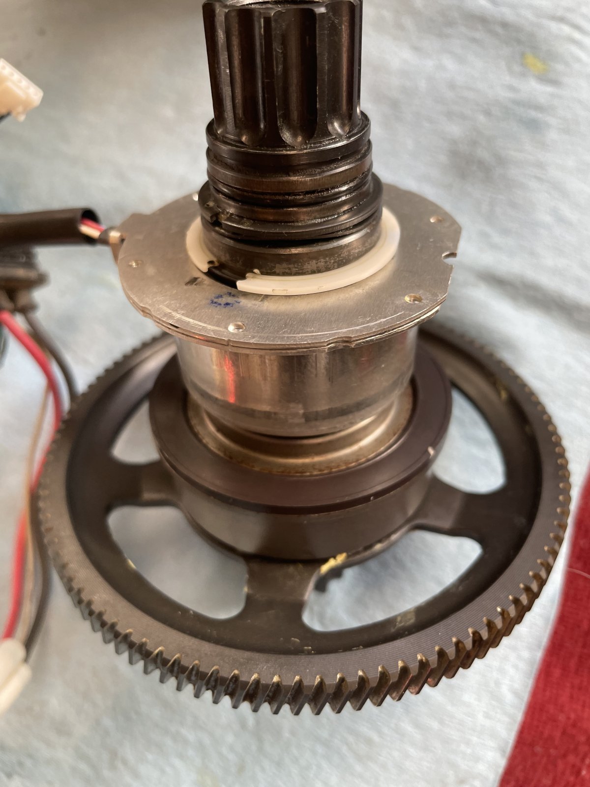

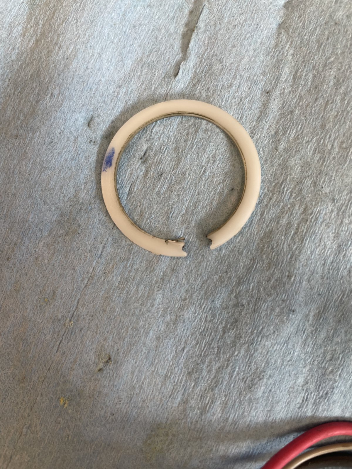

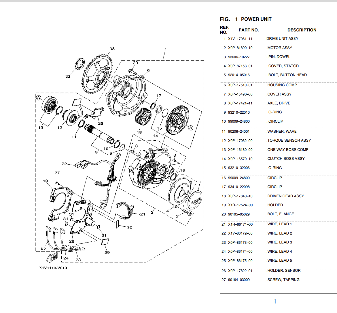

Well I have cleaned everything up , replaced the main crankshaft bearings. Started attempting a dry fit for everything before I lube and seal but I am not positive exactly what kind of washer this is and exactly where it goes. I found it between the torque sensor and outer case but that location doesn’t make any sense to me. It just sits there and really doesn’t do anything. Is this just a spacer of some kind ? Hmmm there is only one other place in could go and that’s in a grove on the crankshaft ? I can’t see it in the parts break down. Looking further…🤔

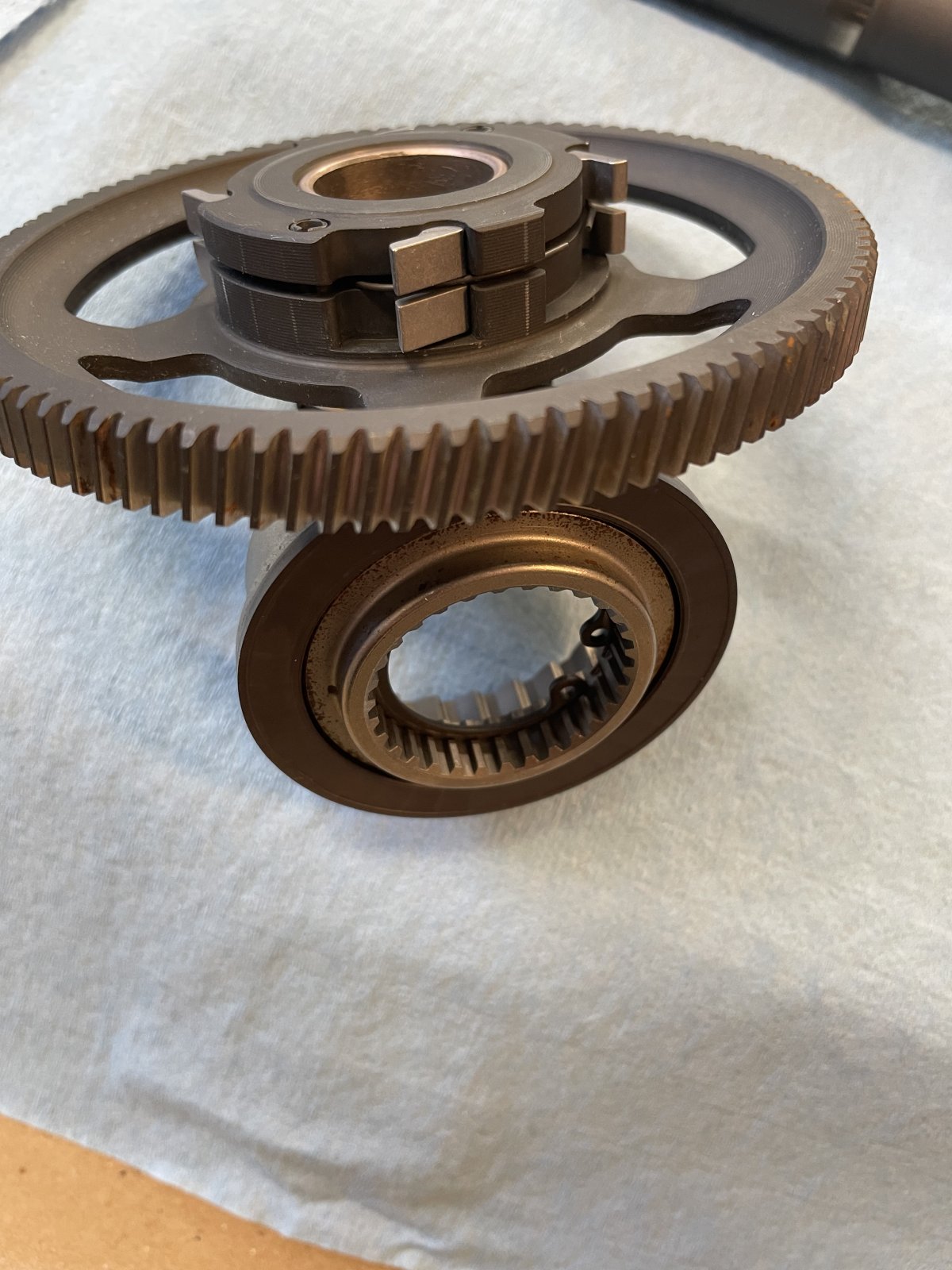

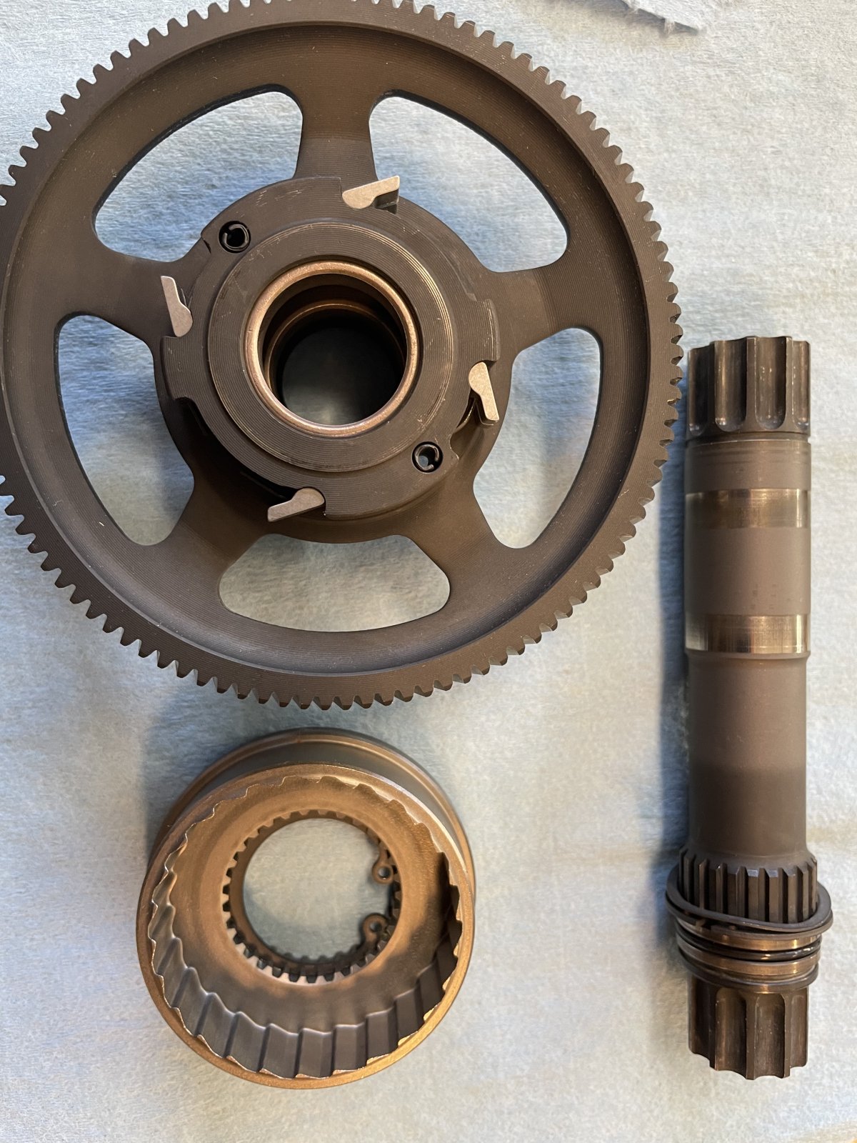

I love when everything is perfectly clean and sparkling!
Here’s the sprag clutch and crank, everything looks good, with next to no wear at all. 👍
I’m getting there slowly 🐢

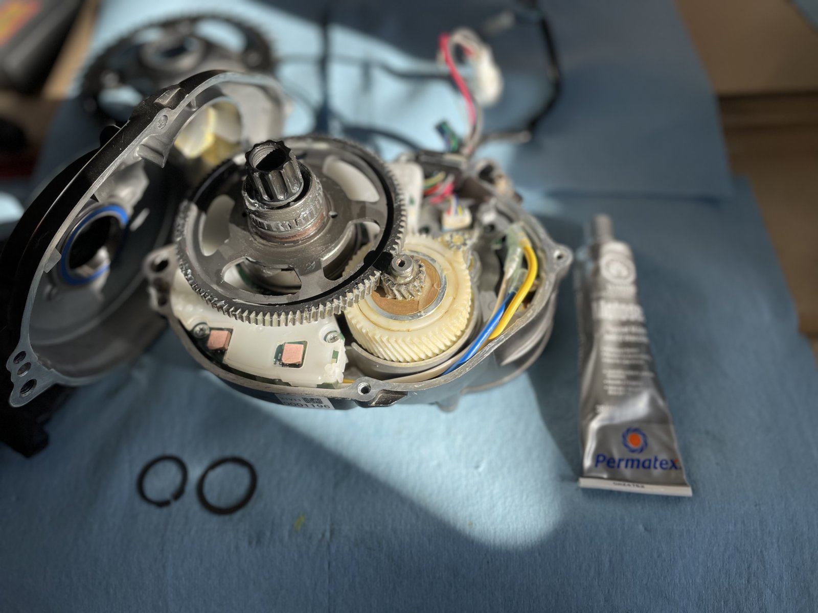

Well it has certainly been a sweet time working on this Yammy motor. No surprises except for the clip that was out of position. It looks quite well built and I like it overall…. until I actually try to kick it over 🧐 IT better work 😬
Here it is almost , just need to apply the sealant and close it up 👍

Assemble it without sealant first and see if it works. If it works, then open it again and apply sealant.

Now here is the kicker about the whole deal, the controller might be just fine ! 🤭 Yeps it might just be a coincidence and the real problem may yet be the torque sensor or motherboard in the motor. 😱” Unfortunately you cannot not swap a motherboard (even if I found one) as they are keyed into the magnetic polarity of the motor. It won’t wake up and essentially will not work. (bearingman)From what I am hearing the fault codes don’t always tell the real story. So I could end up replacing the controller assembly and find out the motor still doesn’t run. Which basically means I have a nice boat anchor since boards are not available nor can be changed. 😑
Yamaha, unlike most motors, do not suffer from the motor angle issue when fitting a new board. (You can't change the board on a Giant "SyncDrive", they use their own proprietary software).
One thing you absolutely should not do though, is take the torque sensor apart! It is calibrated to the little PCB and very sensitive to magnetic influence and shock (dropping one is not good).
The parts list you have attached in this post will not have the correct ECU for your motor unless your bike is the Yamaha YDX-MORO Pro, so be careful.
