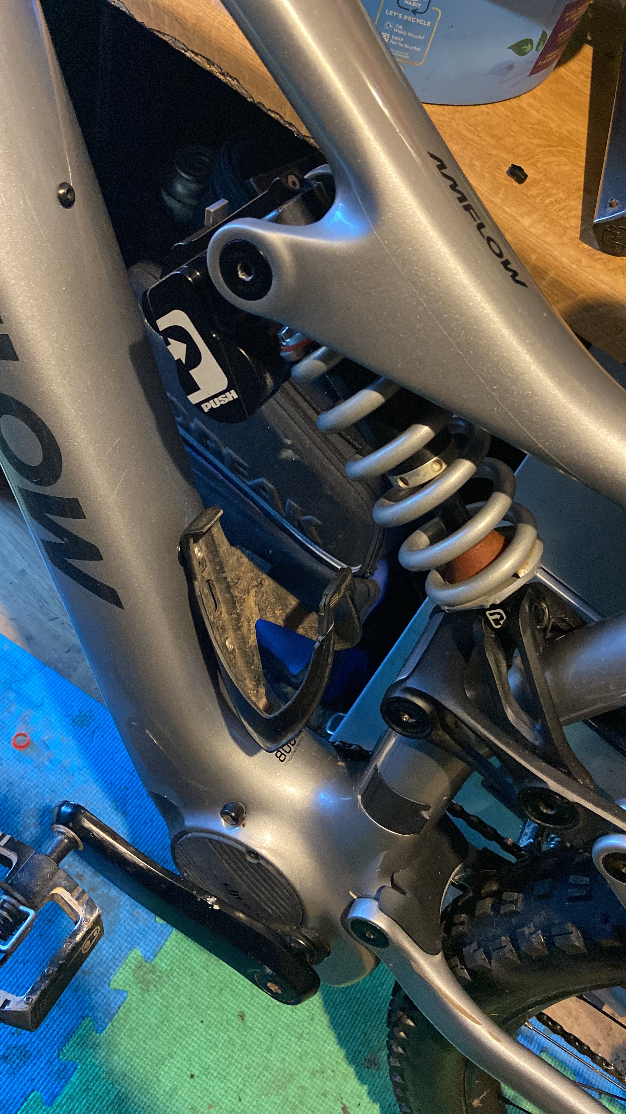

Good review, can you post back once you've dropped the motor and greased the bits, as mine suffers the same and don't know if I could be bothered doing all that if it's for nothing.
OK, so I got rid of the creak.
It wasn’t the engine mount bolts - I tested this by slackening those two bolts off big time then taking the bike for a gentle ride around the block. Creak remained. I then retorqued these back to 20-22nm as per the manual.
I then disassembled and regreased every pivot. Problem solved.
I’m pretty sure the biggest culprit was the rear triangle LHS lower pivot which had loosened off - needs 24nm. But also the yoke/shock shaft junction which cracked at the slightest movement. (The lateral movement of the Spec yoke design under side load is a known thing - eats air shock seals for breakfast - a coil is often a prescribed remedy.)
Not much grease in these pivot faces ex factory… I’d recommend a regrease and re-assembly with blue Loctite as a matter of course.

Wh
It wasn’t the engine mount bolts - I tested this by slackening those two bolts off big time then taking the bike for a ride around the block. Creak remained. I then retorqued these back to 20-22nm as per the manual.
I’m pretty sure the biggest culprit was the main triangle LHS lower pivot which had loosened off - needs 24nm. But also the yoke/shock shaft junction which cracked at the slightest movement. (The lateral movement of the Spec yoke design under side load is a known thing - eats air shock seals for breakfast - a coil is often a prescribed remedy.)
What grease did you use?
I noticed when I changed the flip chip over it had a sparing amount of white grease.

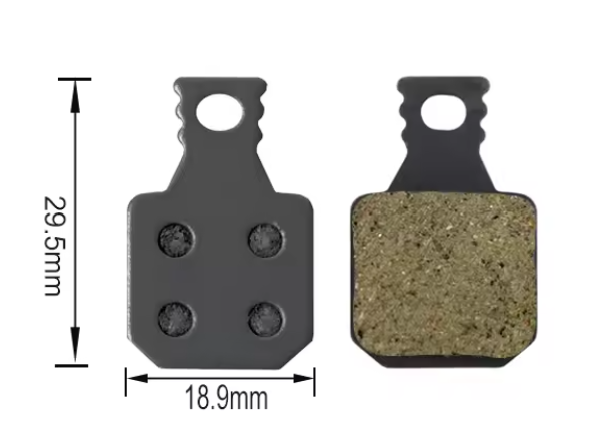

Anyone know what the stock material of the brake pads are on the carbon PL? Mine sound like shit, the rear squeals and the front is even worse.
I didn't want to replace them until they wore out but after nearly 500ks I've just about had enough, no need for a bell on the trails, everyone can hear me coming from miles away.

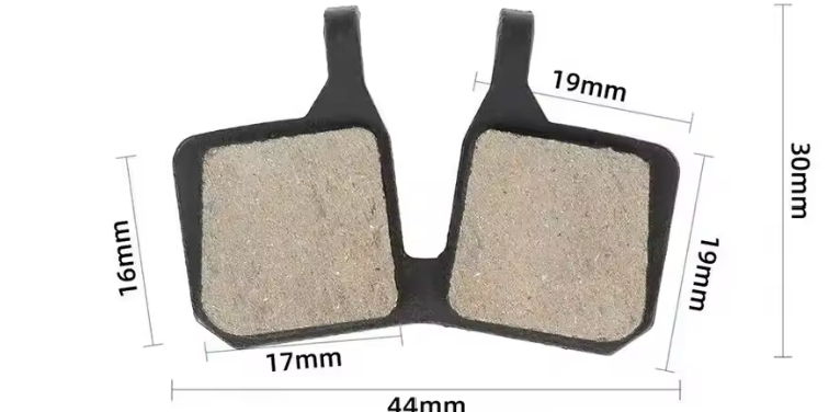

Well I replaced my pads today and I should have bought the single pads, I didn't and bought the stock pads and what a pain in the arse they are to swap over. What a shit house design.
Astro66
Golden Boy
May 24, 2024
574
1,036
Sydney Australia
What are ‘single’ pads?
Single
Not single
iXi
Feb 17, 2019
502
405
Brisbane
How many kms ?
They still had tons of meat but the rear was squealing and the front howling, swapped to a different manufacturer and problem persists so not sure what it could be. First time I've had magura brakes, always run sram in the past.
Maybe it's my braking style, I'm always lightly on the brakes on decents and that's when it starts squealing, at moderate to hard braking no sound.
I always ran the Aliexpress Resin pads on my shimano brakes. Whilst they wore out quicker. They had good bite and were always quiet. I'm going to try the same on the Maguras.

I've just changed my MT7 pads for aftermarket 'not single' pads.
I have spent too much time trying to silence the standard pads so finally gave in and changed them after only 250mls. Despite the pads and discs still looking like new they where making a loud bird tweet sound while riding brakes off, and a loud Turkey gobble sound and lever vibration under braking.
I changed to 'Uber Brakes' emtb not single pads and so far they've been silent and have more bite than the originals. Just hope they stay silent!

BTW - I got rid of the crack/creak - as reported elsewhere above - by greasing and retensioning all the pivot bolts.
