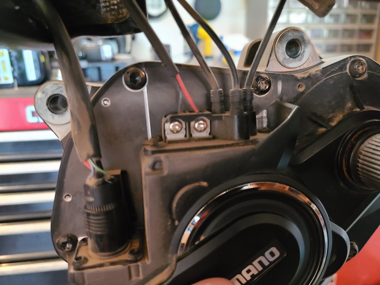

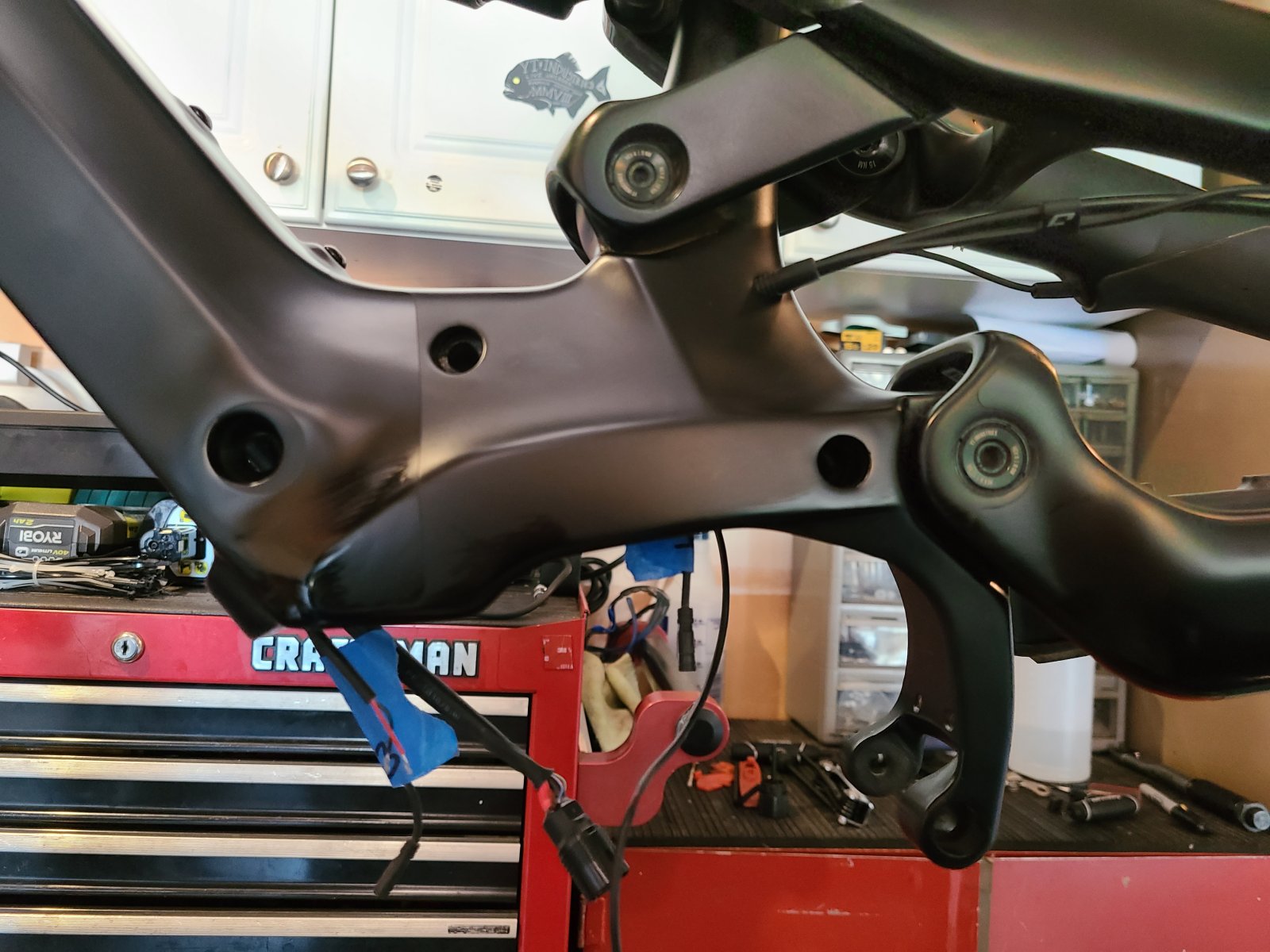

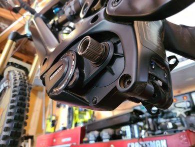

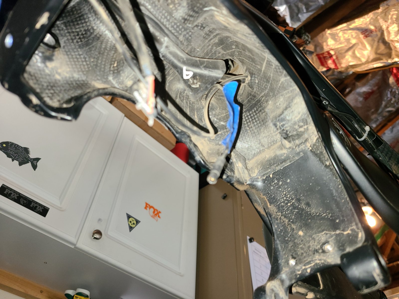

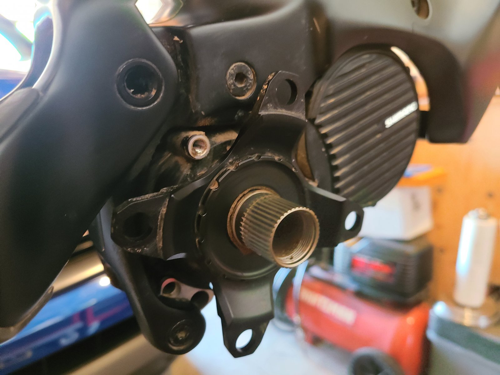

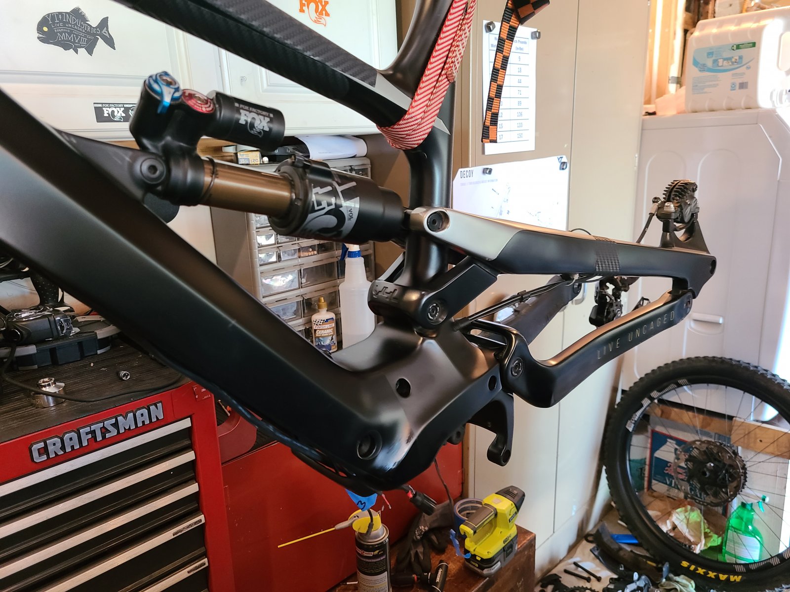

Alright dropped the motor yesterday. It was pretty easy with the right tools.
I have to say it was not very dirty. Maybe a bit dusty but that's all. Hardest
part was the main connector, that was a pain in the butt. 20200517_151445.jpg 20200517_151438.jpg 20200517_155810.jpg 20200517_154925.jpg 20200517_153122.jpg 20200517_155819.jpg

I rode my decoy through rain and hail storms a few times when I got caught out there thinking I could get a ride in before the storm. I pulled the motor cover and battery and there wasn't any mud or debris in the motor area. So, ride in the winter. You will be fine.
One thing I did notice was the crude that got tossed into the linkage of the suspension riding in winter. I know they are sealed bearings, but it was a lot. I have modified a front mud fender to fit there and block most of it. Put that with my mudhugger and it's ugly, but it's does not collect mud in the winter

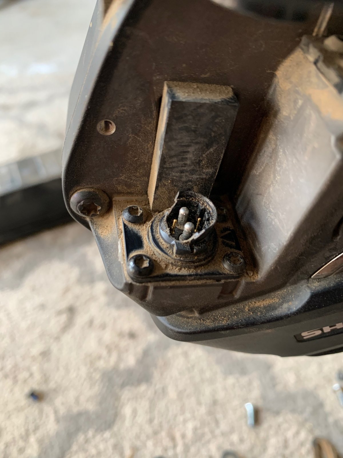

Well, bad news. The motor dropped too quickly and it broke the power connector. The plastic broke off into the harness plug. Any ideas if this is fixable? There are 4 screws around this plug, so seems like maybe a swappable component? Anyone have an idea?
9,190
No idea, I think best to contact Shimano - if you are in the UK contact Madison and they should be a able to tell you.

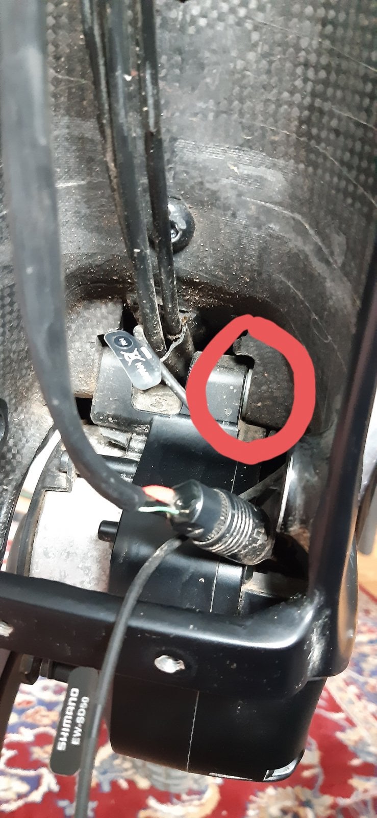

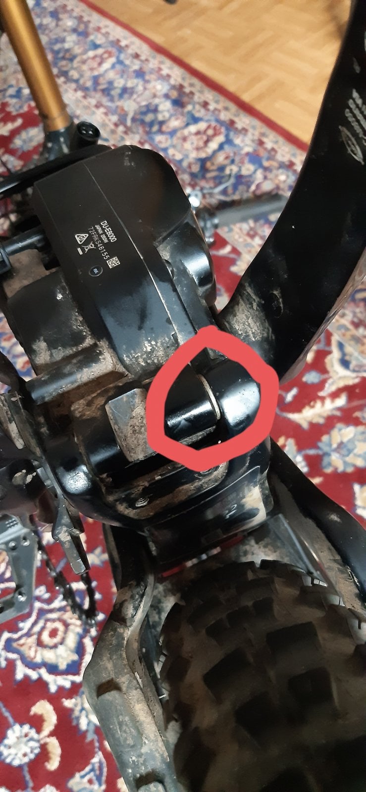

I finally replaced my speed sensor today and had to drop the motor to get to the cable. A few findings:
1) It is doable;)
2) There was no dirt or dampness at all under the frame. So, even though the constructions looks a bit "airy", it seems to be holding off the bad stuff.
3) The cables are really short, especially the main connector. So, yes, you need an extra pair of hands to hold the motor when you remove the last screw. Then you need to unplug the main connector. For me, it was enough to just drop the motor a bit, so I was able to replace the speed sensor.
4) To avoid the problem with the main power connector, I think you could actually unplug it from the front before you drop the motor. I saw it too late, but am pretty sure that it works.
