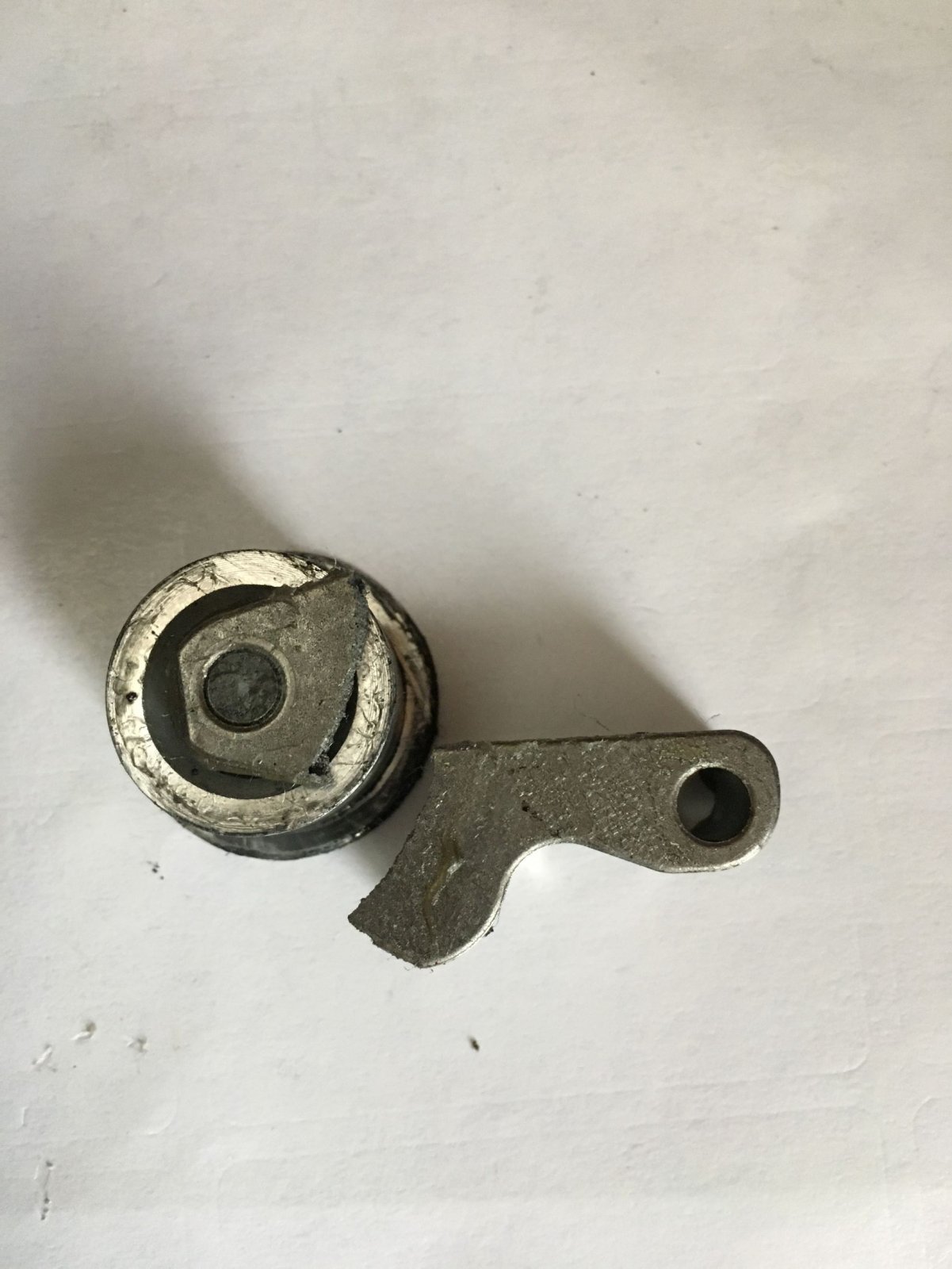

As the owner of Performance Line Bearings I repair more than my fair share of ebike motors. We repair most makes of motors, including Brose.
What we have noticed is that each make of motor has its weak point, but it is usually only one weak point! Bosch, it's the lack of water tight seals (Now addressed on the Gen 3 motor). Yamaha, it's the lack of seals and a noisy drive gear. But with Brose there seems to be 5 main weak points!
1, Brose fitted a lovely water tight seal to cover the right-hand crank bearing, but water still enters the left-hand bearing.
2, Water regularly enters the needle roller bearing between the crankshaft and the sprocket carrier. (This is normally when you hear of people complaining that their pedals are stiff to turn backwards) Sadly, if this is not addressed quickly, it tends to destroy the bearing surface on the crankshaft.
3, There are two clutch bearings inside the motor called sprag bearings, one works when you pedal, one works when the motor assists. The bearings Brose use have plastic cages to keep the sprags in place. These plastic cages crack and the bearing starts to fail. (This normally manifests itself by a slipping sensation through the pedals and sometimes noise and notchy feeling through the pedals.
4, Drive belt tensioner failure. This is where the drive belt tensioner actually snaps, shortly followed by the belt stripping. (Felt as instant failure and loss of drive)
5, Drive belt stripping. (Normally felt as a soft bumping or jumping sensation through the pedals, shortly before all drive is lost).

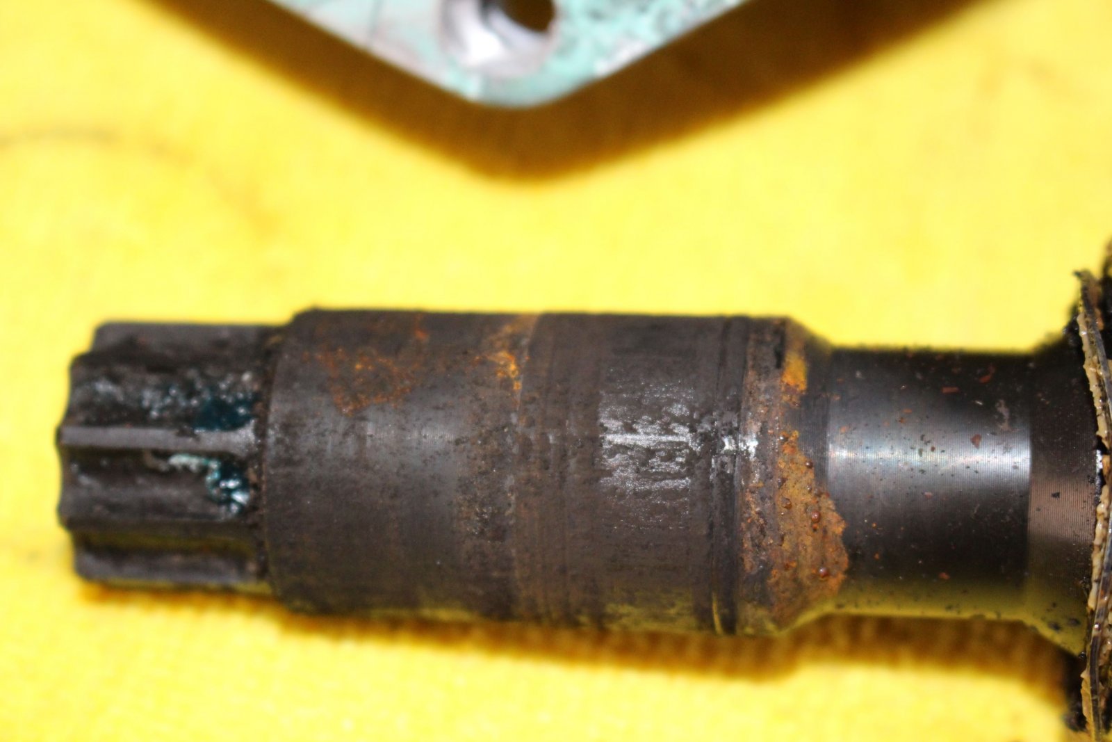

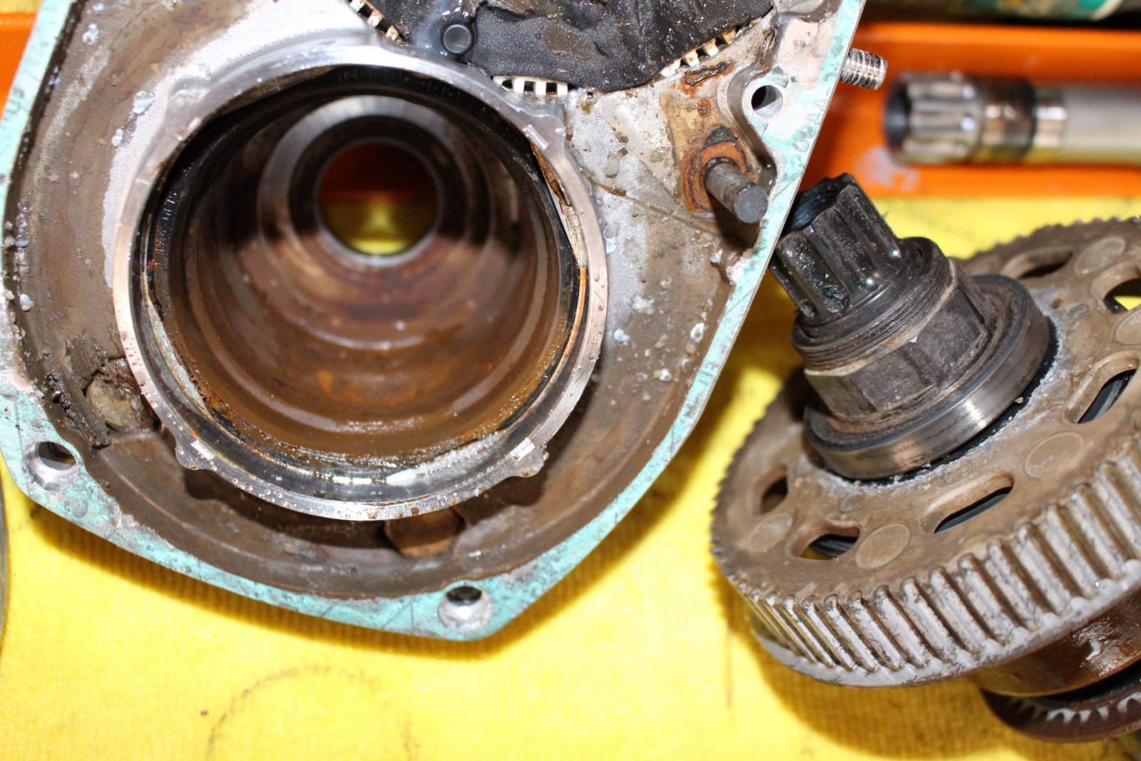

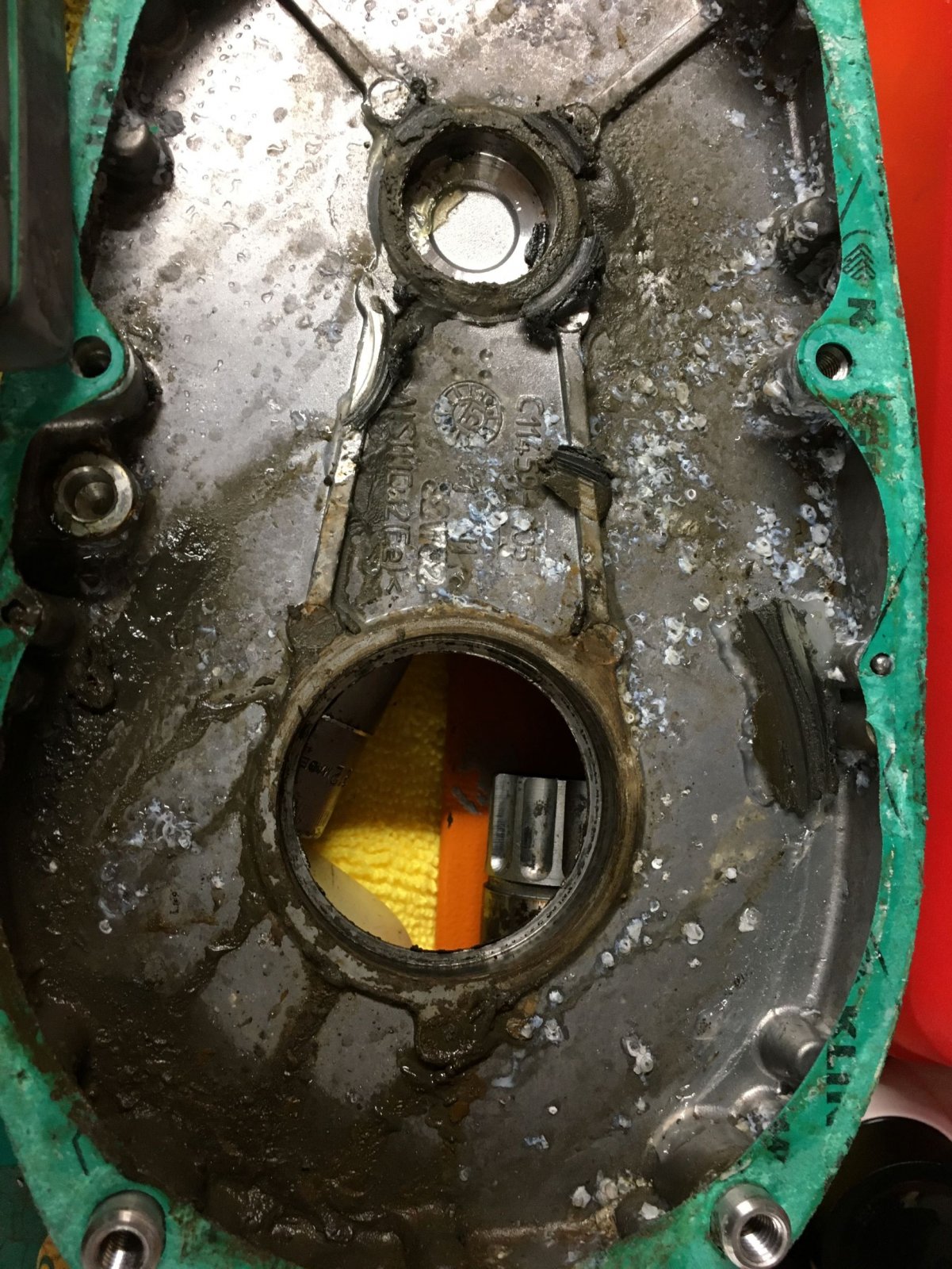

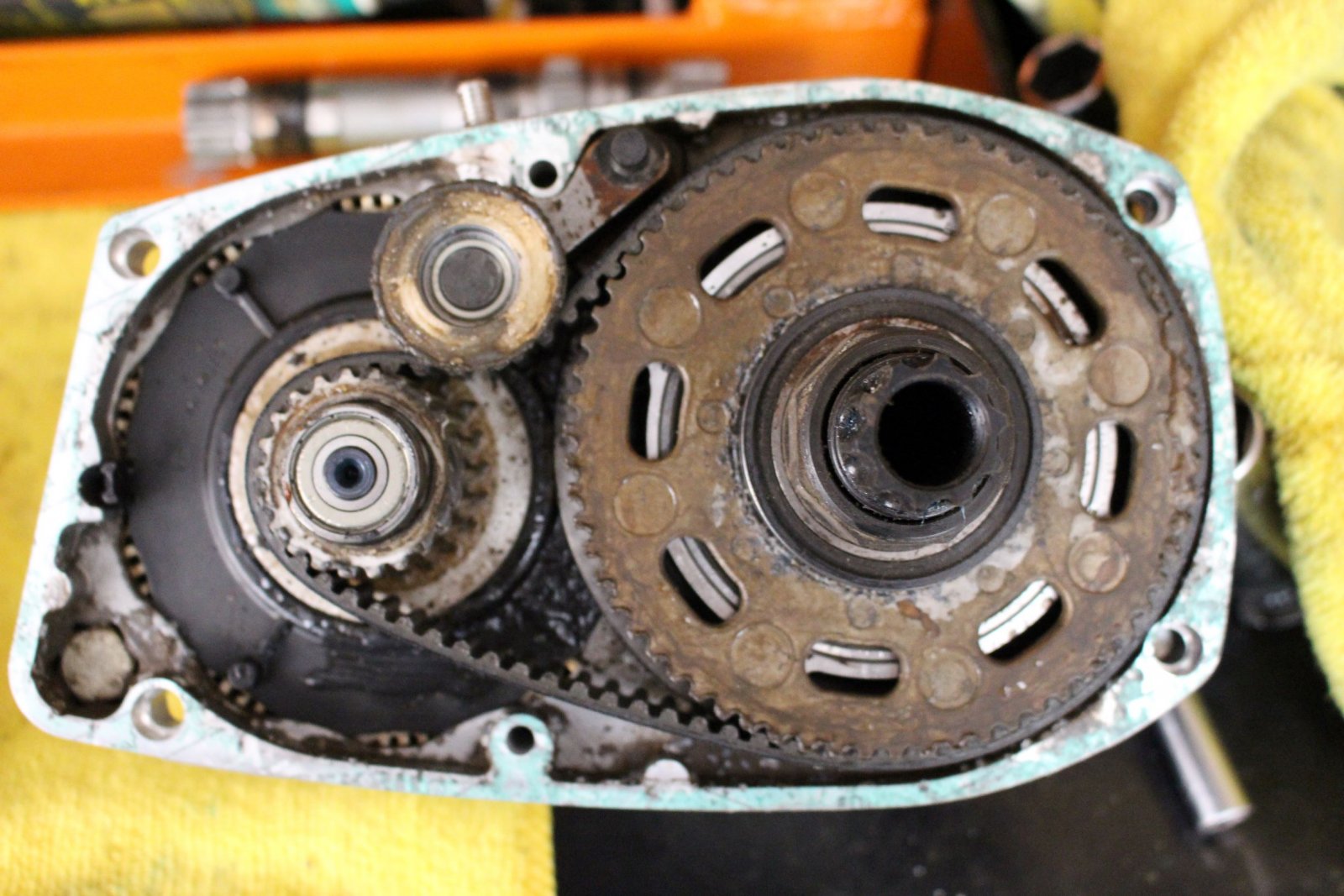

Bearing Man, How many of the 5 Brose issues do you have fixes for? Are any replacement parts available, either from Brose or aftermarket? Do you think there are solutions for any of the issues that could be implemented by users or LBSs once out of warranty? How big do you think the repair business for these motors will be in the near future? I am interested in this end of it myself...on a small,out of the garage for the local community scale!
Bearing Man
Ebike Motor Centre
Sep 29, 2018
981
2,352
This is a big question. Please don't shoot the messenger because to be honest, I love the Brose motor to ride, I love the smooth quiet power etc. But what I've got to say, is not good.
Fortunately, I do have fixes for all of the issues, but only upgrades for a couple. Brose have made the motor particularly difficult for the average user to do anything with it. Even a simple belt change requires a very expensive torque driver. I think that these motors will die out very quickly. They are deliberately and particularly difficult to repair successfully, no parts are available, and most parts are a fortune to manufacture in small numbers. The other main problem with all the pre S-Mag motors, is the electrolysis and corrosion issues, in a few years’ time they will just fall to pieces anyway.

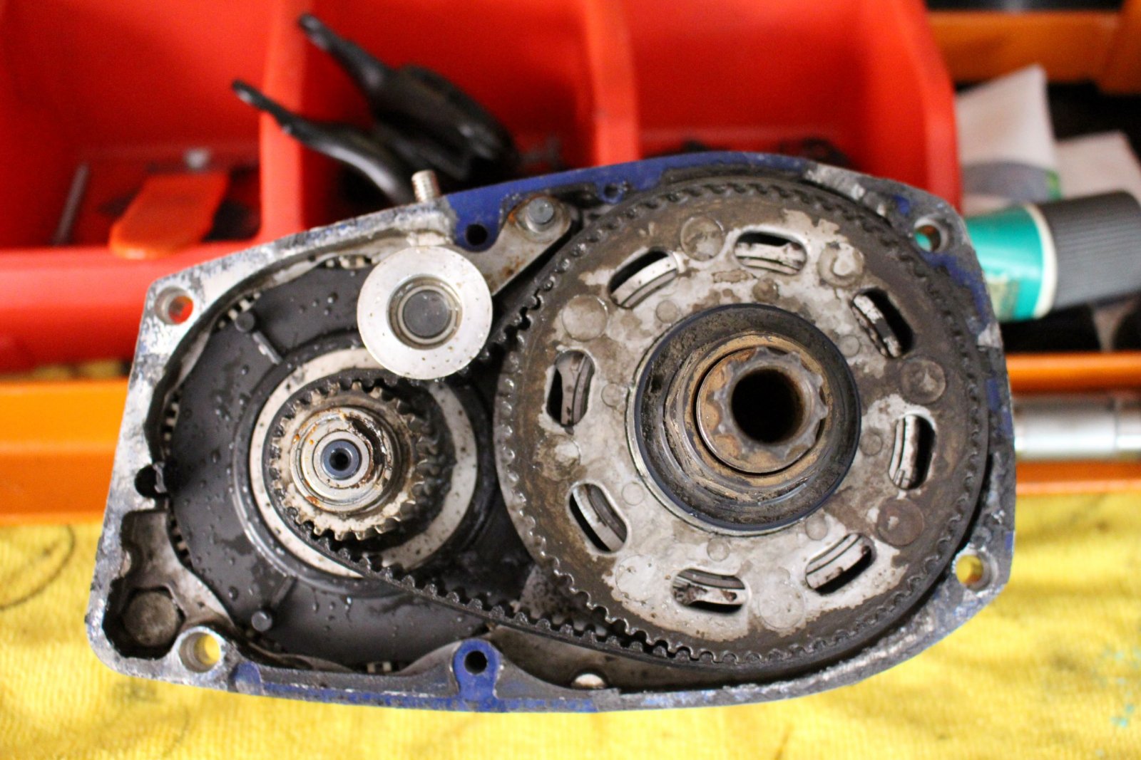

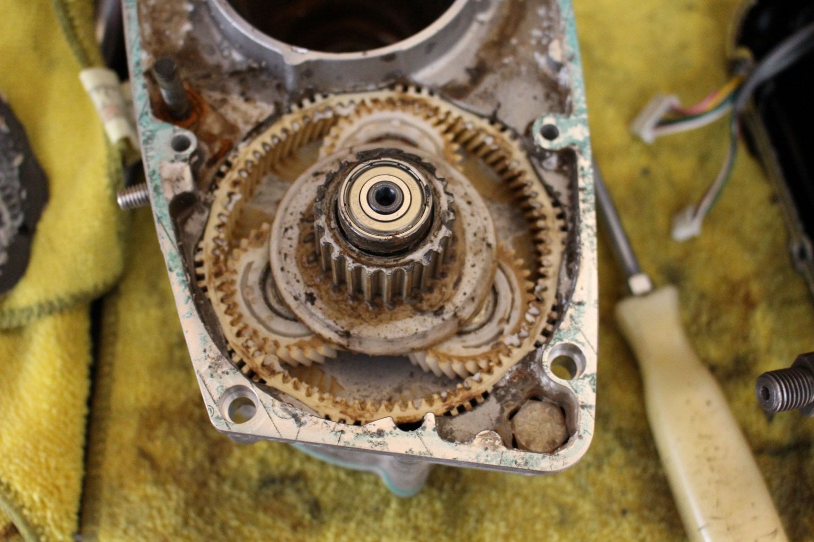

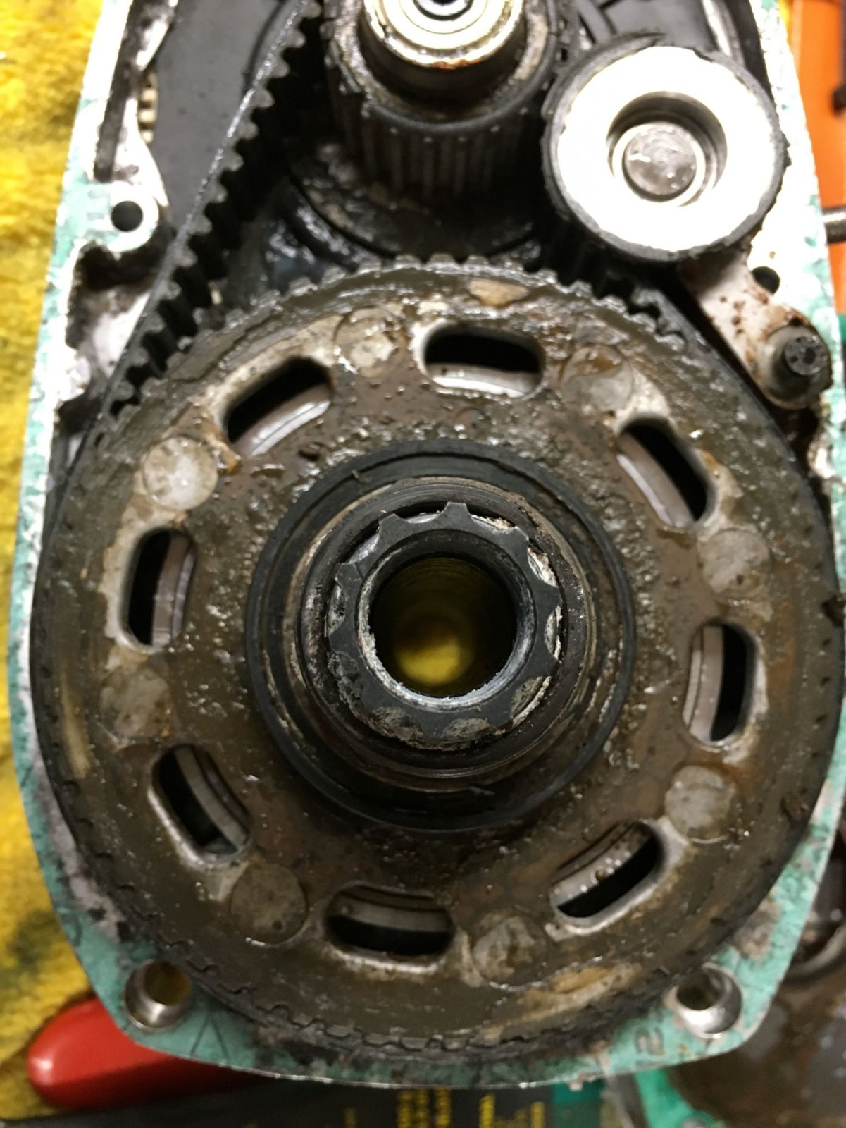

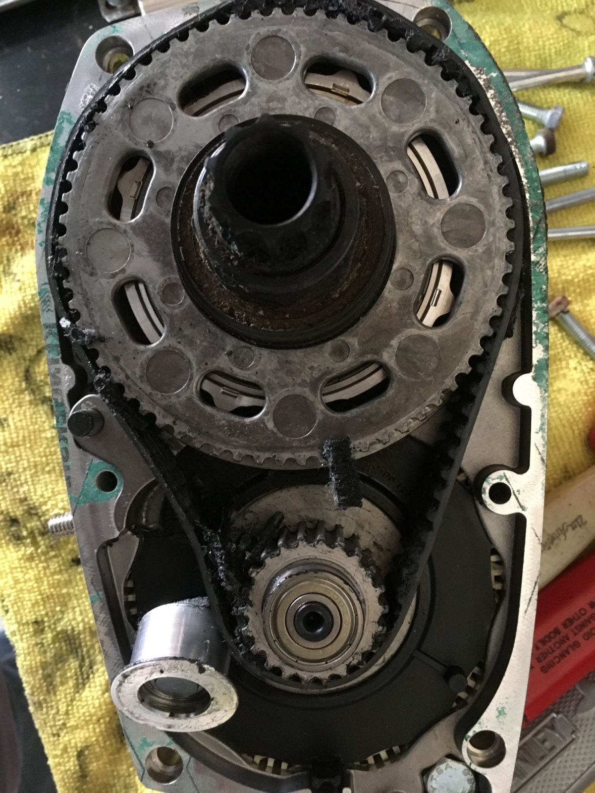

Below are some pictures from just a few of the Brose motors we have repaired this week! They are destroyed. Nearly every motor I get has been ridden to destruction! I don't know why it's so hard to have your motor sorted out before it's wrecked! Please, if your motor is out of warranty, drop the chain off the front sprocket and turn your pedals back and forth, if the crank is noisy or you can feel drag / stiffness of the crank, get it fixed! (NO, DON'T PUT OIL ON THE BEARINGS:eek:).
We are building as big a stock of new and used parts as possible so if you do get a problem, just email me what ever you need. If anyone out there can refurbish hardened crankshafts for less than £200, give me a shout.
Anyway, enjoy the pictures, if any one wants more pics of wrecked Brose motors, I have hundreds and hundreds of them.

From the look of those pictures the only thing I think you could do is move to a place where it never rains and never wash your bike!
Good Idea's! I use waterless wash now and have modified mudguards to deflect water away from the motor.
I'm sure there are other idea's out there to prevent water getting to the motor which might be shared before next winter.
