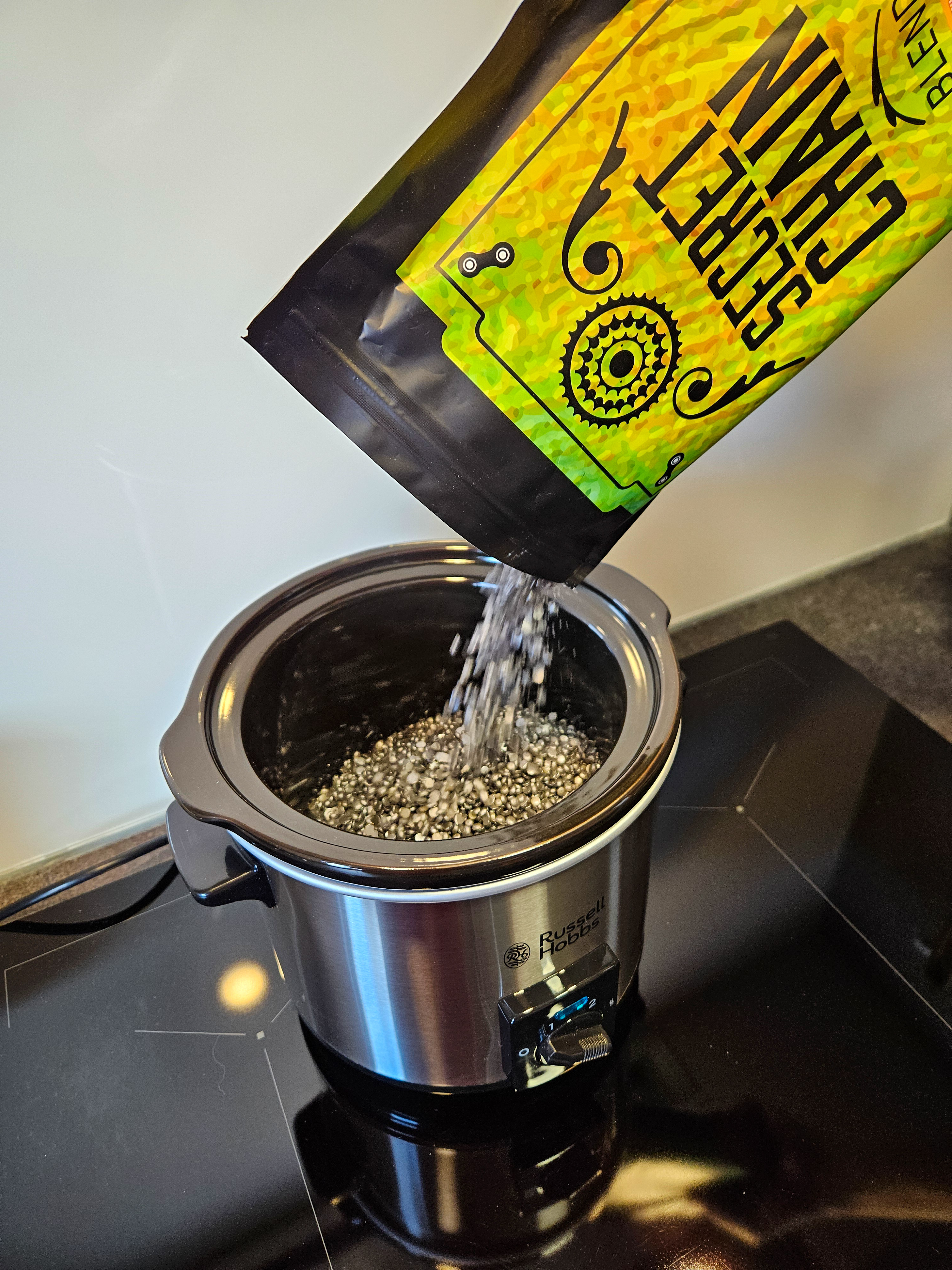

Has anyone else used "DeOxit" by Caig? I've been using it on tons of things including bike chain and hubs since 1998. It's pretty expensive and actually made for electrical contacts, but what it does to moving metal parts seems to go a bit beyond normal lubricants. I rode 10K KM on my old ebike using nothing but. Don't get it on your brake discs otherwise they'll never work as well again.

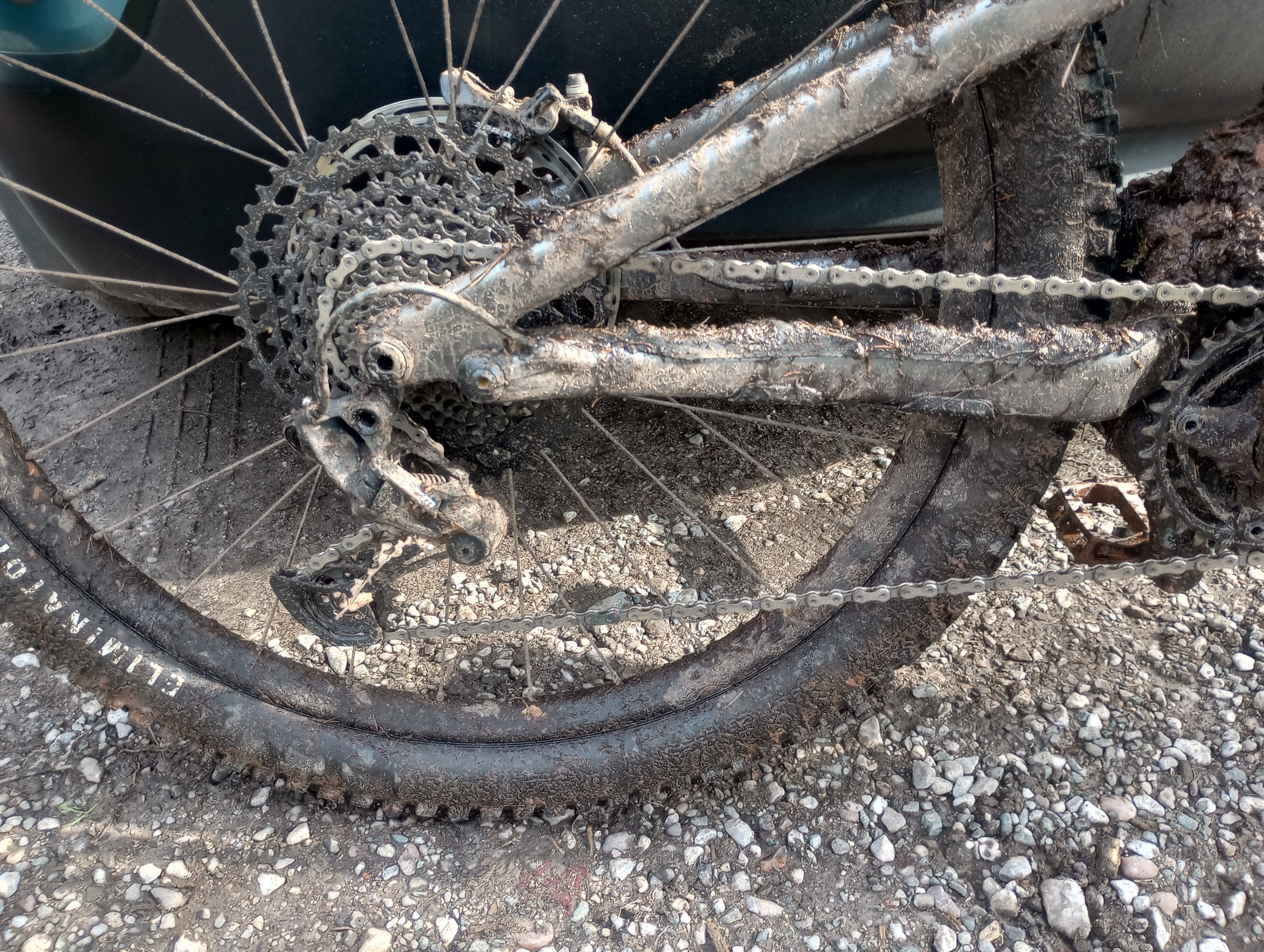

what are you doing in between rides? Surely mud/sand etc is still getting into the chain, how are you getting that out without removing the wax?
I'm wondering the same. Here's my bike after a typical weekend ride just now. It's usually filthy, and the drivetrain is full of mud / sand / pine needles etc. As well as cleaning the bike, I spend 5-10 mins spraying the drivetrain with Peaty's Drivetrain Cleaner, brushing it with a special brush, and picking all the bits of trees / grass etc out. When the bike is dry, I re-lube with some Peaty's 'All Weather' Link Lube... and it looks like new again.
With wax, I guess the first plus is that a lot of the crap from the forest won't stick to it in the first place? Can I just then give it a light hosing, and not worry about the drivetrain? We've just moved into Spring, and in a few weeks the trails will hopefully start to dry out a bit. Then, the bike will be 'dusty' rather than dirty. Even when the bike looks clean, I'd still spend the same 5-10 mins on the drivetrain - in case there's dust / sand in amongst it.
I'd happily buy a second chain, a cheap slow cooker and some wax if it meant I could save some time after rides!
I saw my mates drivetrain yesterday which he does same approach as you and with same products. Have to say his chain looked as good as mine before we went riding. I guess to some extent with rewaxing you’re doing a big initial effort in a controlled environment instead of lots of smaller post ride-efforts.

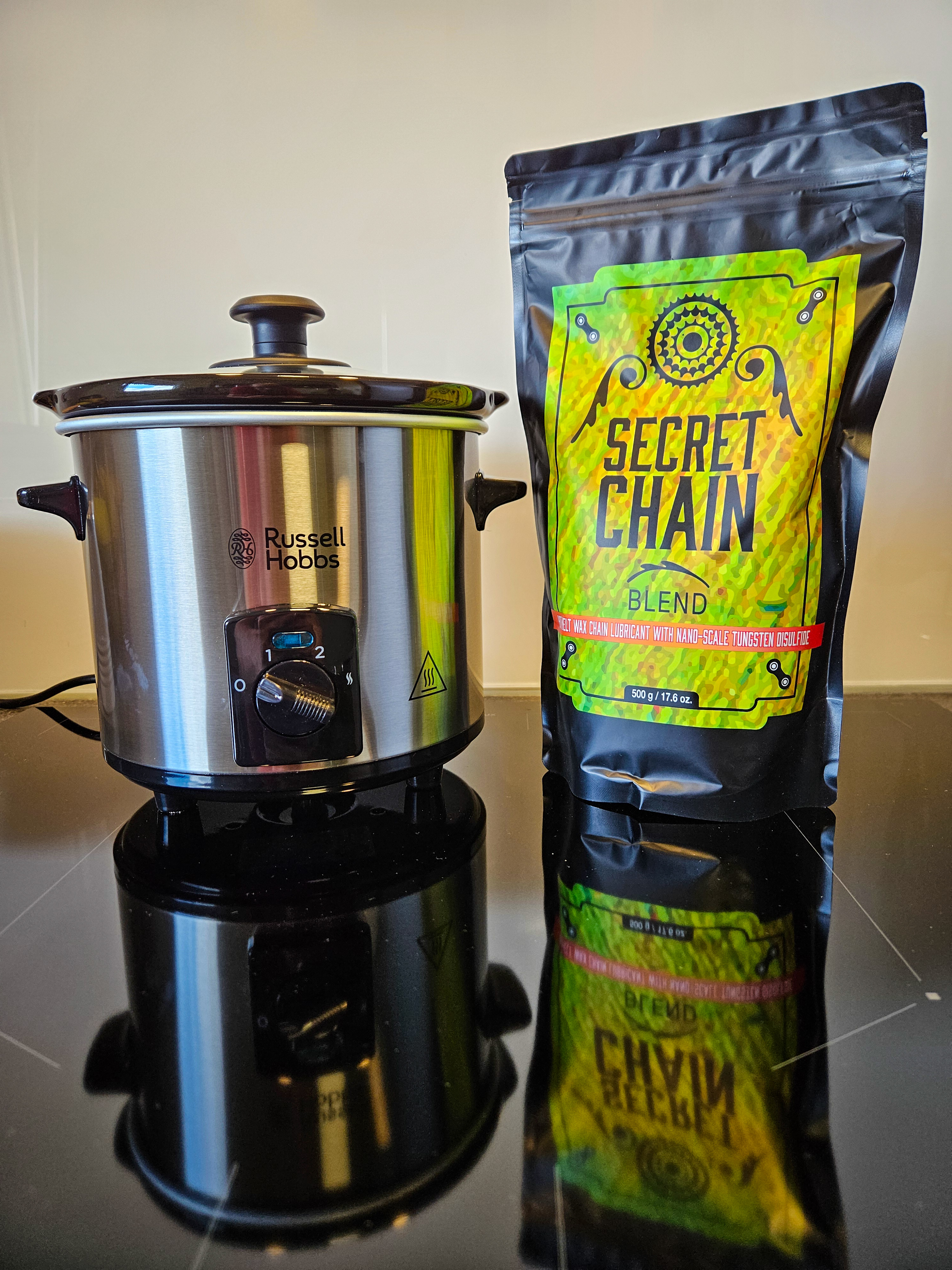

I got the Silca secret blend because it came in a sous vide plastic bag, so i didn’t need a slow cooker At least during the initial trial. I have now got myself a slow cooker just to make it easily manageable in the garage, but it isn’t a must-have.

I went with YBN chains on my new build. I purchased two chains from Molten speed wax and chose the cleaned and pre-waxed option on the new chain. The upcharge is like 40 but makes it easy to get started and they included a puck of wax for free with each chain so I havent had to purchase wax at all since the first chain I used on my old bike. If starting out you would need to purchase some wax to fill the cooker to an acceptable level. So far I have 1000miles on the chains and there is no sign of wear on the drivetrain and I use a Park chain measuring tool. We dont ride in the mud much here in central NC because of the clay so there is that to consider.

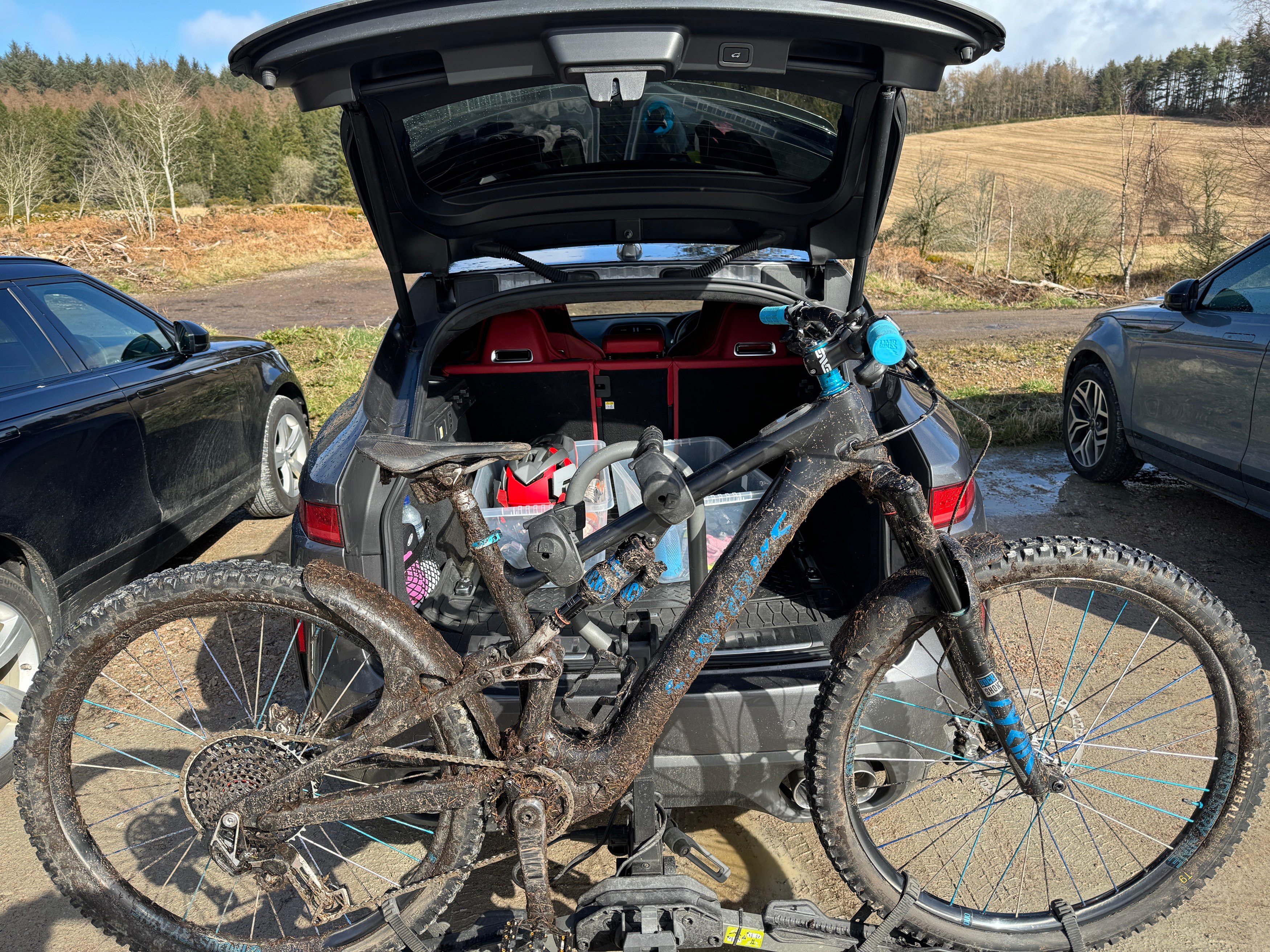

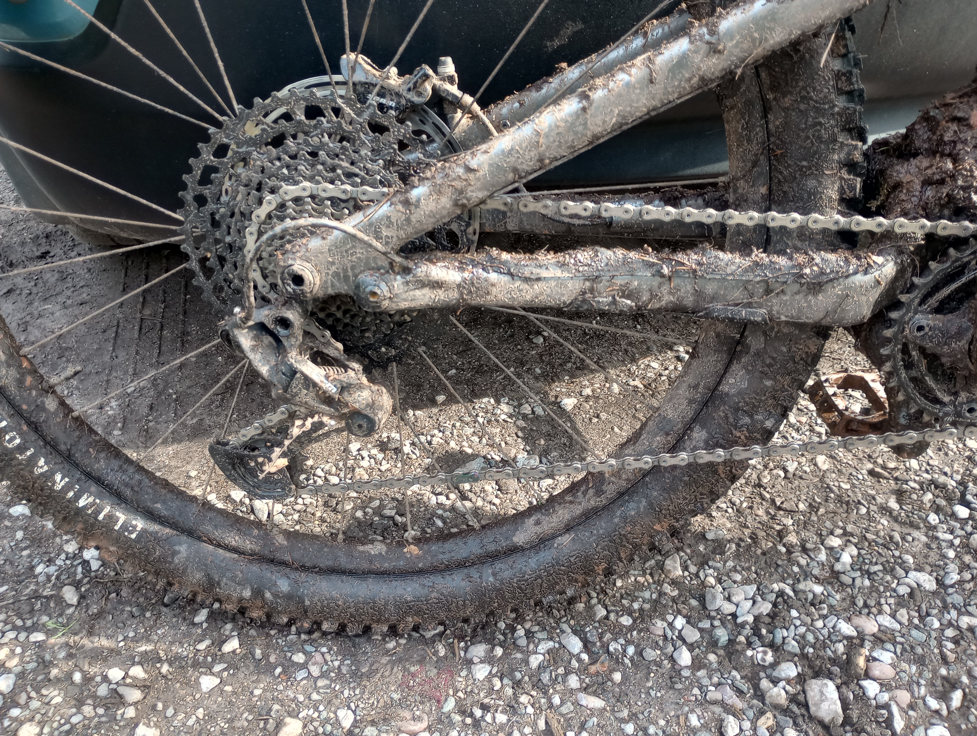

Here's a photo of my bike after a typical ride at the weekend. Fairly short - just over an hour, and about 12 miles.
If you zoom in, you can see piles of pine needles all over the bike, and tonnes of dirt too. The cassette and chain ring are covered.
1. If I use wax on this, will my drivetrain still be clean when my bike looks like this?
2. I go home and hose the bike, put some MucOff on it, and wash it off (as well as cleaning my drivetrain). Can I still wash the bike every ride (cold water) and not disturb the wax? As my bike lives in the house, it has to be clean!
3. People keep mentioning 250 - 300 miles between waxing. Based on my riding, am I likely to get 250-300 miles between waxing? I'm usually 12-20 miles per ride.
I'm happy to buy a cheap slow cooker, wax and even an electric air duster to make this work if it's going to save me time every weekend... and also extend the life of my components.
1. If I use wax on this, will my drivetrain still be clean when my bike looks like this? It may be dirty, but the dirt will wash off with a hose.
2. I go home and hose the bike, put some MucOff on it, and wash it off (as well as cleaning my drivetrain). Can I still wash the bike every ride (cold water) and not disturb the wax? As my bike lives in the house, it has to be clean! You can was the bike fine. I even take a small brush and clean the dirt out of the chain and cassette.
3. People keep mentioning 250 - 300 miles between waxing. Based on my riding, am I likely to get 250-300 miles between waxing? I'm usually 12-20 miles per ride. I rewax every 250 miles regardless. It also depends on the chain. My shimano deore chains go 250 no problem but the sram NX chain barely made it 200 before getting squeeky.

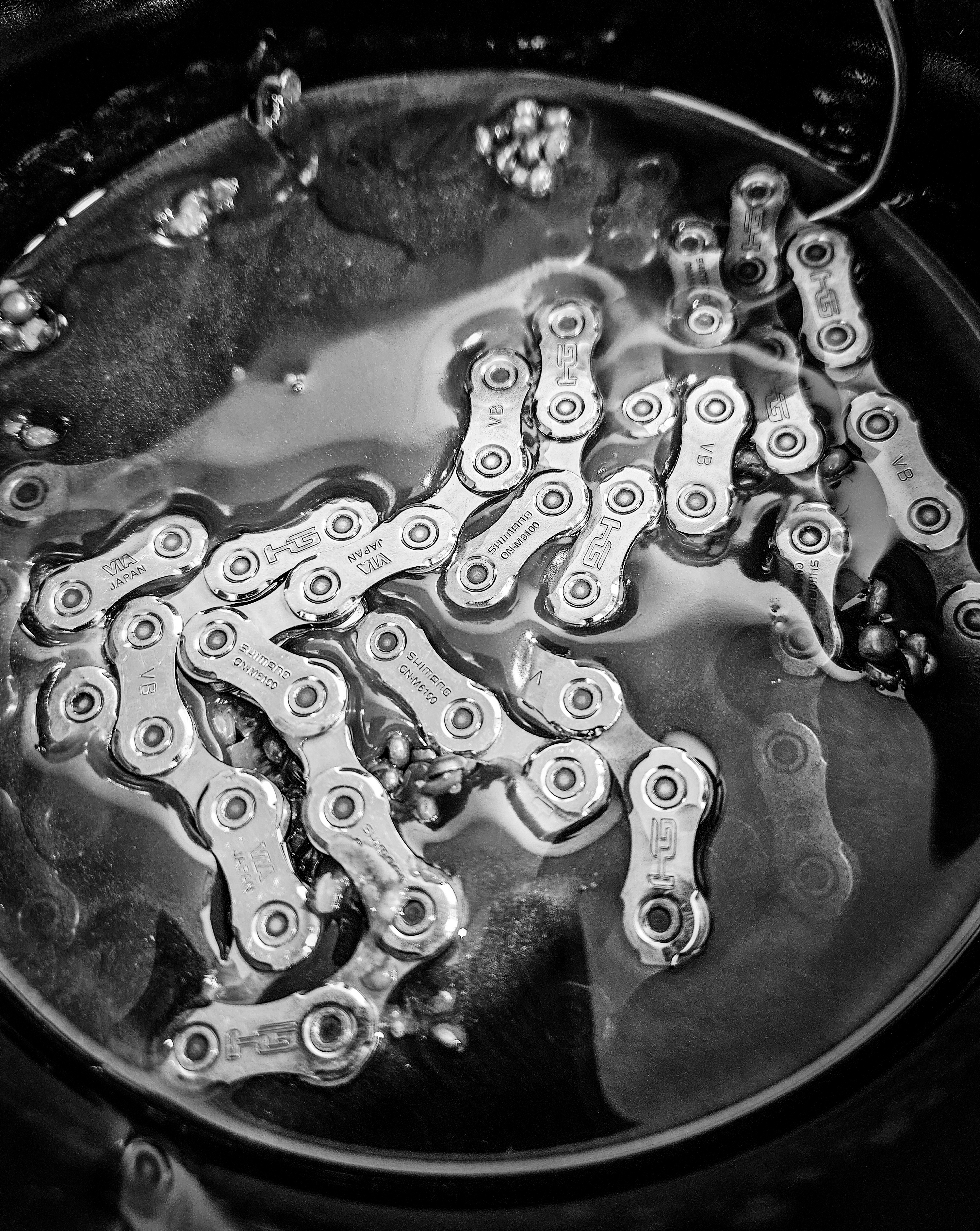

You don’t need to degrease it?
Silca makes it so easy, just about to re-wax.
No need to degrease if there isn’t any oil on it. To clean my chains prior to rewaxing, I fill a plastic bottle half full of hot soapy water put the chain in the bottle and shake it. Dump out the dirty water and refill the bottle with straight hot water and shake it some more. Repeat until the water comes out clean. Then dry the chain with a clean shop towel and let dry out in the sun. I rewax when it’s completely dry.
TheMirrorVision
Sep 29, 2024
26
28
They actually do recommend using boiling water to strip the old contaminated wax off the chain before re-waxing. Otherwise you are increasing how contaminated your remaining pot of wax is with each re-wax cycle. It’s very easy to do with a kettle outside and takes <5 minutes.
