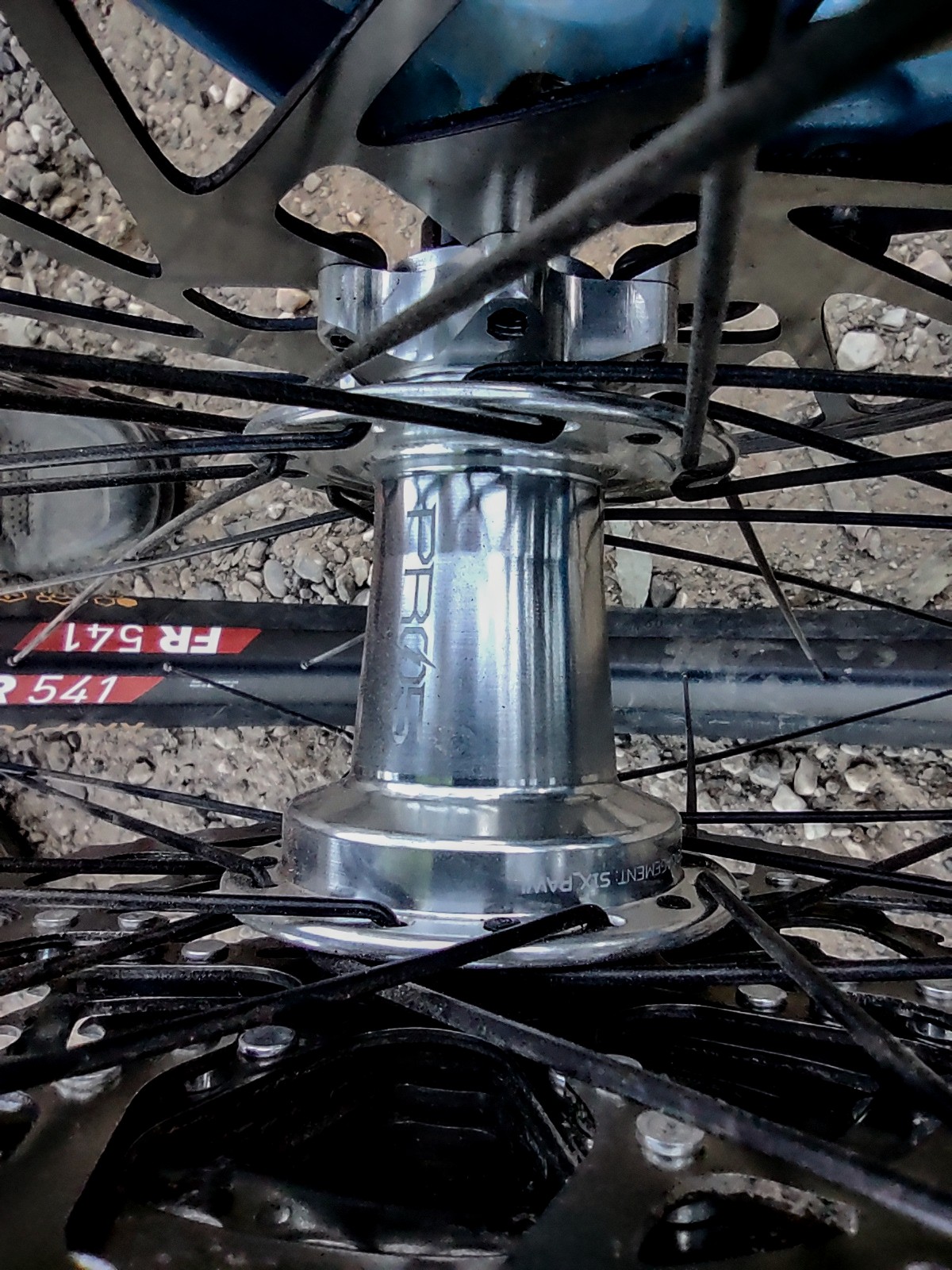

Just a little update to this thread.
I've just got the new rear wheel in, and concerning the 54/108 points of engagement.
It appears to be confined to the freehub only. So if you have bought a standard pro5 rear wheel, just replacing the freehub thats 108 POE specific, turns it standard to Ebike.
On the freehub seal. it gives the info specific to its use.So on the one I have, its got 'HG/XDR freehub. 54 POE', and on the hub body itself it says; '108 maximum points of engagement. six pawl' Which just really tells you its a one fits all hub body, with a use specific freehub.
Other than that its quite a nice looking hub. Haven't weighed it but it seems fairly light.
Tis all.:)

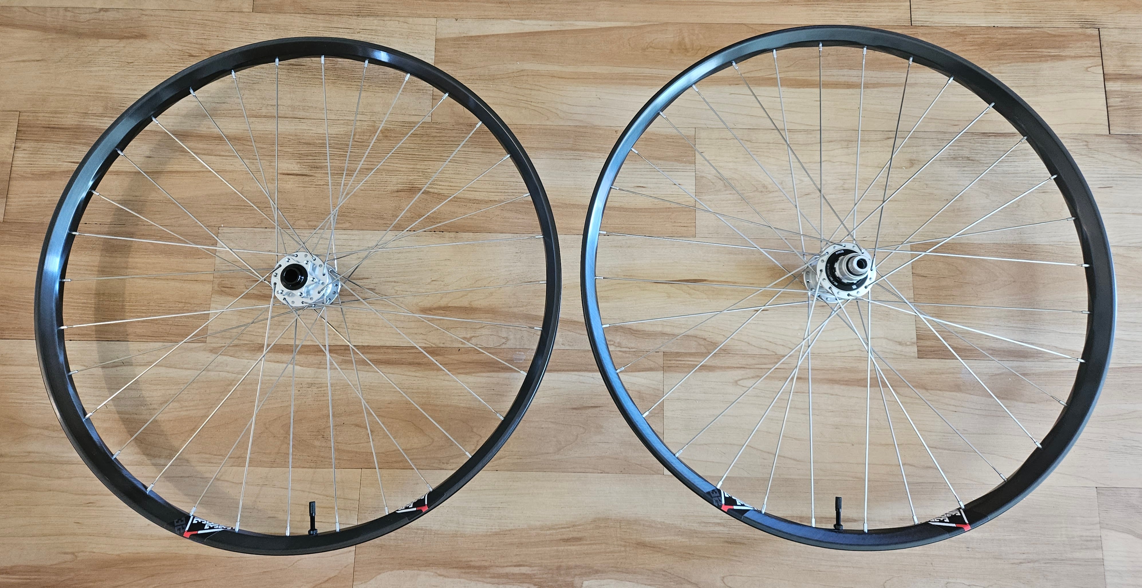

I have the Hope Fortus 30 wheelset on my Moterra, with the ebike specific 54t rear hub. They're a little on the heavy side with the 29" x 30int rear coming in a 1.36kg but I did opt for the steel HG drive (so I can update to Shimano Linkglide at some point) and the front at 1.18kg. Both wheels are 6 bolt (you can't get factory centre-lock ebike MTB rear Pro 5 hubs...as although some places offer it, the internal dust seals aren't the same as the centre-lock road hub, afaik). Really happy with the wheelset and the rear hub makes a great noise when coasting downhill ... especially at speed. Think I paid an extra tenner (might have been a bit more) for the Rockshox torque caps fitted to the front hub. Saying that though, compared to the awful wheels that the Cannondale came with (MT400 hubs and 25int rims) anything would be step up.

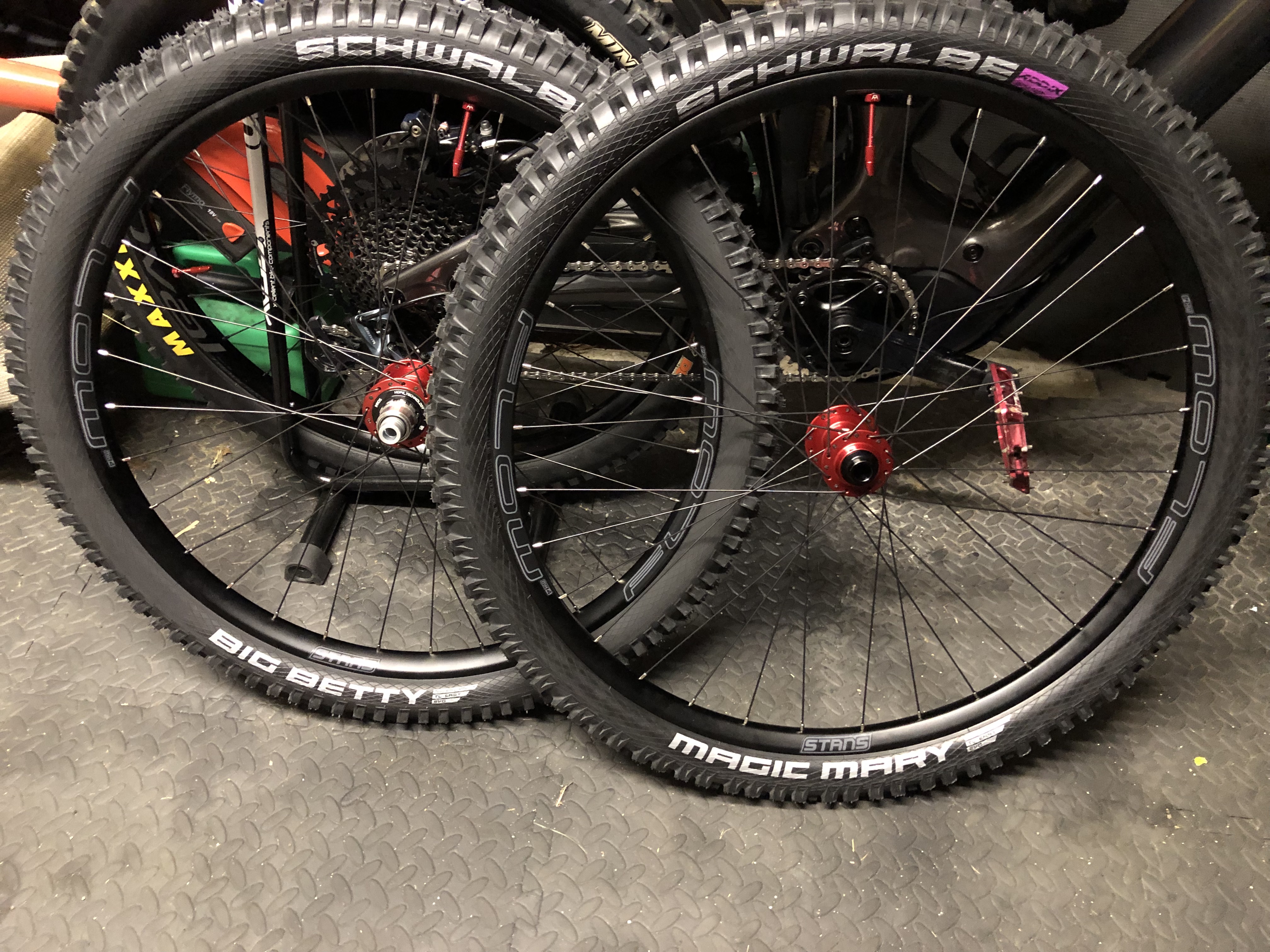

I have had a wheelset built, hope pro 5 e specific rear hub. 54 POE. All six pawls are supposed to engage at the same time on this one. Three are supposed to engage on the 108. Hoping that just means stronger for the 54 🤞

Pro5 ebike on Stans Mk4 Flow, Super Gravity tyres should be solid 🤞

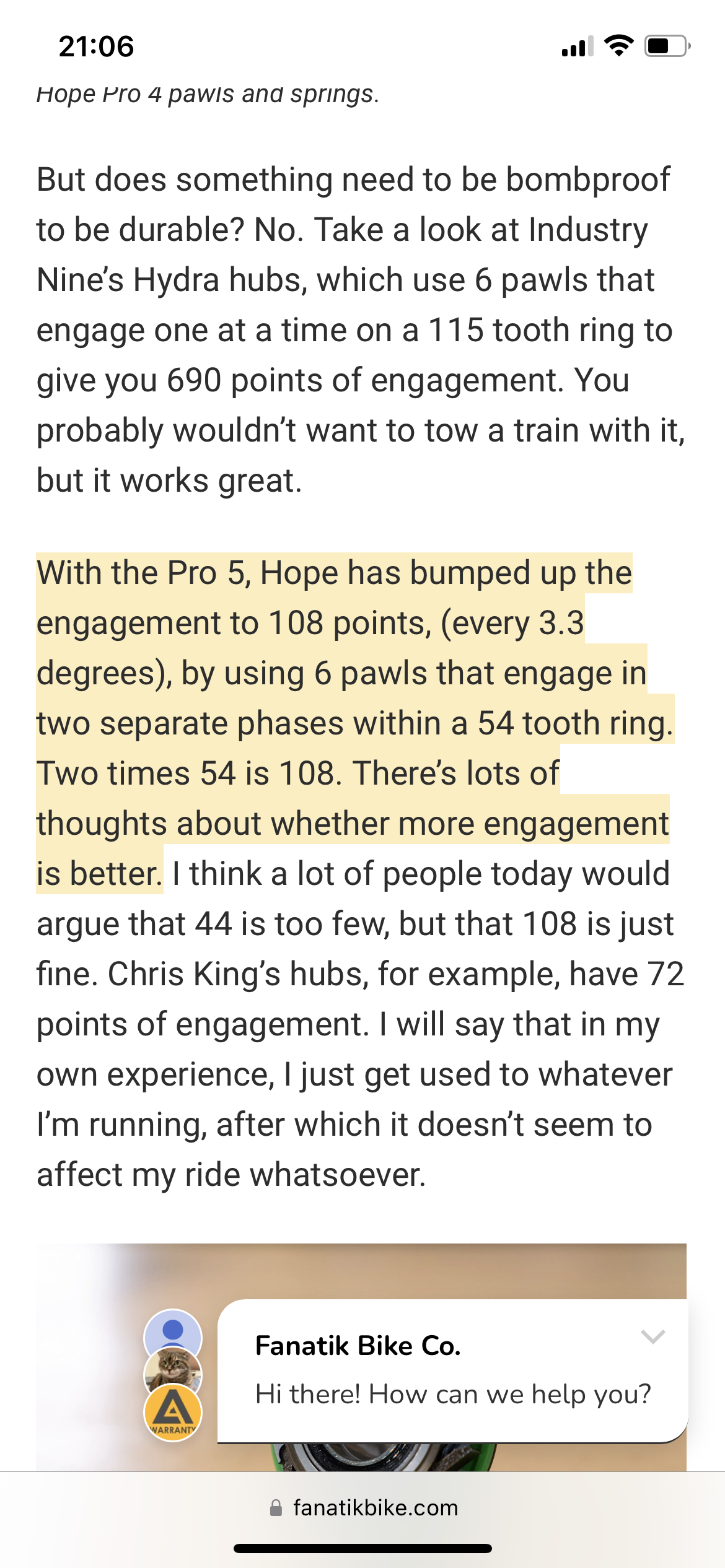

The POE with the 54 ratchet hub and two sets of 3 pawls is 108. I counted.
Degree of engagement is 3.3 degrees with 3 pawls engaged at any one time.
I think the ebike version has 6 pawls, all engaging at the same time and therefor POE is 54 and degree of engagement is 6.6 degrees.

R3Z3N
Mar 2, 2022
82
64
California
^Yup Dave, both versions have 6 pawls, only difference is one set of 3 is not offset by 3.3 deg from the other set (does not matter where in the rotation that is. It is the same with Industry 9 Hydras....they just have more offsets....
