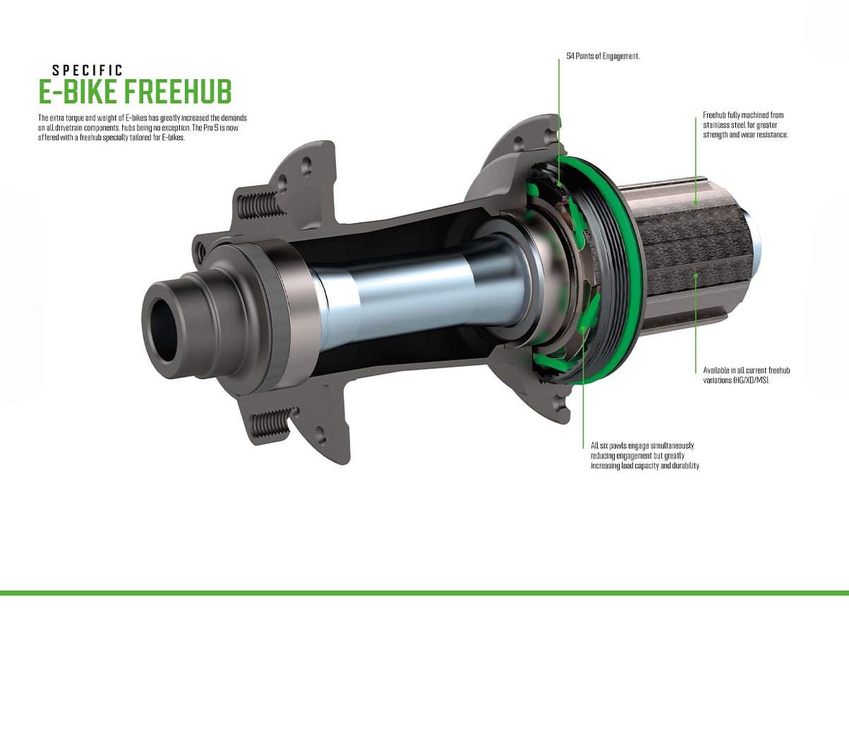

You're correct, just found this image from Hope:
irie
May 2, 2022
2,929
3,020
Chichester, W.Sussex, UK
If you are looking for the amount of slack before take up of drive surely that is defined by the number of teeth on the ratchet? It's a 54 tooth ratchet still so 360/54= 6.6°? ....not that it makes much difference on an emtb since the sprag/one way bearing in the motor will mostly define it.
Motor slack and ratchet slack are additive.

Just for my own clarification. Is there no difference between a pro5 Ebike and an regular pro5 other than the freehub?
If you look at the picture I posted above from Hope for it's ebike specific rear hub (you may have to zoom it up), you'll see all 6 pawls engage at the same time, instead of 3, hence the 54 POE instead of 108 for the non ebike Pro 5 rear hub.
Yes, I see that. Is that the only difference other than the freehub body material?
