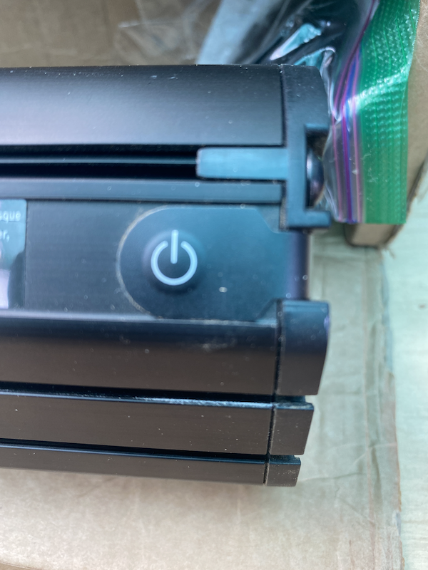

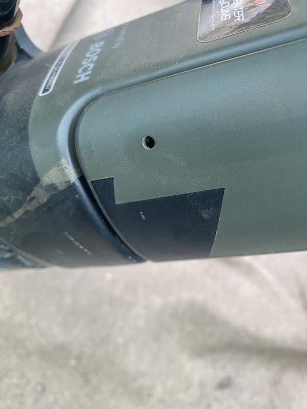

Search generally (ie google, to search other ebike forums). As cc_math wrote, sounds like Purion's batteries need to be replaced. From a thread on another forum, someone was able to get it running by turning the system on at the battery (as is documented in the Purion manual). On the Rail, there's a small hole on the battery cover through which the on/off switch can be activated:
Just so you know what you're poking, here's what's under the hole:

I replaced the batteries in the purion. 2 2016s. Nothing. I pressed the button through the battery cover hole. Felt it click. Nothing. When I hit the power button on the pur i on, I can hear a faint click. But nothing happens on the display or motor as far as functioning.
