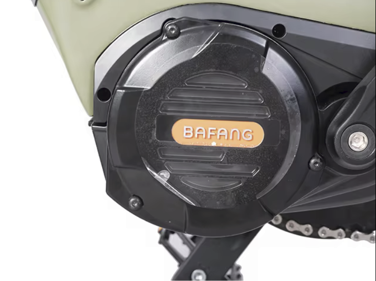

-Bafang M620 48v 1000w mid motor (1500w peak)

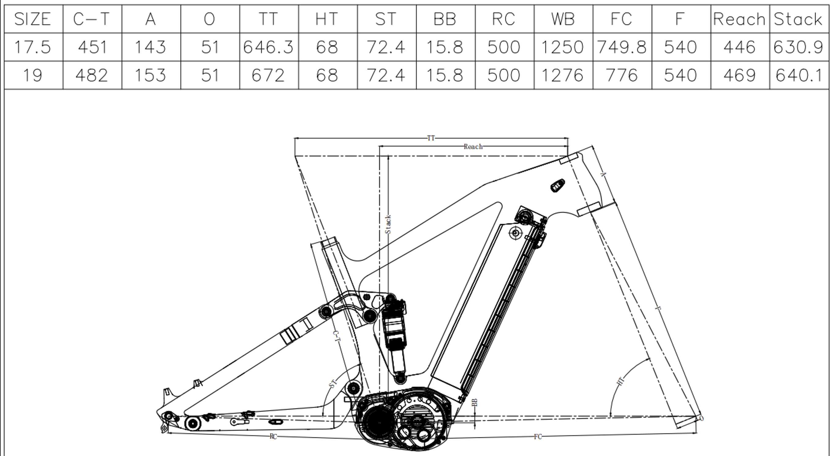

Therefore could you be so kind as to go over the components and geometry numbers to see if this is a decent enough build for the price of $3000 delivered and customs taxes paid (DDP). I know chinese carbon frames are a game of roulette, however I do business in China and therefore had one of my local engineers go into the factory and confirm all is good and excellent quality. So fingers crossed. Don't want to get into the china stuff is crap debate.

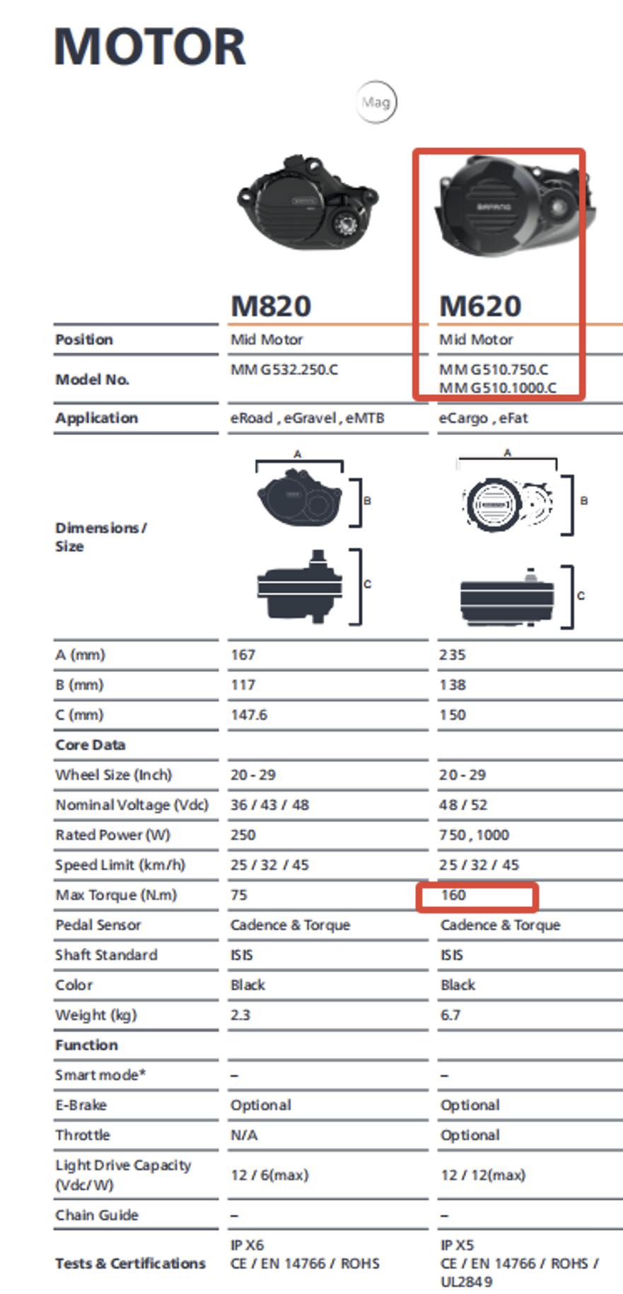

Hi welcome
I hate to be a party pooper but that motor wont be legal in the UK and doesn't meet EAPC regulations ,
You would need the M820 for that (y).
He won't be the only one with non street legal ebike in UK or the rest of the world 😁

I realise that and have asked the factory to set lockout modes at 150W, 250W, 500W & 1000W. So that when riding on the streets, I can lock it in at 250W, but when on private land, can unlock it to 1000W. ;)

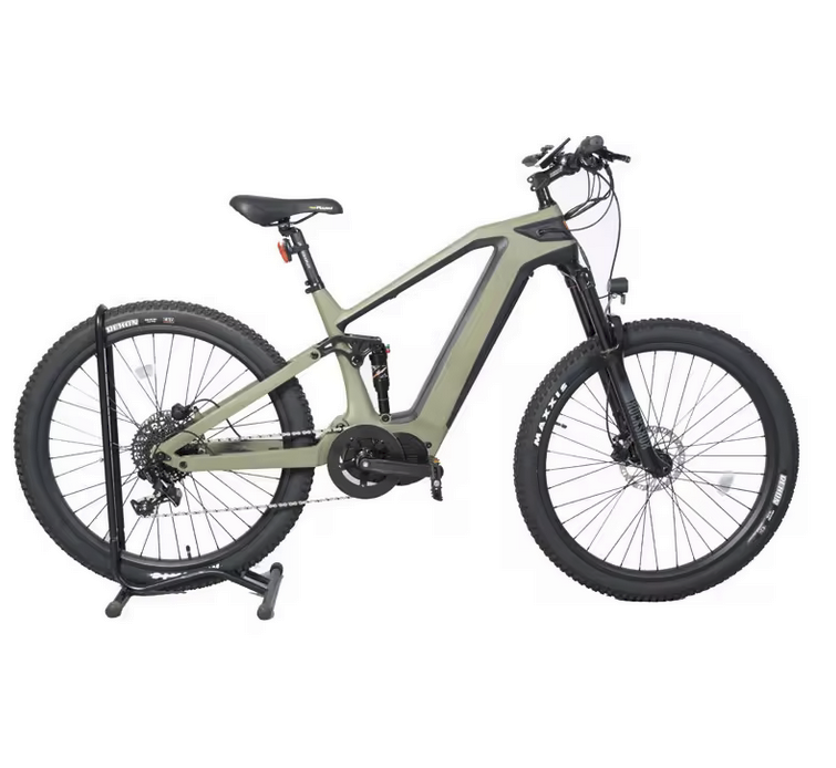

If you plan on hitting those trails, those brakes won't stop your 23+Kg bike. Get real brakes that are rated for downhill (Saints, Mavens, etc)

Sorry, was referring to a carbon fiber seat post.
Those pictures are stock basic. I've upgraded the important parts.
I regards to the brakes they are Shimano Deore XT M8100 brakes with same XT 203mm rotors front and back. Surely thats good enough. The system is 2nd from the top in their model line up.
What would you recommend? And how would they be better than the above? Thanks

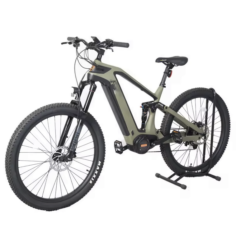

On his brakes, it looks like his picture shows single piston, but in his description he indicates XT 4-pot's. He'll probably be fine with XT 4-pot's, but he can always change them later if necessary and sell those XT's if they don't pan out.
1000W your drivetrain will implode quickly lol. ebikes are still using frail mtb components for drivetrains unfortanately. we either need thick steel chains and sprockets or belt driven eventually.
He’ll be fine. I’m running a 60 volt version of the Bafang m620 and the sram drivetrain has been faultless so far.

60 volt! Have you tuned it? Apparently the motors good for 2000w over tune. Especially with the metal gear update over the plastic one they had before.
What kind of max speed you getting?

Can I ask a question as to why you went down the M620 route ? There are more alternative frames if you use the M560 motor which is not far short in the Watts stakes with quite a big chunk in weight saving. If you go even further and use the M510 motor, then you could reduce battery size to something like the 720Wh batteries we are seeing on most branded bikes. Weight of the bike is not so important if you are planning just on trail riding and hooning about on the throttle. But do be aware that you will lift that bike over and around far more objects than you would suspect. The M620 physically is a big bulgy out front motor, the frame you have chosen is a big bulgy at every point frame. That setup is going to be pretty much a point and power bike rather than the nimble all rounder you are wanting for XC.
