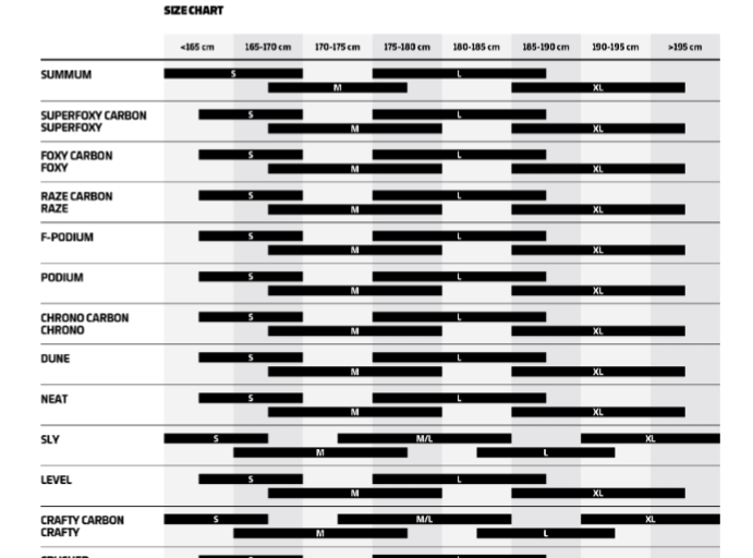

How do you find the Mondrakers for size?
I ride a medium, but I am on the cusp of med/large in most bikes - I have always found Mondrakers to be a slightly long reach, compared to others, but in modern terms they are about "normal" now. It's just that they have been doing long low and slack for a longer time than most.
Short answer - they're longish.
I'm 183cm so at the very start of a large and the top of an ML. Think I'm going for ML as it has same reach as my Rocky mountain instinct.
