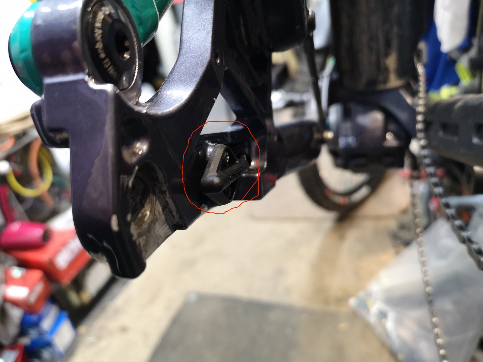

Take a picture of the magnet and its senor and attach it.
The misread speed reading of 87mph/140kph suggests to me either the senor is misreading or the magnet is signaling a higher speed incorrectly. Since you've replaced the sensor that would lead me to believe the magnet is the problem.
I'd first verify that the magnets positioning is correct and it didn't get a bang off a rock or something. I find it hard to imagine the magnet causing it to report 140kmph that should lie with the sensor or the motor.

the magnet position looks fixed so any adjustment ( front to back) would have to be done with the sensor. All the sensors I have seen have a line on them (a raised section) which indicates the proper alignment and it is usually quite near the cable end of the sensor assembly. That alignment often seems more critical than the distance of the magnet from the sensor which in your arrangement cannot be changed anyway.

just noticed on your photo of the magnet that rather than being positioned midway between 2 of the 6 arms of the rotor it seems to be touching one of the arms. That could indeed turn a fair section of the rotor into a magnet
So it does, I never gave that a thought! First thing in the morning I'll see if I can centre it, thank you for spotting that. I took it off to clean out the gunge I collected on a very dirty ride. If it fixes the thing I owe you one, although you are 4 or 5 hundred miles south of me for a Thank You pint :)

On the photo of your rotor, what is that down the bottom next to the mount rivet? It kind of looks like a small magnet?? You haven't picked up a stray have you?
Gordon
wow....I think you are right. I took a look at photos of the RT-EM600 rotor and all had the magnet in the same position as in the OPs picture (sorry OP to get your hopes up!!) ....but none had that small disc which as you said looks like a mini disc magnet.
Gordon
Sure was! Did you know that your eyesight gets worse as you get older! :ROFLMAO::ROFLMAO:
