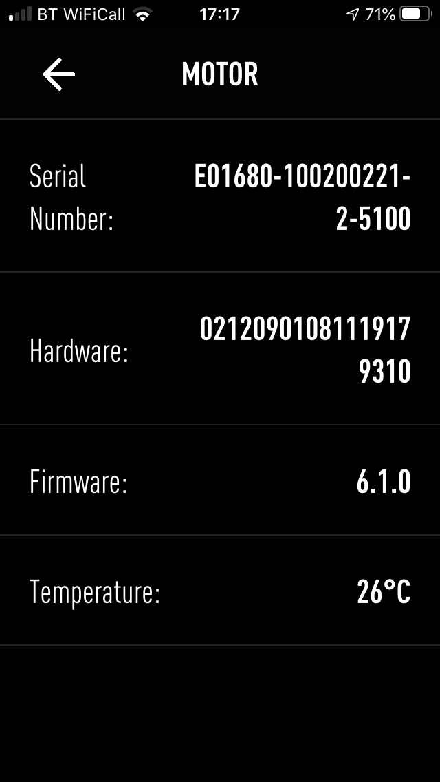

Do you happen to know what serial number the updated motors start at?
The serial numbers look like these pics.
The second segment of the serial # 100XXXXXX, the X's represent the date code of the Motor. Any motor after Jan 2020 is the updated motor.

Can someone explain how the numbers after the 100 represent a date? I'm not seeing it
So being an American company I assume the date works as follows, after the 100 the first two digits are the Year of manufacture followed by the Month as two digits and then the Day as two digits. In my case 100191008 would be 8th day of October 2019.

Just picked mine up from the shop after my first motor replacement after 1750 miles. I assume this is a 21st Feb 2020 manufacturing date?
