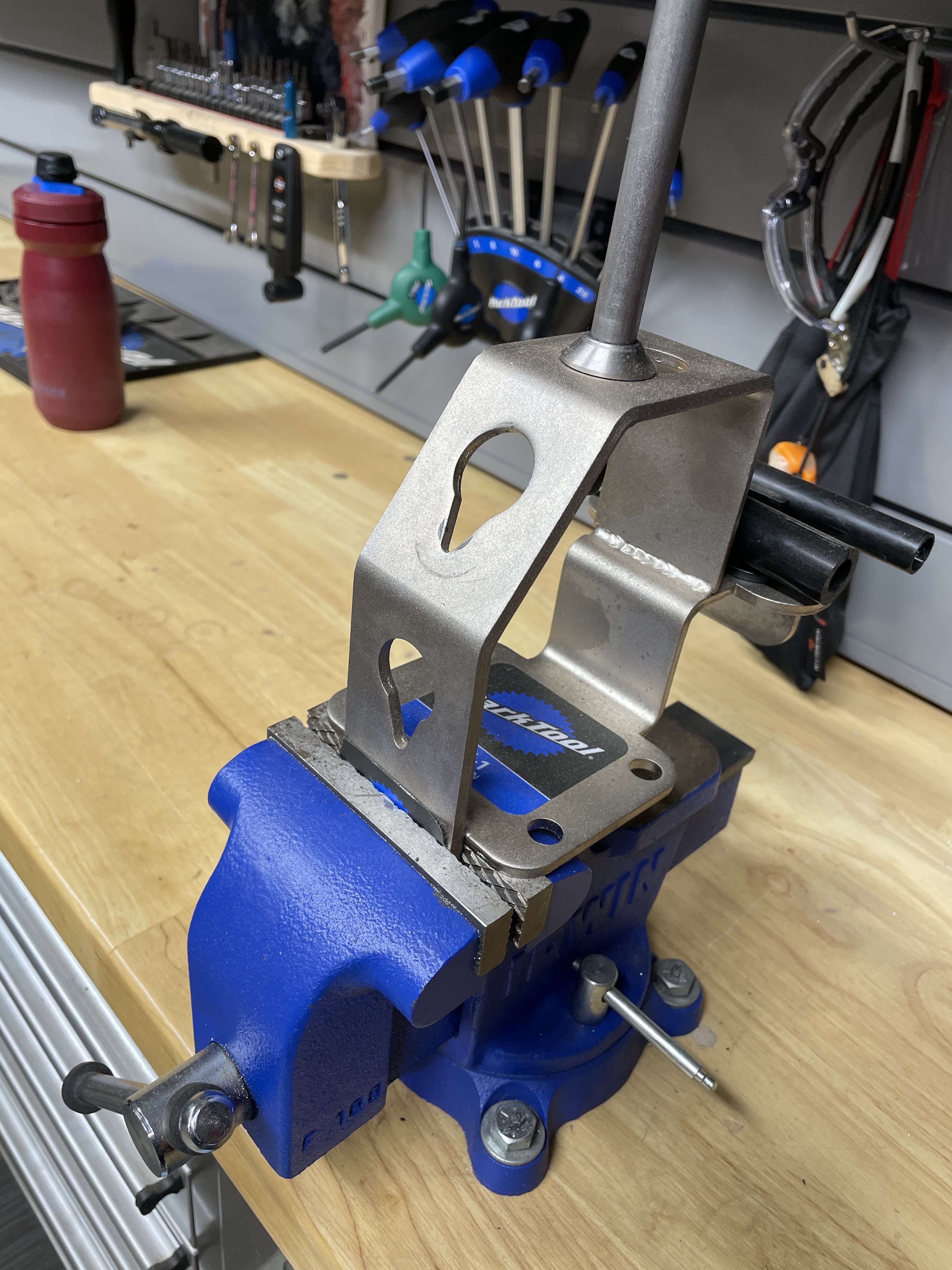

I want one ☝️! But not for that price.($500+). I see a few bikes come through my cave and some of those bikes could use that tool. I’d really need to justify it though. None of our LBS’s have one.
The Park Tool Wheel Holder caught my eye. But for that price ($200), no friggen way. But one day I was surfing the Trek tool site and saw it listed for $32.
I click BUY!
It lives in my vice and I use it more than I thought.
