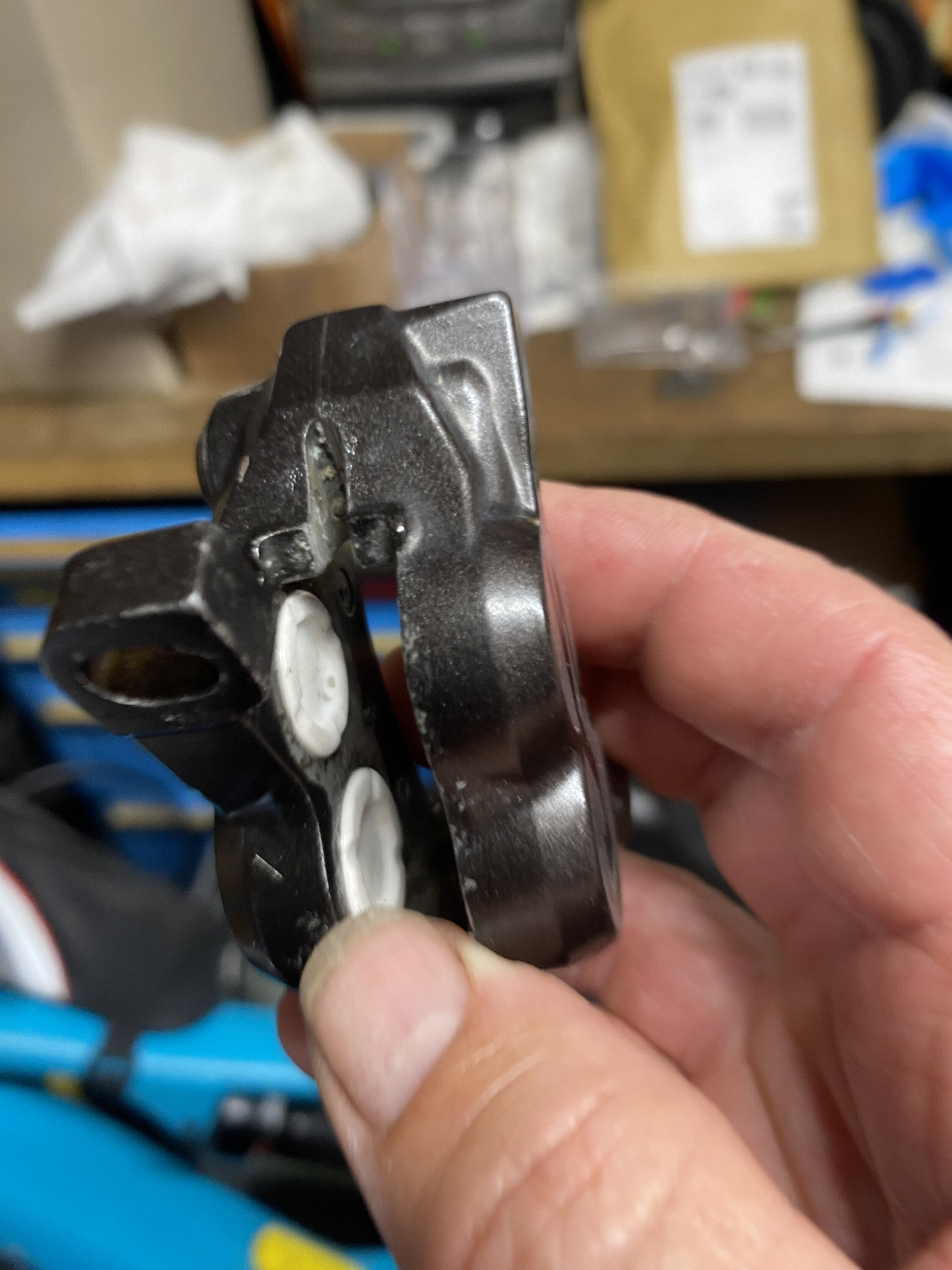

Lastly, look closely at Rod's pictures, specifically the last one. See those little specks of black scrunge in the caliper? A lever bleed lets all that filth stay in the caliper. When you bleed brakes that have been ridden hard and have many hundreds of miles on them, the brake fluid comes out somewhat opaque. This is caused by microscopic particles of black scrunge. The scrunge decreases performance and longevity. A full bleed gets out most of it.
