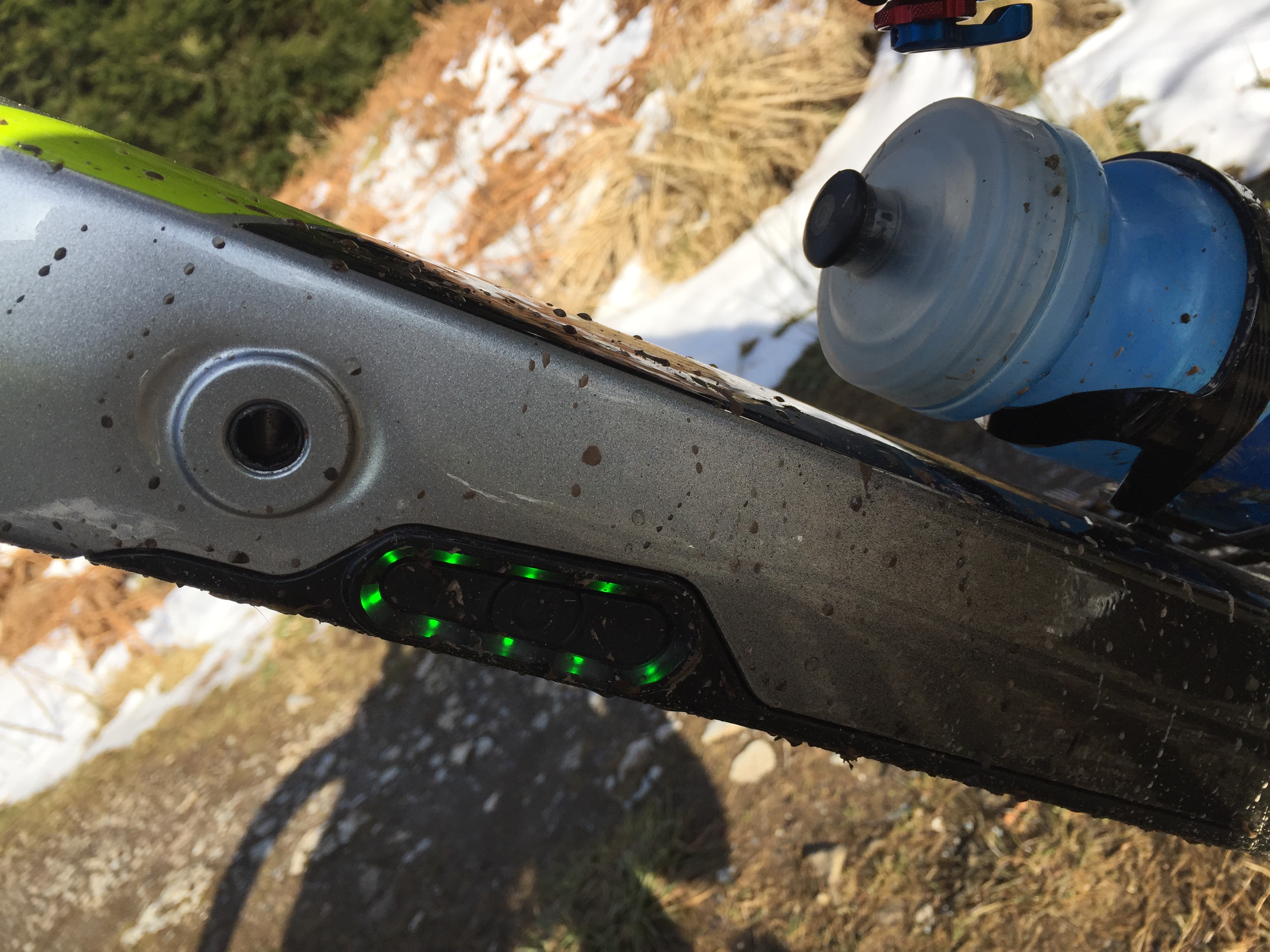

battery state after 12 mile pedaly ride using trail mode i am using the Z works app, if I had been just using mission control settings I would have used more than twice that

Think I will try trail mode turned down a bit , it’s probably a bit high in its standard mode , It would be good if the computer gave more accurate range remaining readings though , when it says 12 miles and you only manage 2 miles before it goes on red it’s a bit annoying
