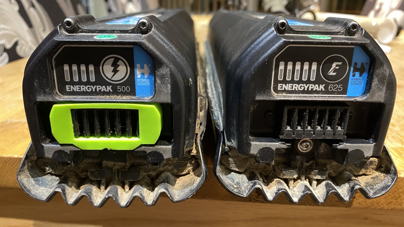

I have two batteries, a 500 and a 625, the latter of which is only a couple of thousand miles old.

We had already tried battery in and out multiple times, clean connectors, bounce the bike, etc… mates battery was a last ditch attempt.
we then continued on and did another 5 miles trouble free using each other’s battery until my battery (In his bike), gave a red light so we called time on the ride. During that ride we stopped twice and tried the battery back in mine. Never worked.
Back at the car, we did the same and mine still wouldn’t power my bike, so we tried my second (fully charged) battery.
That also didn’t work which was the biggest surprise. 😮
Out of the three batteries, only my mates battery would power my bike. 🤷🏼‍♂️
Back at home after an hours drive in the rain with the bike on the back of the car, back at home all is well, all three batteries work and no fault can be found so of course, no point taking it to the shop for diagnostics. 🤬
Now I only want to ride if my mate can come too. 🧐
The only interesting thing out of this baffling mess, is that my mates 625 battery happens to be newer than both of mine.
I am wondering about battery firmware doing wiring/resistance/impedance checks….. 🧐

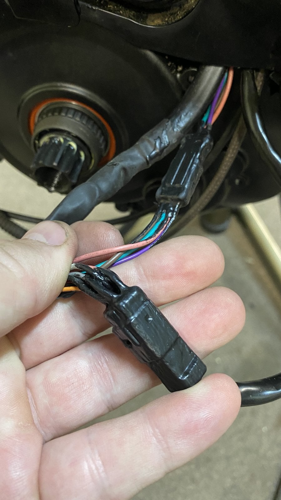

My wiring is ALL like this. Motor, CANbus, RCone. All of it. I can sit a garden hose on it all day and it has no issues.
Yet still we all have these damn problems!

and my wiring is always waterproofed like this:
As end users, I don’t think we can do any more.

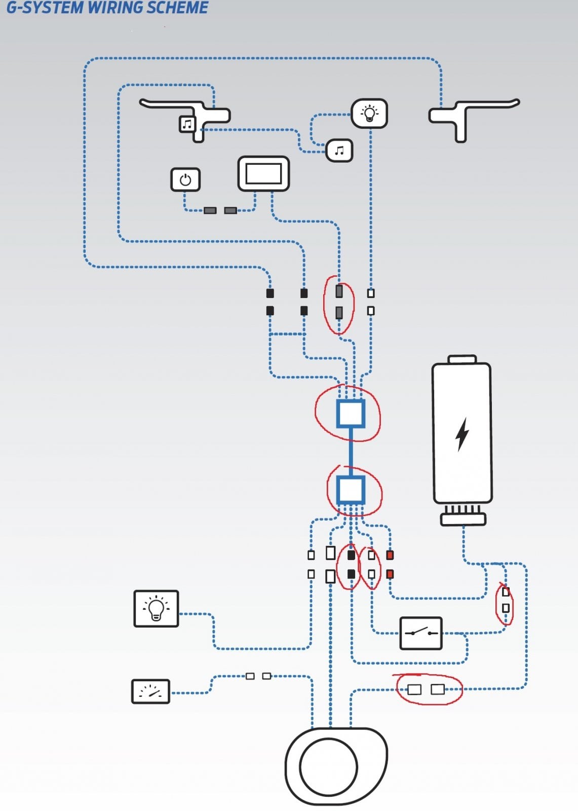

So when you get the power off if you remove your battery and add it on the other bike it works it means there are no issues with the batteries but probably the chipset that communicates between the control unit and the battery is malfunctioning for some reason?
Maybe check those connections between the battery and the chipset, as shown on this scheme and if there is a short-circuit issue?
14,171
21,078
Maybe check those connections between the battery and the chipset, as shown on this scheme I assume and if there is a short-circuit issue?
I see the problem. There are several places in the diagram where electrons are required to ark across to be with their friends. It's amazing any of it works really.. :)
Ok, so being more serious. For @Evolution Stu Could it be something really weird that batteries are logged in certain ways. You 625 stops working and it flags an error. You drop in a 500 and the error stays. Logically, you've changed batteries, but depending how they've written things, it think "I have an error on a 625". You drop in a 500 and that stays in it's log until it's clear. You drop in your mates 625 and it thinks ah, 625- no error - it's fixed itself. I've no idea how they've written it and we're grasping at straws. If you start with the 500, get your problem then put his 625 in, does that fit it or not ?
I understand your thinking and appreciate your input. Brainstorming is valuable.
I have been over and over this with every scenario imaginable.
Two facts rule out connection problems if all things were equal.
1) A faulty battery would not work on any bike.
2) A faulty controller or loom would not work with any battery.
Yet here we have a situation where battery 1, a 625 works all day and is retired to the car with 40% charge left and is replaced with battery 2, a 500. That 500 works for an hour and the bike dies. At that point neither that 500 or the earlier working 625 will power the bike up. Yet they will still both power up someone else’s.
That scenario says, faulty bike.
Until you find out someone else’s 2 batteries will both work fine on your bike.
In no combination of swopping them around can we make mine work. We try my 500 first, then his. My 625 then his, both mine then both his, both his then both mine. The results are always the same. My batteries don't work anymore.
The situation is made even stranger by the fact they always work again next day. I don’t take the bike apart, or even dry it. It just decides to work again and when it does, both batteries work again.

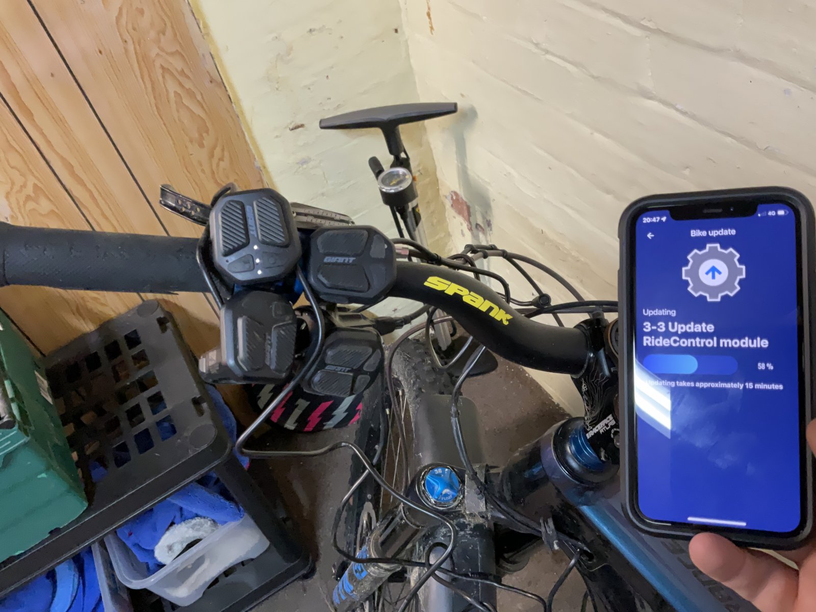

As a belt and braces excersize tonight I have tried all of the available RideOne Control units from FLED28-07 to FLED28-15 as I have one of each as test units.
I updated a couple of them whilst I was at it. Just in case. No change… this 500w battery still won’t power my bike but my mates does.

They told him that when he plugs it into his dealer tool, if the battery has a “Late teens” firmware number, it’s had the fix applied and earlier batteries can come in for an update to that firmware but it cannot be done at the dealers unless they send a guy out to do it specifically. No idea why.
Anyway…
The shop invited me to bring the bike and all three batteries (my 2x and my mates 1x) in and he would pull their firmware versions To see if it sheds any light on this wierd problem.
I waited with baited breath to see if my mates “Super battery” that always gets me out of trouble actually has this new firmware.
IT DOES! He is on 0x17. Mine are on version 0x10 and 0x11. So maybe there is some light at the end of this dark tunnel!

I have been liasing with my local GIANT Shop in Blackpool who has been supremely helpful, especially considering I didn’t actually buy the bike from him. He has been in contact with GIANT who confirm there are firmware changes in the battery management systems specifically coded to help with moisture problems these bikes have across the CANBus connectors.
Anyway…

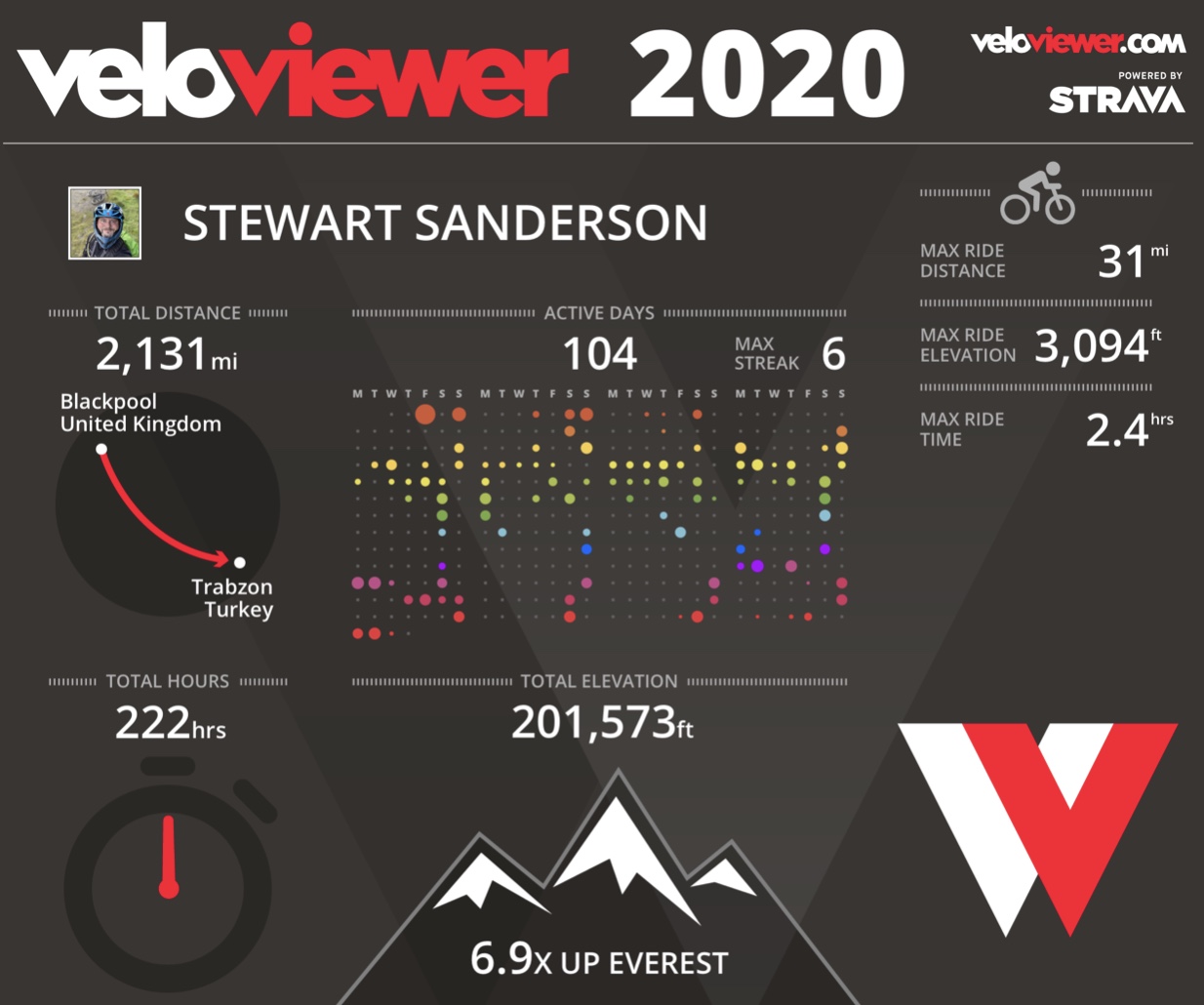

Here are last years Strava stats.
