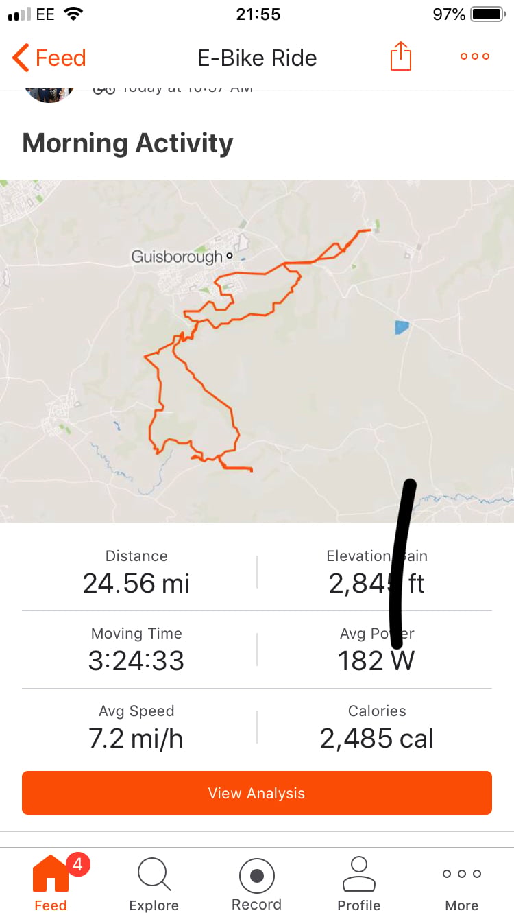

What do you think to the range here zero battery left all in eco + only.
