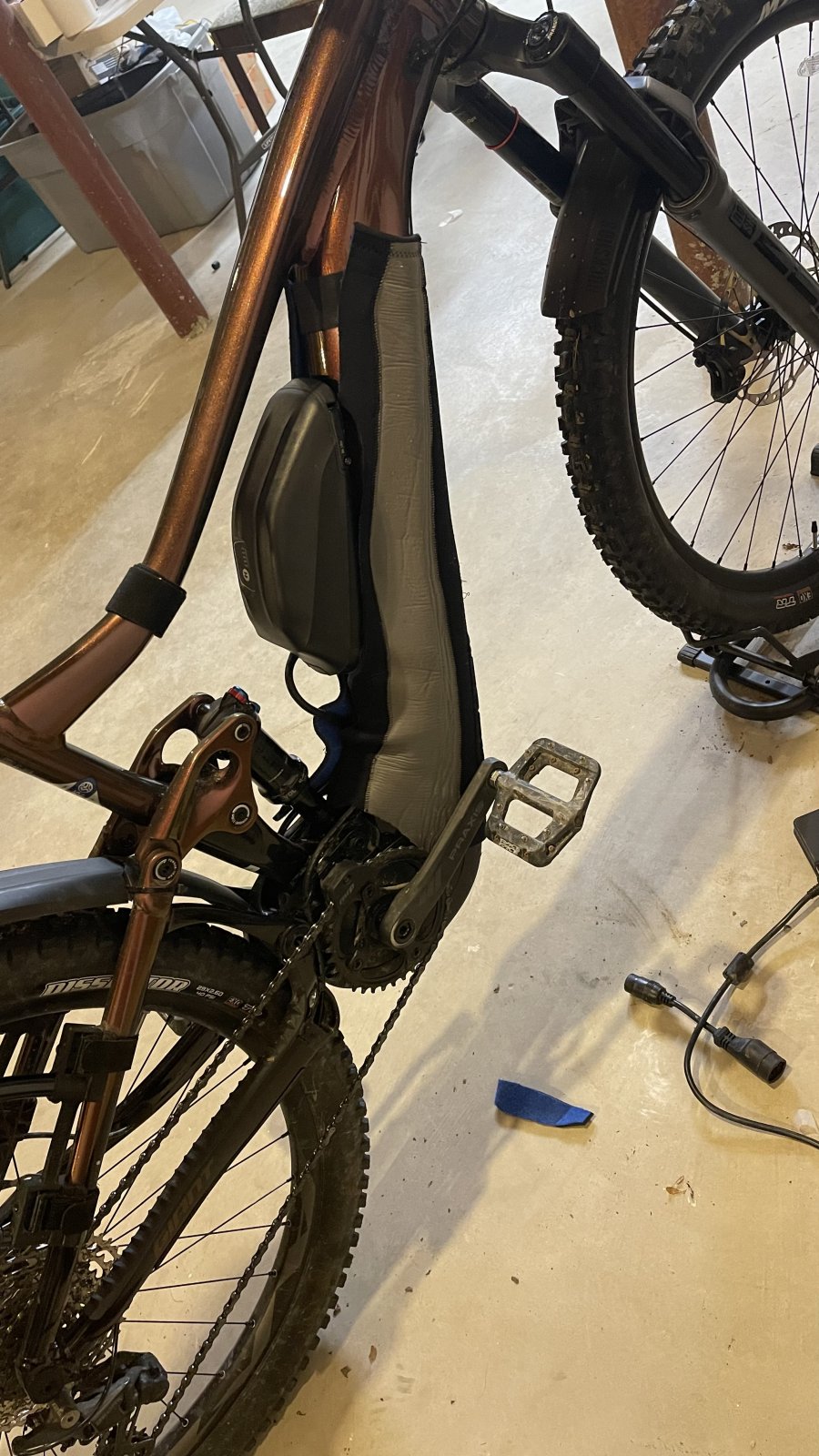

Hi Malc,
you can buy a cover that fits a trance to perfection on Amazon.
This is the only recent pic on my phone i have with it on, I took it on yesterdays ride.

I bought a neoprene downtube cover which helps immensely. I fitted some big eyelets into it to go over the bottle cage mounts so I can mount my lights battery to a bottle cage.
I also squished some blutak around the wires and cables above the battery but left the waxy paper on the battery-facing side, so the blutak doesn't stick to the battery. This stops any water that does get into the battery cavity from being channelled onto the connector by the recess channel in the top of the battery.
Putting some adhesive backed foam at an angle across the back of the battery would probably work just as well, to direct the water down the sides, rather than down to the bottom.
