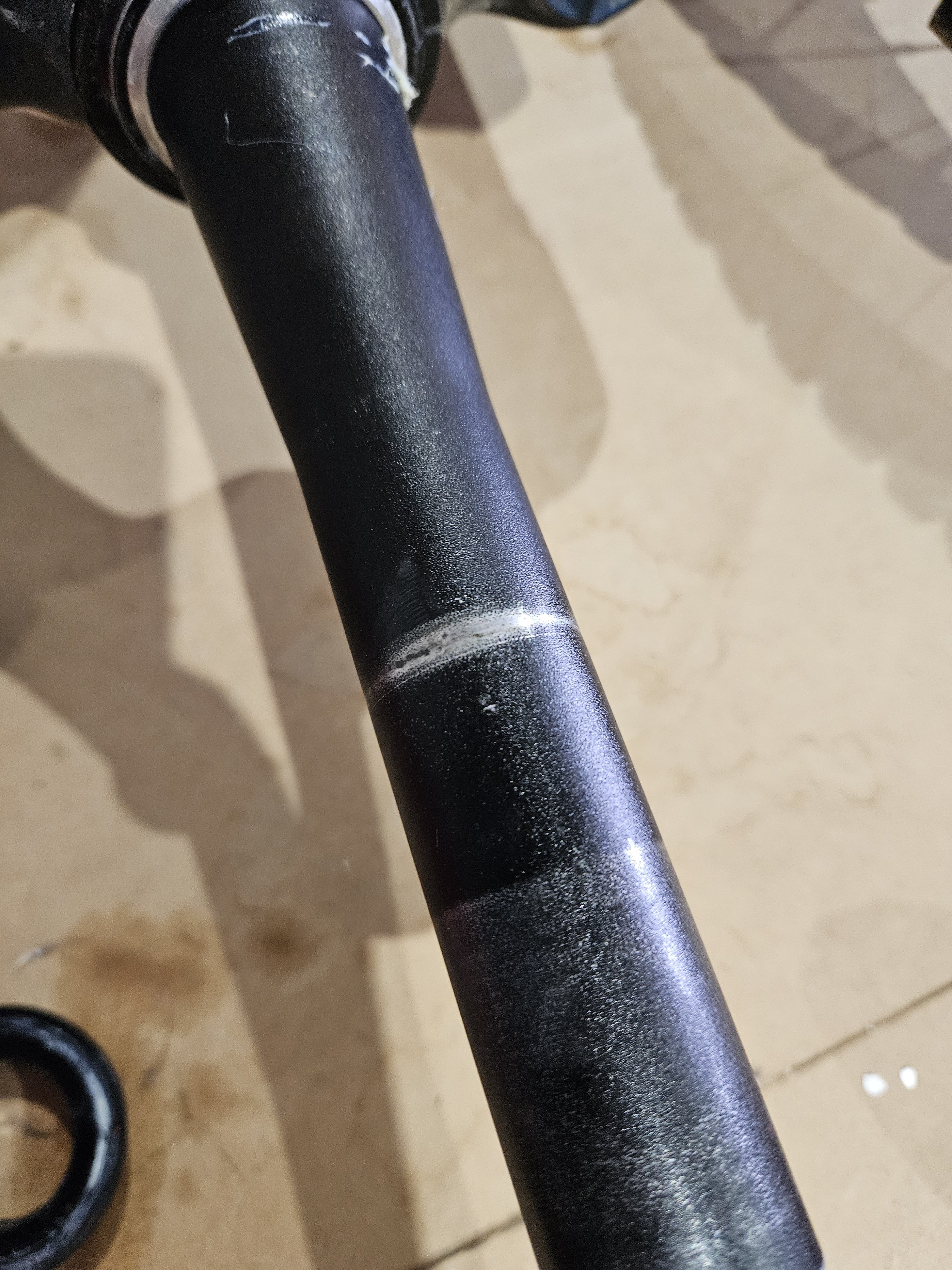

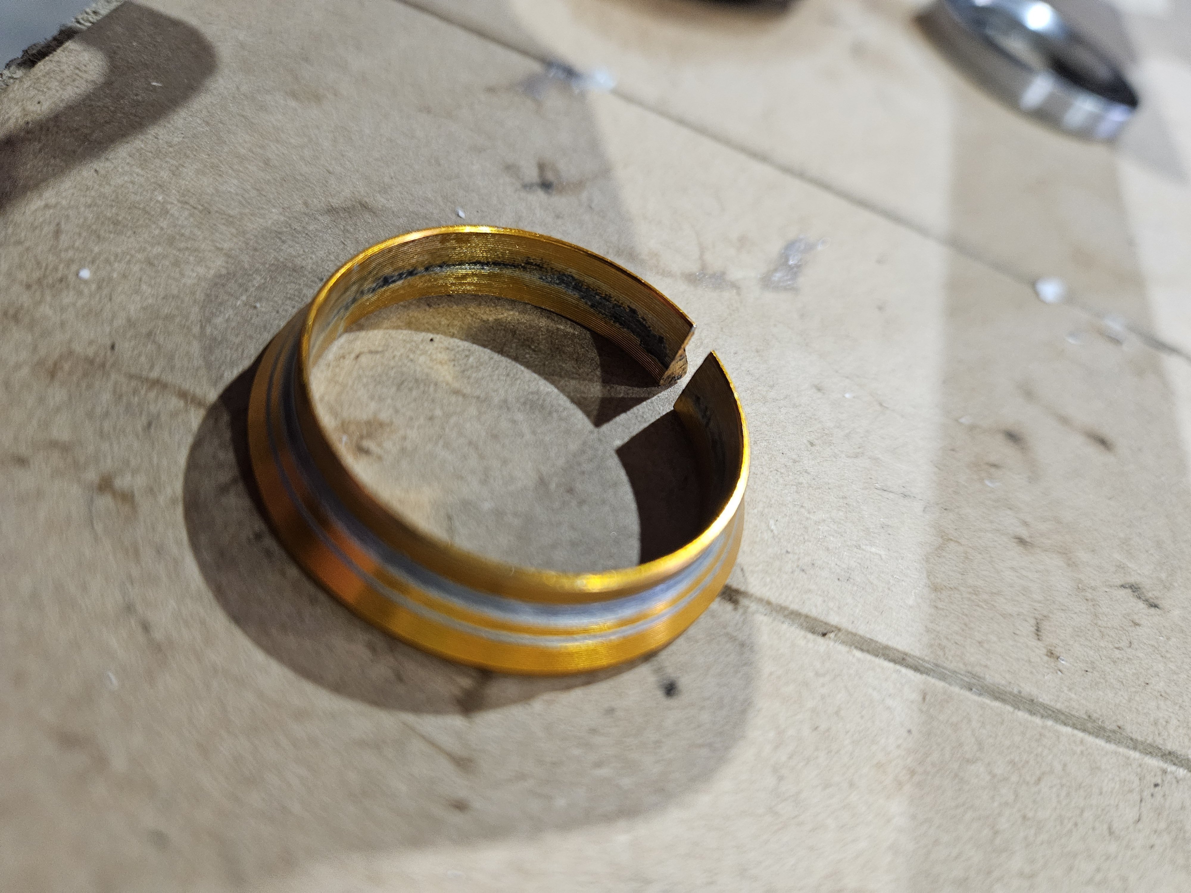

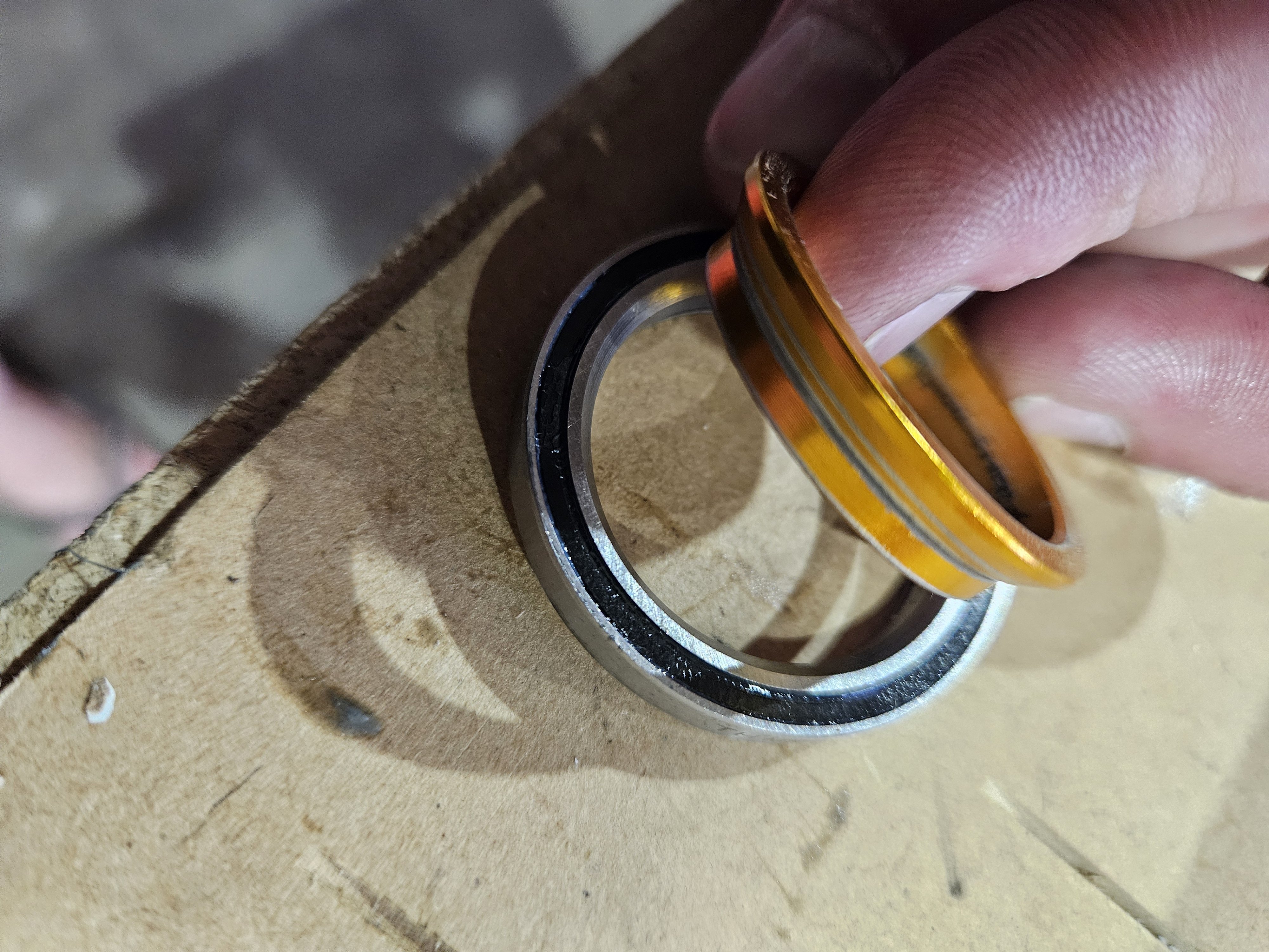

nztim
Jun 23, 2023
New Zealand
Had the same issue and appreciate the info above. Had a look at mine and I think the issue is the gold anodized part that is meant to clamp down onto the steerer tube.
You can see where its been fretting on my steerer tube and the inside of the gold ring.
I suspect some bearing retaining compound between the steerer tube and the ring might work for a while, I'll give it a try while waiting for the new headset to turn up.

goroncy
May 1, 2020
274
345
Munich
View attachment 135525 View attachment 135526 View attachment 135527
Replace the whole upper headset. I replaced it with Hope. I wanted to test it thoroughly before doing any report here. I can confirm that all creaking disappeared.
Trying to make the Giant's headset work is futile. I tried everything. Consider also replacing the dropper post lever. The one from Giant destroyed 4 cables. It's design is horrible and it causes too much friction. After the 4th cable gone I finally replaced it.

Evelhornet
Feb 13, 2023
29
25
Wales
For a second there, I thought someone had posted photos of my forks! Mine look exactly like that, with the same wear and I'm on my second Giant headset, (the first headset was also the same.) I agree, the gold spacer seems to be the main culprit. Be interested to know how people are getting on swapping to Hope or another decent brand.
goroncy
May 1, 2020
274
345
Munich
I switched to Hope. I had more than 20 rides since then. Usually the noise turned itself on much earlier. So I confirm swap of the upper headset fixes the issue. And that's perfect because the number of options for the lower headset is extremely limited.
