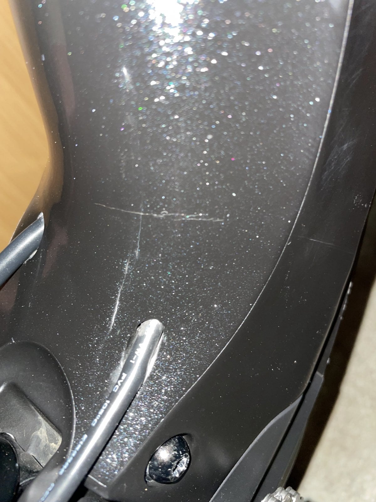

It's been confirmed it's filler to smooth over the welds. Not great but cosmetic and they will sort it out. Carry on riding in the mean time.
As of 10am this morning they have been working through claims to inform customers not to ride the bikes until further tests at the production end have been completed to ensure safety of the current frame
This is what Giant sent the bike shop this morning!

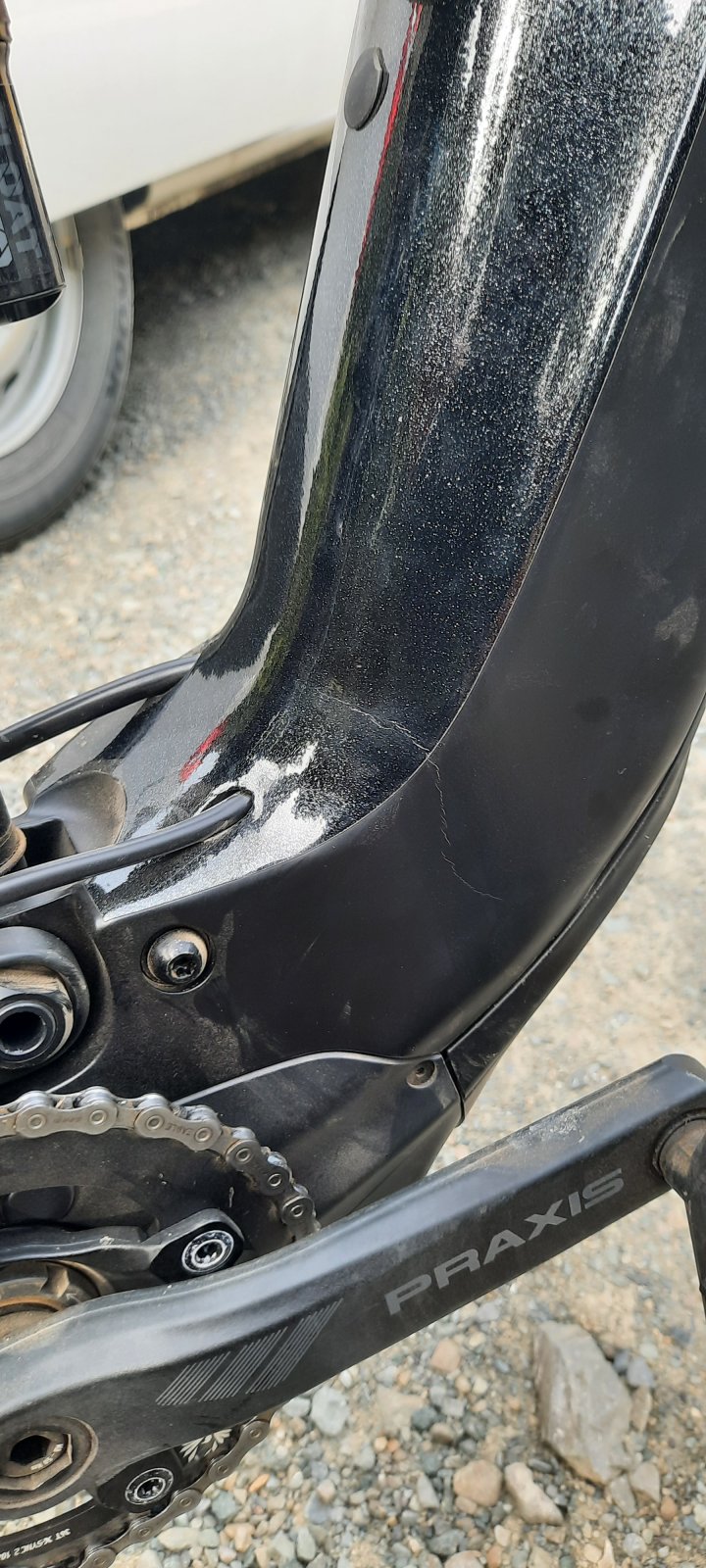

Hi, Just scanning the web and came across this chat. Just giving my experience of my new Giant reign E+ 2022. Received start of January and taken back to my LBS less than a week later after only 2 short rides (10km max) as it has a good size crack in the same area as you are showing. The LBS really sorted me out and gave me a 2019 Trance sx ebike which is rad as a loaner, that was almost 6 months ago now and havnt heard a peep from Giant or the LBS since. Hope to hear back one day, thinking about asking for my money back and offer to buy the loaner off them as I have got so used to it now and love it. Shame this seems to happen to a few as the Reign is one cool looking bike.

This is totally shit!!
no way this was back in January!!! This is so shit! GIANT need to sort this out asap! My mate who has been riding his reign today has just found a crack in his!!

There are now 6 lads I know of in may area of north wales that have the same crack in the same area!!
This is not good!!
Have you compared the serial numbers of these bikes ? If the serials are close to esch other then it could be a bad batch where as serials wide apart could mean a systemic error for all bikes manufactured.

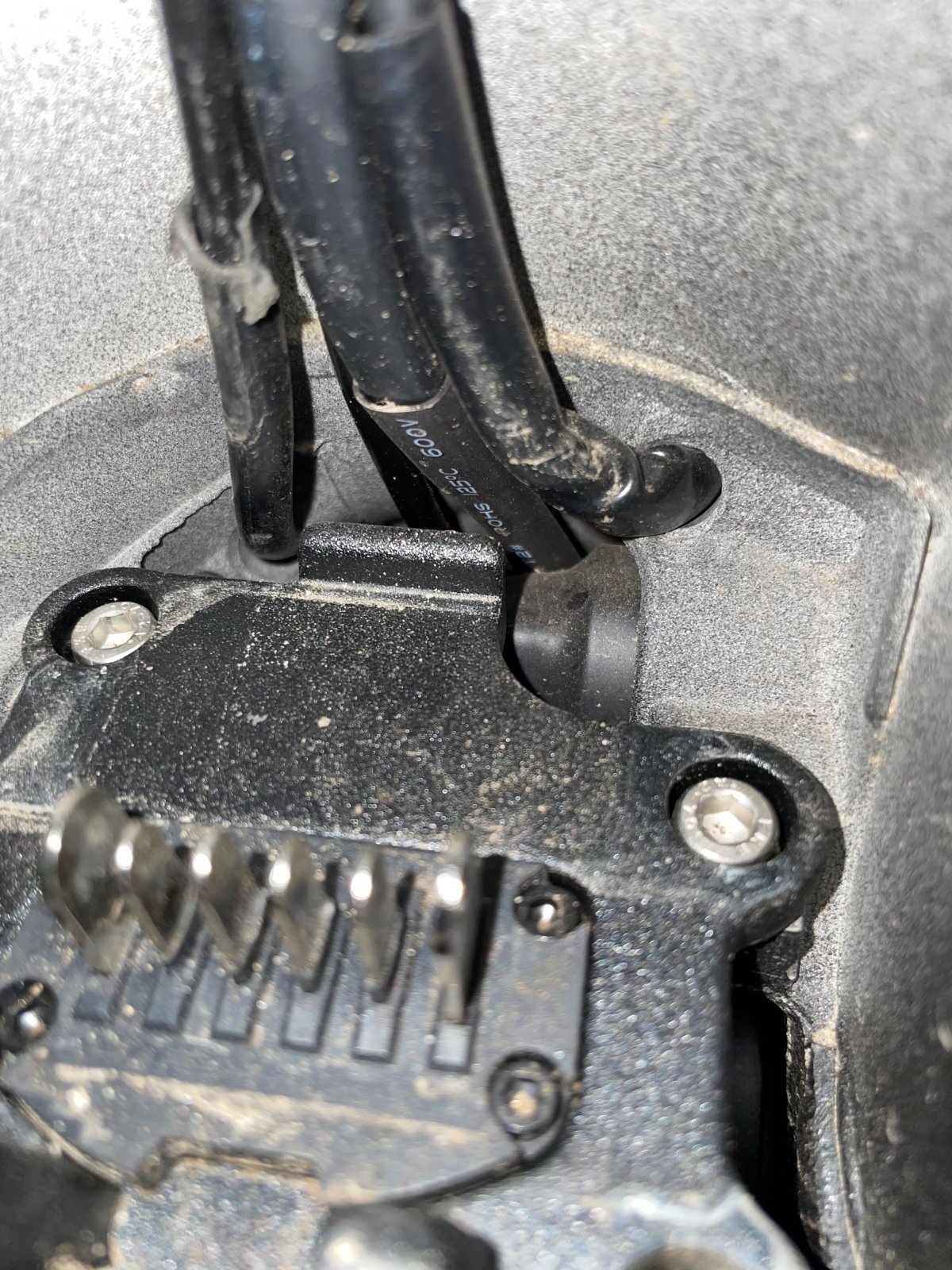

I think there's now a good tendency showing low mileage bikes or even new bikes that are cracked from the factory after seeing quite a few cracked frames here or on FB.
This is most likely a batch related issue with the filler or whatever related to the welding process of that specific weld.
I don't want to take Giant's defense, but it must be one hell of a nightmare to fix...imagine if cracked frames are all spread out through the production dates. There's a good possibility that they don't even know the root cause yet and therefore could be replacing your defective frame with another defective frame until they figure it out.
