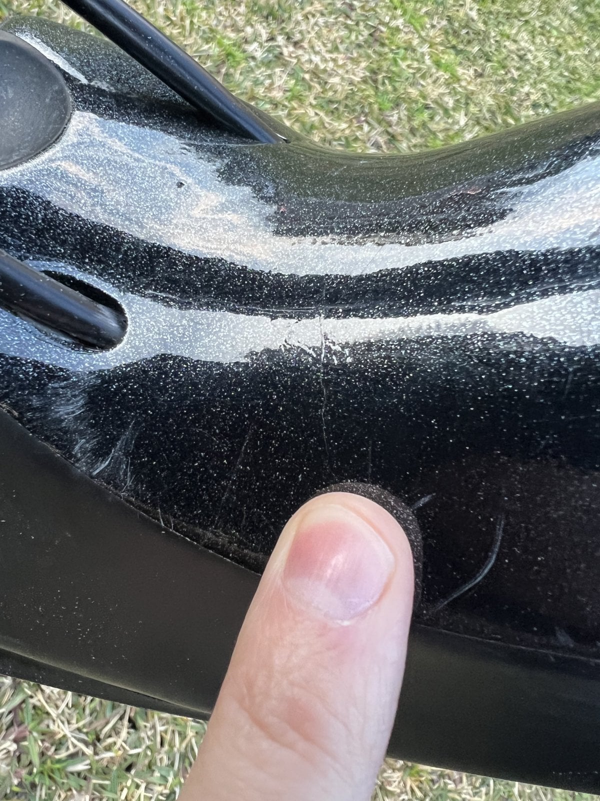

Its a filler and paint issue which they are solving by going to a different welding process. Giant told me in writing it's a problem only with the filler and the bike is safe to ride until the replacement frame comes.
I hope you are right but have seen no evidence that anyone from giant engineering/manufacturing/the factory in Taiwan has actually had a faulty frame sent to them so that it can be stripped. If they had, they would be better placed to provide some evidence that the crack is merely cosmetic, rather than just the wordy reassurances offered.
I am beginning to think based on photos both here on of the Orbea Wild ( ally) that these frames have not in fact been welded in some areas but rather they are male/female joints that are bonded ( ie glued). That would indeed leave a straight line where the 2 sections join and require some form of filler to cover. The key issue for me is that for the filler on that line to separate...in a straight line..it suggests the bond has failed and the 2 sections have slightly separated. Using that technique to join 2 ally tubes is nothing new however. The difference in this case and the case of the seat tube separation on the Orbea Wild is that the join in that area, close to the BB, is subject to torsional stresses, not just compression or stretch.
I like both the Trance and Reign so my comments are not designed to knock either bike but rather to get clarity on what exactly Giant frame manufacture is trying in terms of supposed new techniques, and its impact on those that buy these bikes. Giant after all make frames for a variety of well known brands not just their own. A short time ago Lappiere also announced a complete recall for one of their bikes.

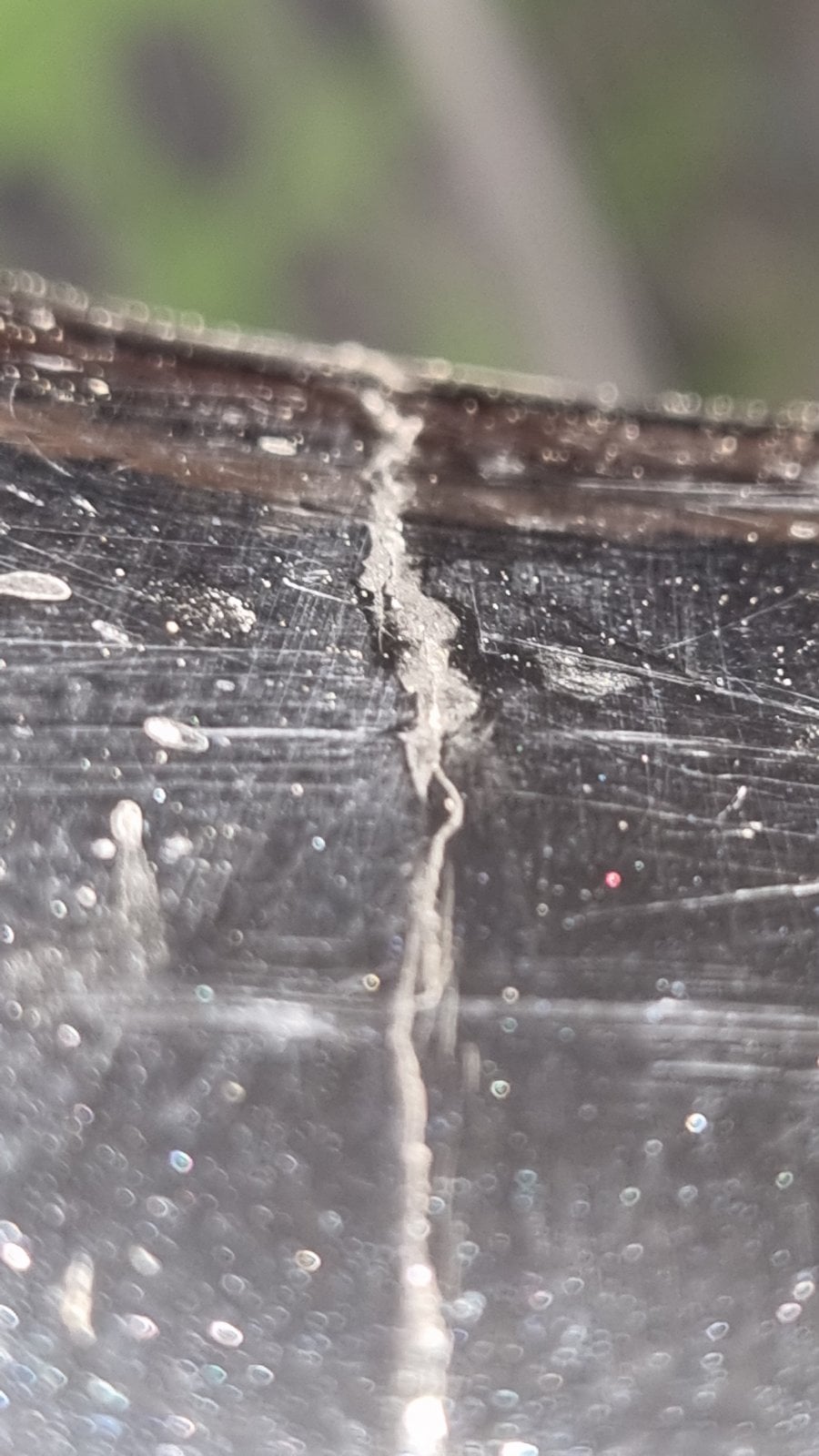

Just been for a ride with another friend on both the reign and the range vlt c1.
Have done many while I have both bikes and waiting for replacement frame to sell the giant. My goal is convert as many friends to eeb as possible during this time.

Even though it is being said the crack is cosmetic the bike rattled like fuck and its unsettling to say the least given my crack now goes right around from edge to edge now. . Jump on the Norco and....... Silence........

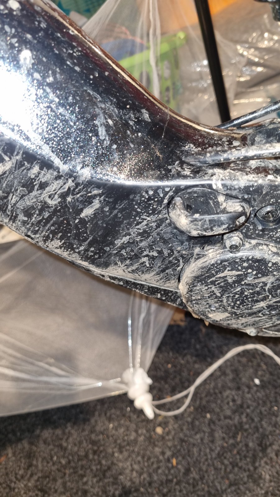

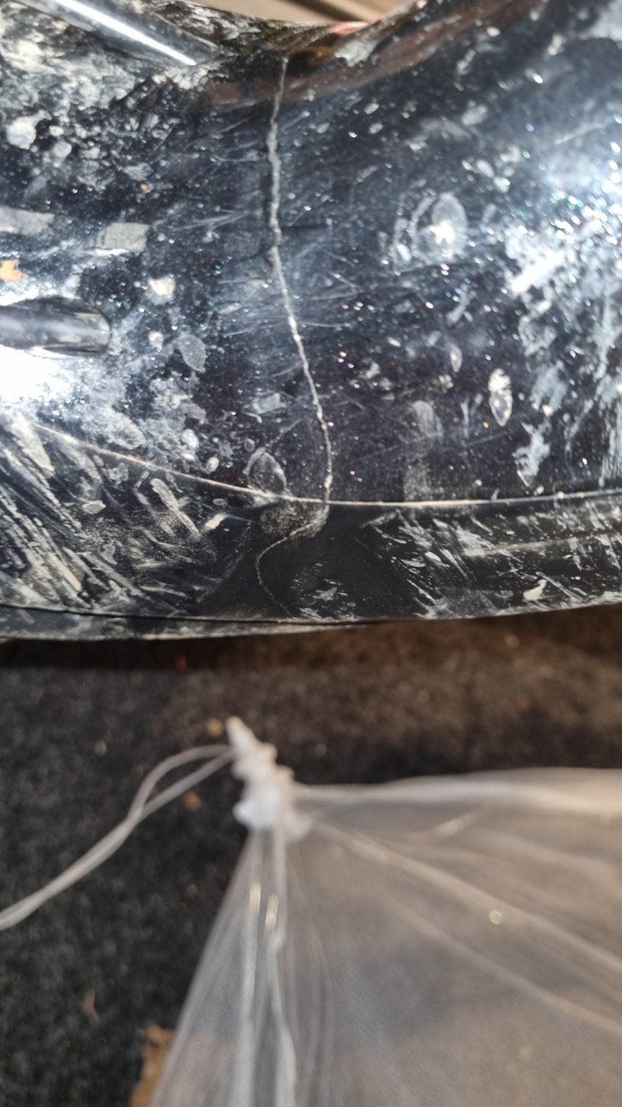

Interesting thoughts mate! any chance of seeing a pic of how far around the line actually goes now?
It’s funny I know a guy who had the same norco and his frame actually broke! He ended up selling it on once fixed

New Zealand
Every single person that's ridden both bikes disagrees.
I still think the frame is cracked and making the noise.
My crack has a noticible step in it.
We'll never know as I'm not keen to void my warranty by digging.my crack is significantly worse than any other I've seen.
