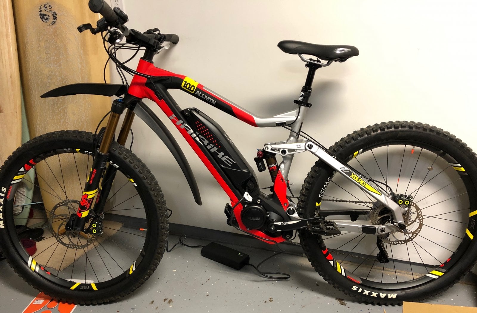

However... I was never 100% satisfied with the bike and returned it. Through more research I came across HAIBIKE and it blew my mind. It looks incredible, it rides amazing and the Yamaha motor isn't as regulated as the Giant version. It has more "kick" to it. I got it on sale and only paid $200 more than the Giant. 2018 XDURO AllMtn 10.0

Pretty bike. Very similar specs to the Giant, with the following advantages, disadvantages:
Motor, identical, but Giant can be custom tuned by software to any available torque.
Haibike comes with pedals and a screen display, the Giant does not. Giant comes with fox 36mm forks, not the smaller 34mm forks like on the Haibike. Integrated battery on the Giant, addon look on Haibike.
The rest is a wash. Hope you enjoy this one more, and try to limit the turbo boost if you can.

The bikes actually feel VERY different and I was lucky enough to test them back to back. The specs of the forks, brakes and derailleur are splitting hairs. The Yamaha motor on the Haibike feels much less regulated. When I hit 20mph, the Giant felt like I hit a brick wall and everything slowed down. The Haibike doesn't do that and I can keep pushing faster. My best description is this... The Giant felt like a "consumer" product and the Haibike feels like what the pros use. Kinda like driving a stock Ford Mustang and then getting into a NASCAR. Loved the Haibike the moment I jumped on it. The Giant always left me wishing for more.
