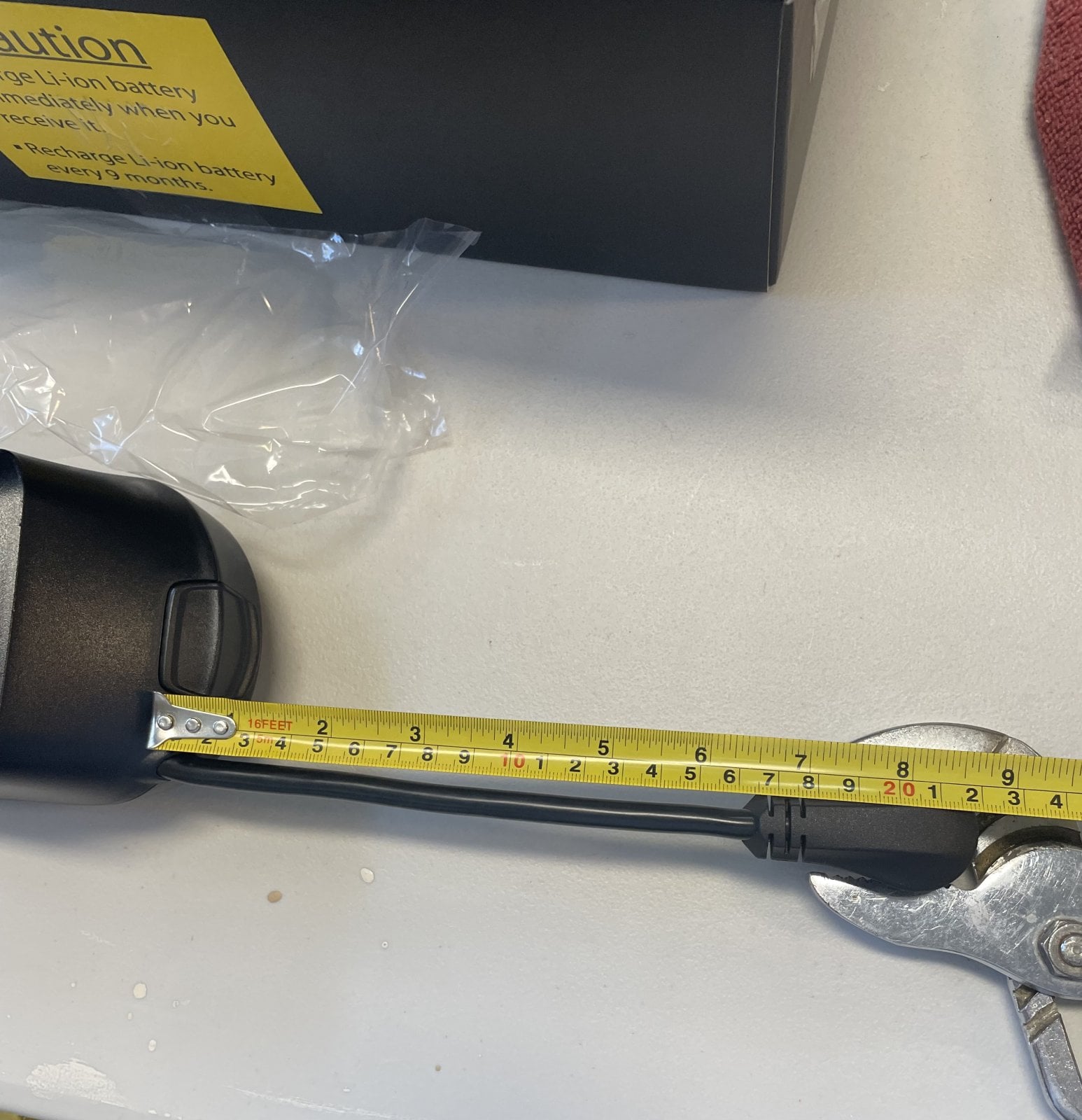

Finally Giant Canada got back to me about the problem with the too short of cord. All I was told is that they are aware of it. 🤔That’s it ! Does anyone know of a third party Extender that will actually work on the 22 Reign?

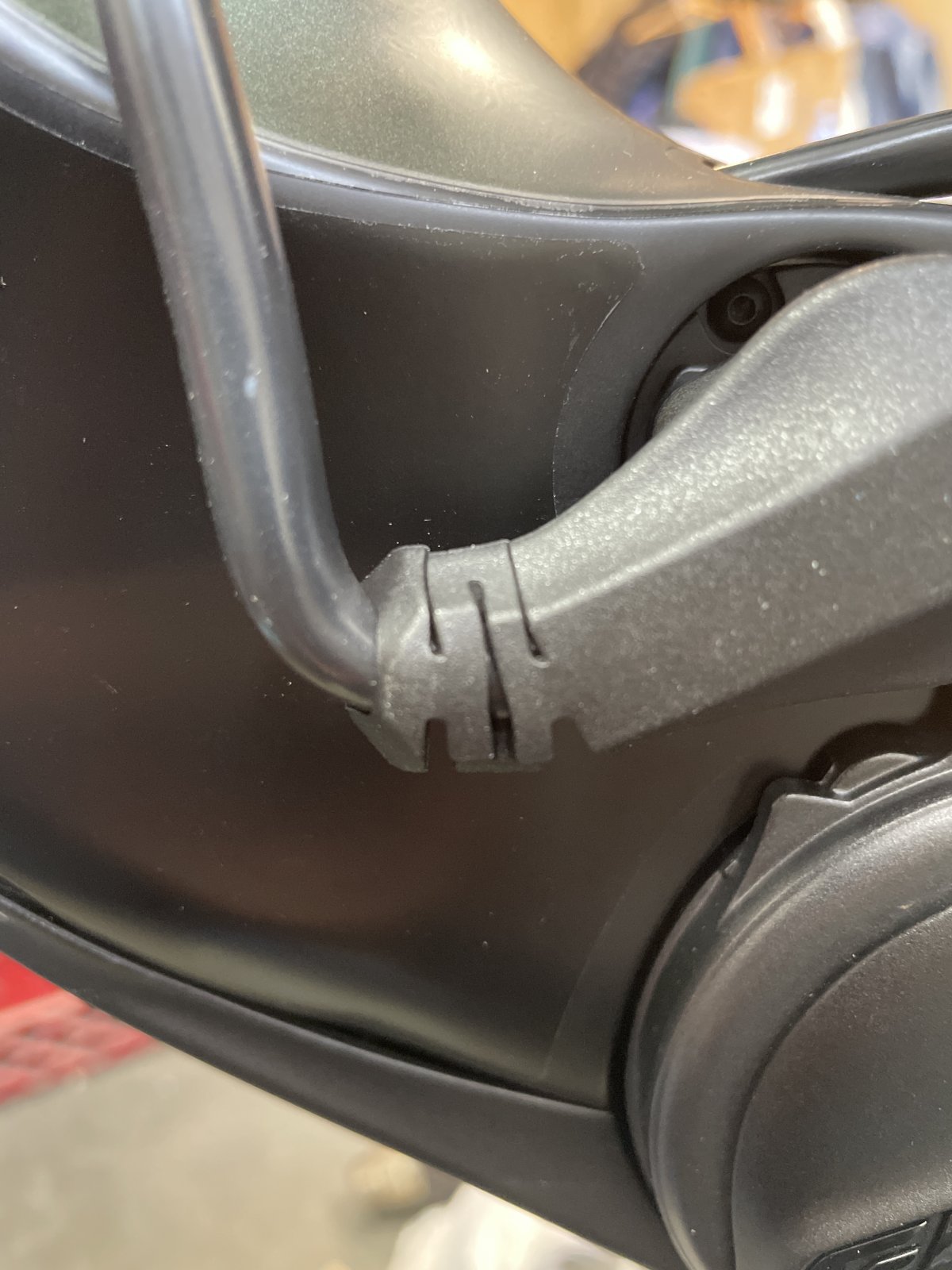

You are absolutely correct ! Giant currently has NO solution for a problem that is inherent with all the 2022 Regin E ‘s. I installed mine after many emails with Giant claiming that if( more like when) a further problem arises I can put in a warranty claim. I have no doubt in my mind I will be, it’s just a matter of time. I ended up using a heat gun to massage the connector and cable to relieve some of the tension. Without doing so it was impossible to even plug in. Because I want/need the extender I am willing to use it till it’s wrecked but will definitely be putting in a warranty claim before the year is up no matter what.

Endorium just look at the picture I posted above how the cable fits. It was impossible to plug into the charger port as supplied until I took a heat gun to it. So far it’s holding up but for how long is anyones guess. It would be a $1000 replacement if it happened out of the original 1year warranty. I’m not impressed..
