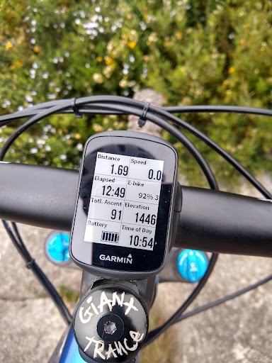

Cozza
Apr 26, 2022
Reading
I never even open the app now, no need for it, I got a Garmim Edge 130 plus, the cheapest one with ANT+ and it shows all I need with instant startup. I recommend this to everyone.
You can show more or less fields.
Garmin records your ride FAR better in every detail too. I used to feel a bit annoyed about my bike before this, but now never even think about the app. It's replaced as far as I'm concerned.
App field is Ebike Field
Hi, that's helpful thanks. What computer mount do you use for your Trance?
