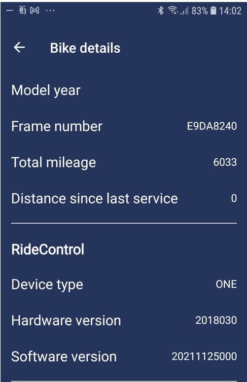

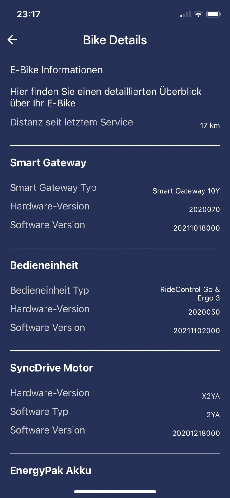

25/10 Motorsoftware shown as 1218A
7/12 Motorsoftware shown as 1865
28/12 Motorsoftware shown as 1800A
All on my Android Samsung S20
Then checked my iPhone xs today App Version 1.10.xxx
Updated the app to the new Version
Motorsoftware shown as 18000
The App does nothing than changing the view but not the Firmware.

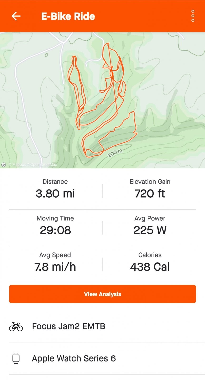

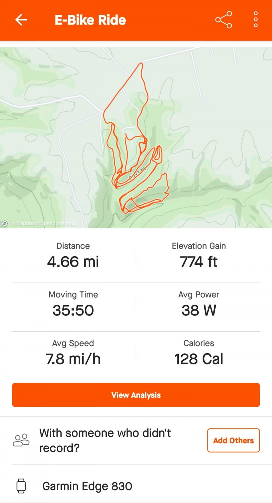

How to display the watts properly in Garmin? I've been using the pwoermeter by connecting my ebike to Garmin device (830) but it shows only 40W on average and it should be more than ~100W (my estimation). Thank you in advance if you can help me
I've noticed the same. The watts must be wrong, This was my first ride with the Garmin 830 and it claims only 36W average. I know I'm weak, but I struggle accepting this as accurate. My friends apple watch recorded 225 watts average for the same route, though what it was measuring, I have no idea... he doesn't connect it to the bike.
I realize that an apple watch's estimated watts sent to strava, and whatever Yamaha measures at the cranks and sends to Giant who sends to Garmin, who sends to Strava, are never going to correlate, but they both end up as watts, which is not helping me.
This from an apple watch.
This from Garmin sync'd to Giant.

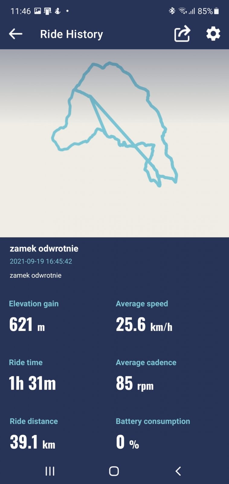

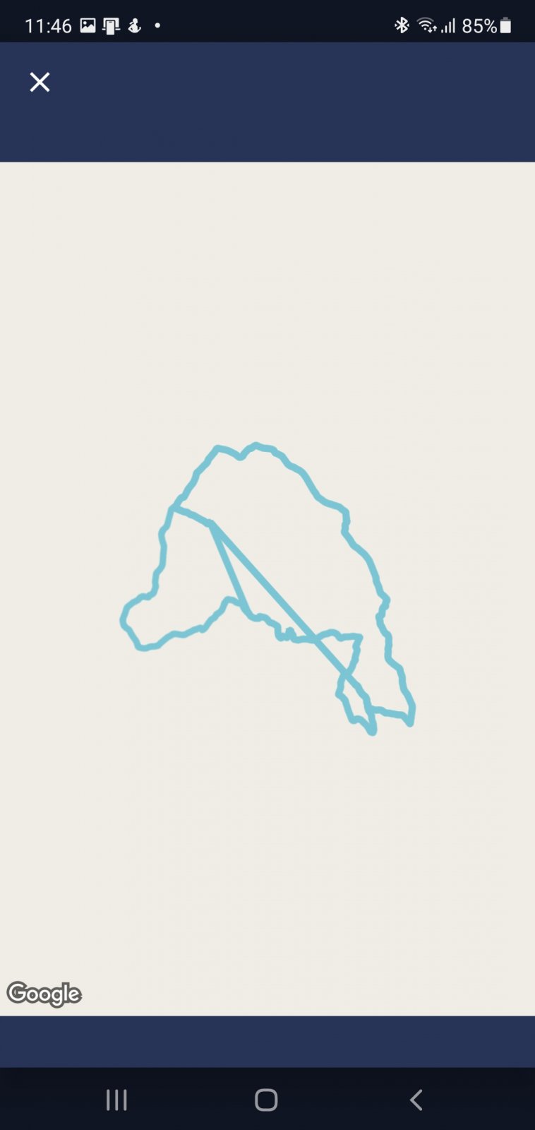

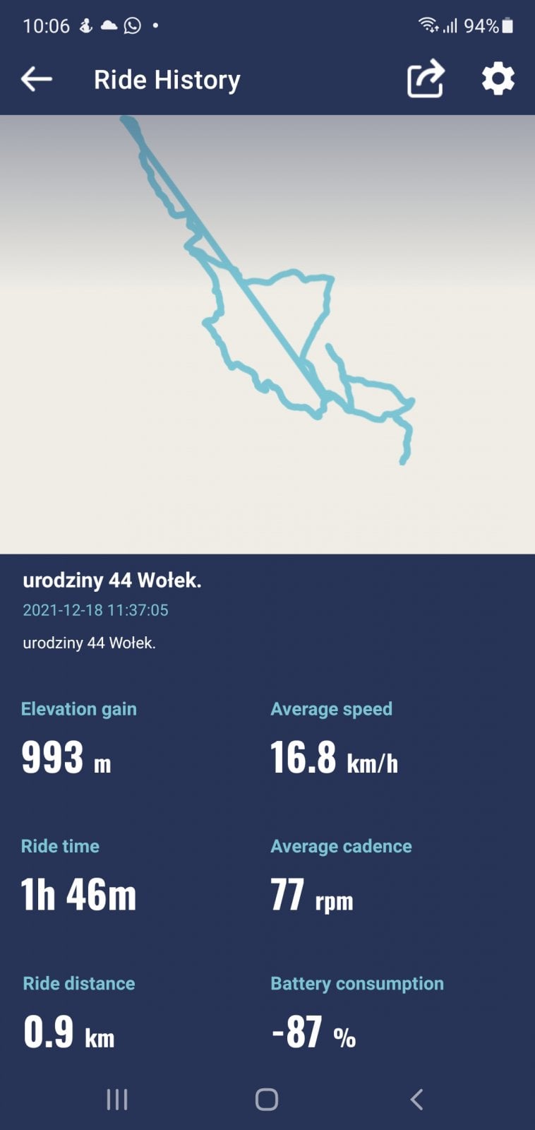

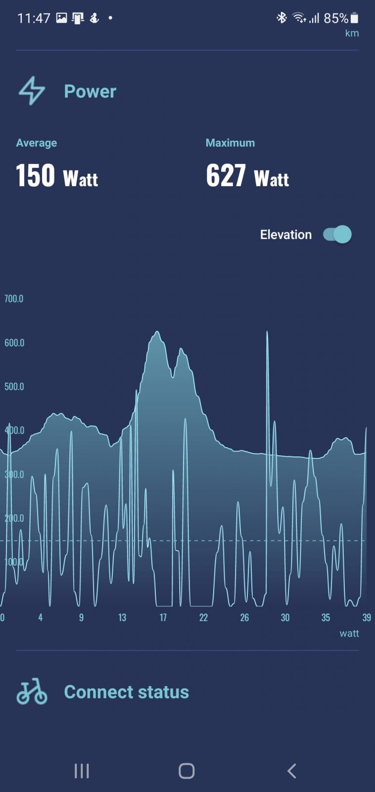

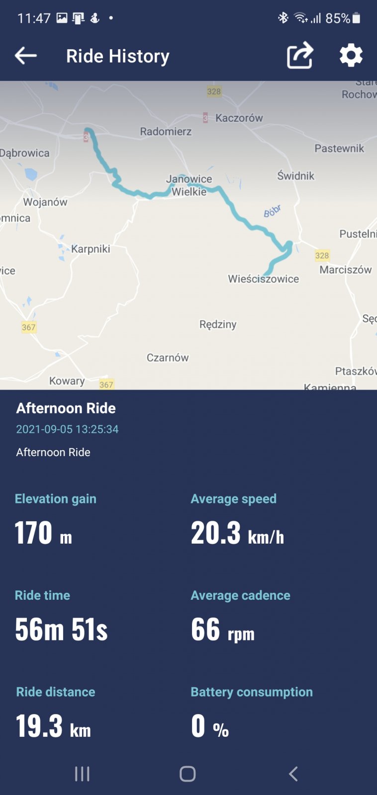

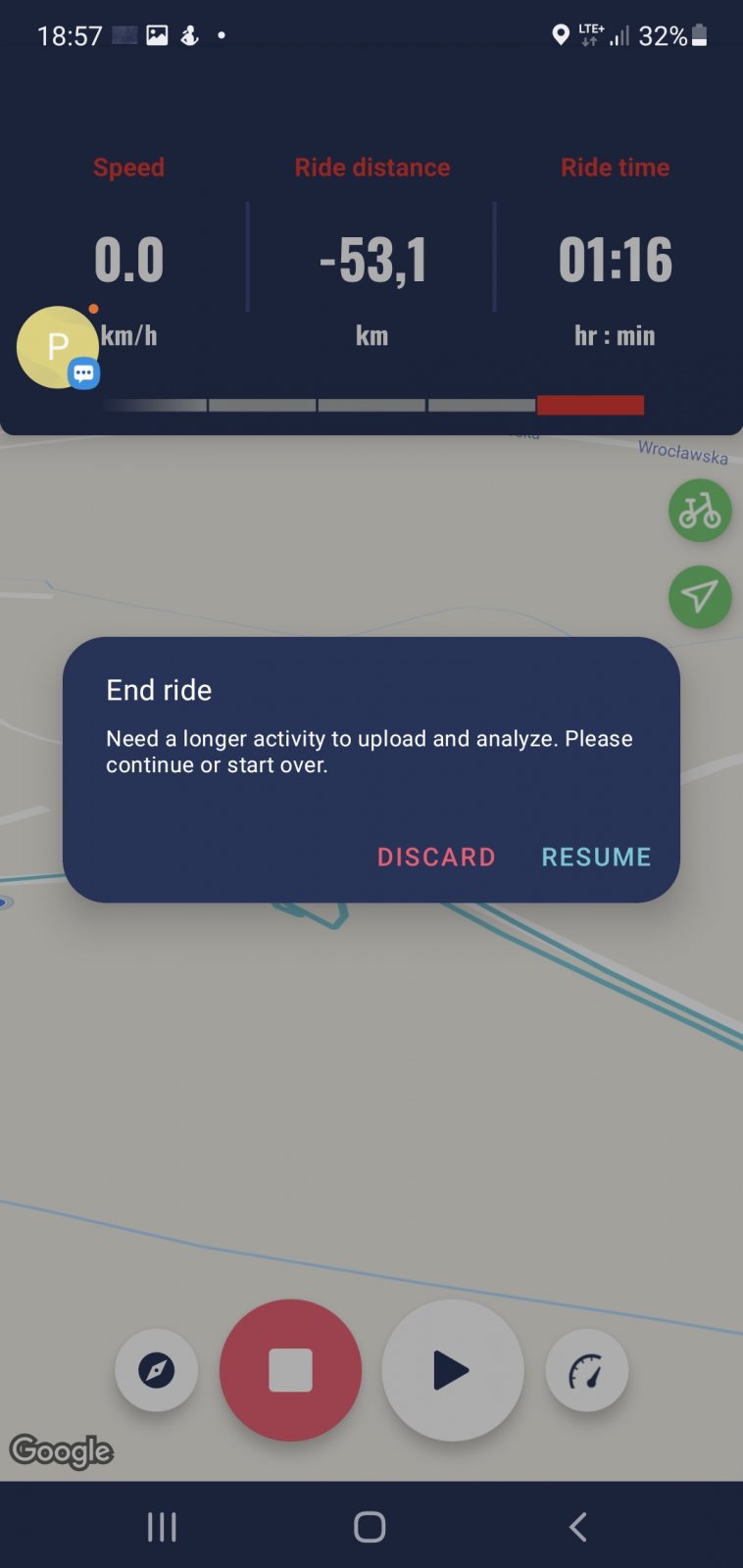

Dear forum users. I write this email to GIANT, and You know what happen? NOTHING. We count on You Rob! You are only hope! Sorry for English, it;s not my native language!
First of all, when You are familiar with Garmin and Bosh e-bike system... this app is useless(or you can't use it because poor functionality). I use android version on Samsung Galaxy Note 10+; I try to add some things later;
inside mail:
1. The application does not allow you to save tours. After the some update - she wrote. So I think that it was OK. However, this function runs randomly once you can write it once not! I have no idea what it depends on. I attach the error.
2. If he is already saving, the route is drawn in the application, but it has no points and no locations. It is a white card with blue lines. I am attaching a screenshot. All in all, the whole thing is useless in this form.
3. On the record, at the first summary, there is, for example, information on how many batteries are "used" - then when browsing the history - this information is no longer there.
4. Setting the ridedash EVO - on the previous version of the application after pressing the field to display configuration (configurable fields at the bottom) - I did not see what you can give ... because the application "crashed" after pressing. After the update - it works and, surprisingly, there is a watch! It can be set which is a nice feature. There is also POWER - but I have not found anywhere in the manual - what power is it - the bike or mine ... do you know? Same on the summary chart, I don't know as to power - bike or mine? what helps me is what i give
5. I understand that ridedash evo has no memory whatsoever - time disappears immediately after disconnecting the phone. So it is only a display, without GPSs etc. I did not know that before I bought it. And I was counting on a continuous improvement in functionality. ie, I go without a phone and then synchronize, but it probably won't be possible to do it. - point 5 ignore it.
6. Navigation on EVO. It also works randomly. Because I was able to turn on and drive somewhere - it worked. (On the second day it does not work anymore - nothing is shown on the evo screen, but there is navigation on the phone) However, after a few hours of driving, you cannot "attach" navigation to what we have already traveled. You have to save it and restart it, which results in several entries from a given day. Ideally, it would be compiled into one entry of the day - for example, Bosch does. Such gluing of traces on the map and a summary.
7. is there any help/instruction in app(point 4)?
2021-09-09 18.57.38.jpg 2021-09-20 11.46.43.jpg 2021-09-20 11.46.48.jpg 2021-09-20 11.47.06.jpg 2021-09-20 11.47.19.jpg 2022-01-05 10.06.14.jpg
I will be grateful for your help and acceptance of my comments in improving the application.

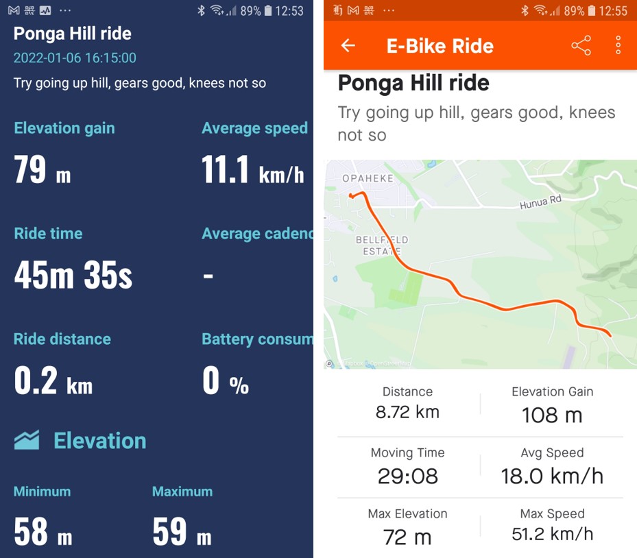

Wow, seems there are lots of unhappy app users out there. I have just purchased a pre loved 2019 Giant Fathom E3+ and downloaded their app - primarily as there is no bike mounted display. I am using a Samsung Galaxy and the bike firmware updated itself when I recently connected so using current firmware - although saw some posts about the update bricking the bike which is a bit scarey esp as I am well out of warranty.
Anyway all appears good but when I looked at the info after my first ride, there is clearly something wrong with the data. Also uploaded to Strava out of the Ride Control app and as shown in the pics below, the data does not match. I have only done this ride once and am sure data has the same source but nothing matches - except title and time.
I note that there is no cadence info - I checked on various web sites but it is not clear if the bike comes with this as standard or is this an upgrade - not even sure that this info is even very useful for me but appreciate feedback on this one.
I am interested in adding a small display to the bike so a I see distance travelled and, I like the look of the Ride Dash Evo but not sure if it is compatible with my 2019 model - I am not sure how to tell if my RideOne controller includes ANT+ - I suspect not as there is info on the Giant site that this came in with their 2020 model. The last pic shows details from the bike incl RideControl Device Type as One and Hardware version as 2018030.
Greatly appreciate any feedback from other EMTB experts but in the meantime getting ready for another ride :)
Cheers
Mike
i think the only bike data of use is the battery value. Best getting a low end Garmin or wahoo that can be moved from bike to bike. That’s what I use. I’m assuming your bike supports ANT+ Garmin communication. No point in displaying the bogus data sent from the bike.

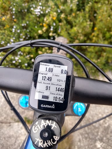

I never even open the app now, no need for it, I got a Garmim Edge 130 plus, the cheapest one with ANT+ and it shows all I need with instant startup. I recommend this to everyone.
You can show more or less fields.
Garmin records your ride FAR better in every detail too. I used to feel a bit annoyed about my bike before this, but now never even think about the app. It's replaced as far as I'm concerned.
App field is Ebike Field
