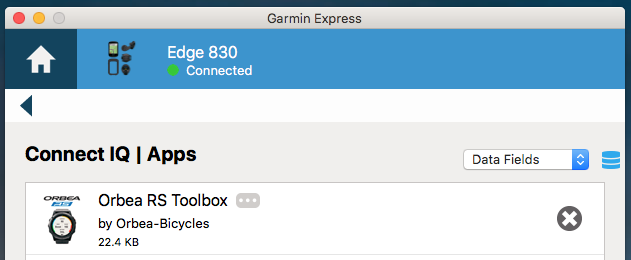

Just updated my Garmin 830 to the latest maps and firmware and there is a new 'tile' option in the Garmin Garmin Express App in addition to the usual 'Tools & Content' and 'Garmin Connect' ones.
The new tile is called 'IQ Apps', this then shows you all the IQ items on your device and if you select the 3 dots beside the Orbea RS Toolbox item you get the following. You can then swap the fields around :)

Sixth is what i'm looking for... I suppose it's not there yet, right? Will it ever be?
Probably not and that's why I uninstalled the RS Tool box and went with all my own data fields. This way you can add mileage, ascent, gears, HR and still show battery% and cadence. It no longer displays off, Eco, trail, boost, but shows 0,1,2,3 instead. To do this, you go to sensors and add Ebike while your bike is powered on and it will automatically add your bike as a sensor like it does the HR monitor, speed sensor, ect. You can always reinstall the RS Toolbox if you don't like this option.
